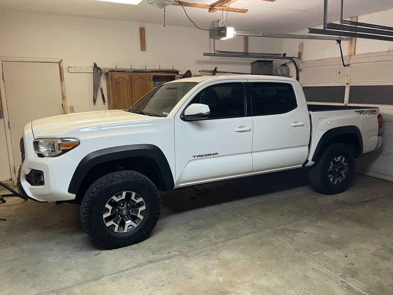

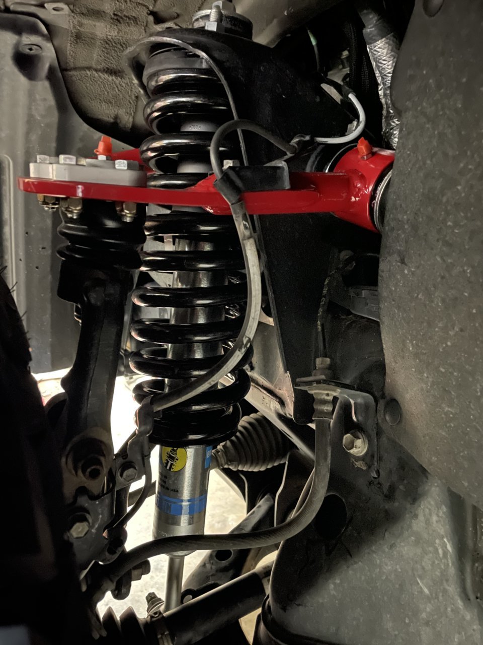

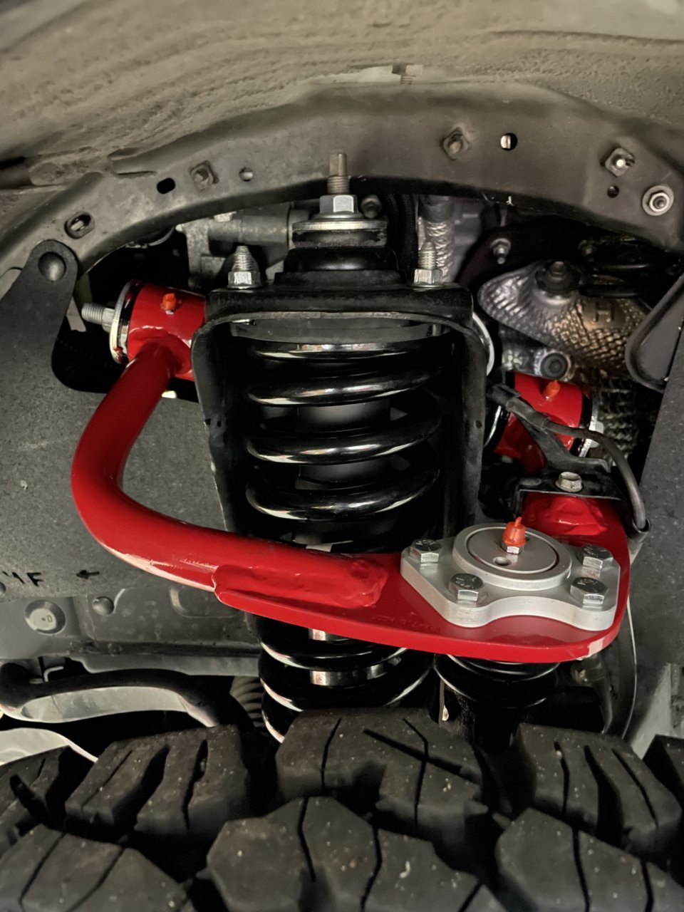

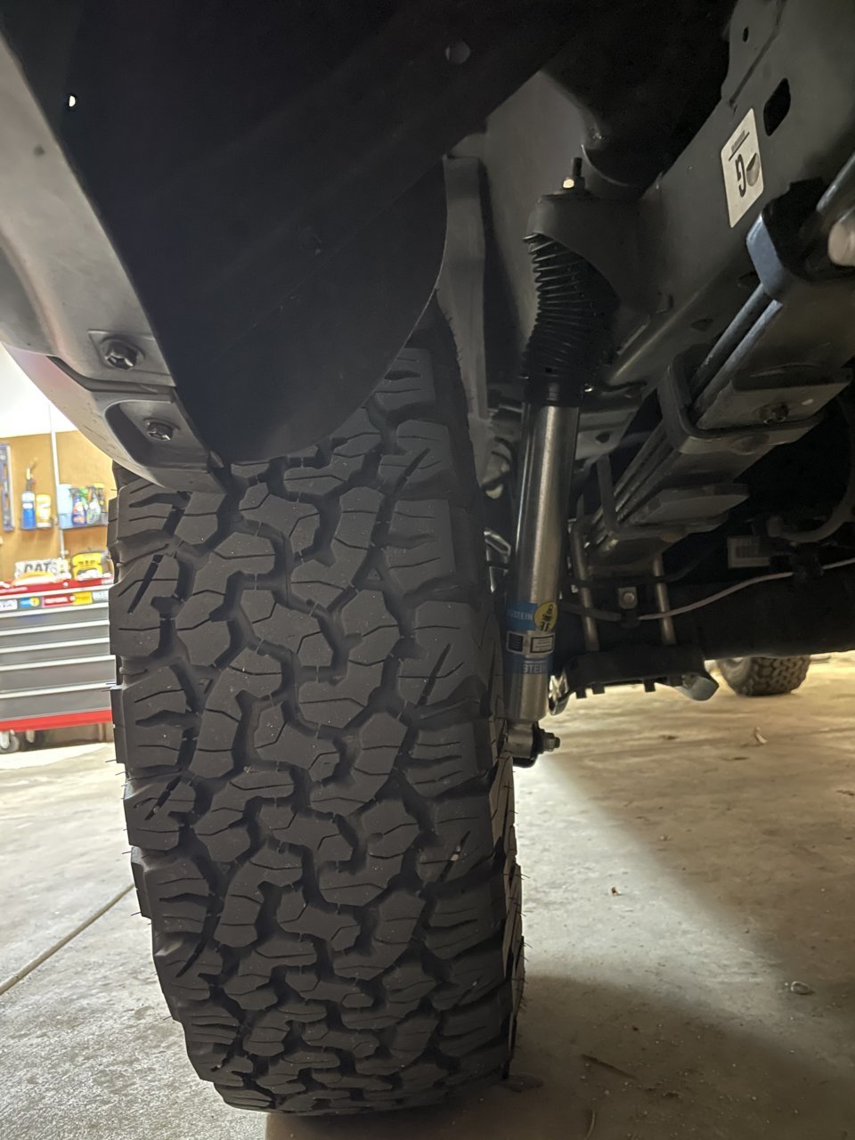

    After buying my 2019 Tacoma I thought I would just spend the least amount of money and put on some rough country 2” spacers. After 2500 miles I realized I had made a big mistake. Although even with installation I was only in the hole $500 I should have done it right the first time. I was getting a bad vibration around 30-40 mph which conveniently is the speed around the city on every damn road. The suspension geometry was terrible. The tires were toed in and hitting potholes, speed bumps, or turning into steep drives was dangerous. I just got a new suspension installed this weekend and couldn’t be more pleased. Feels like a capable truck should ride. It’s firm yet rides very well. You feel in control of the vehicle. Went with JBA uca‘s. Bilstein 5100s set at zero. OME 885 coils. And I also replaced the needle bearing with the east coast gear supply bushing. Cost me a lot more than the rough country lift but man it rides great now. Zero vibration. Very nice ride in town and on highway.

    Hard to say what made my ride so much better since I did it all together. You will be happy with the 884’a hopefully mine settles just a touch because I’m sitting just about 1/4 higher in the front with the 885s.

    Its that sweet spot of not needing uca, although you have them, the chart is showing 3" with the 885's for yours.
    I just cant wait to get the geometry cleared up nice to hear that was the issue for you. Strut assemblies are often 300 each so this upgrade isnt that bad. Mines an RC so a little unclear as to how it will settle. Its really not fair you post pics like that, no rust, clean undercarriage. LT's arnt to hard of a ride?
