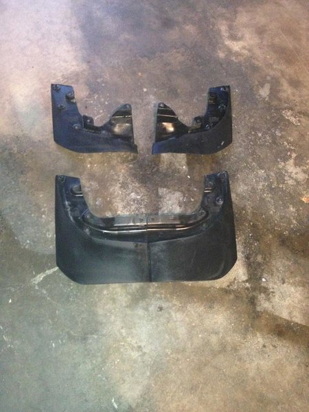

    For those of us who want to retain mud flaps but want to be able to do some light off roading, I decided to write a how to. I was going to take mine of completely. The stock mud flaps hang way too low to do any sort of off road driving. Hope this helps....

    Step 1
    Clean back side of mud flaps (helps tape stick better)

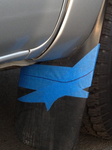

    Step 2
    Apply tape to back side of front mud flap and draw pattern with pen. This will be up to you.

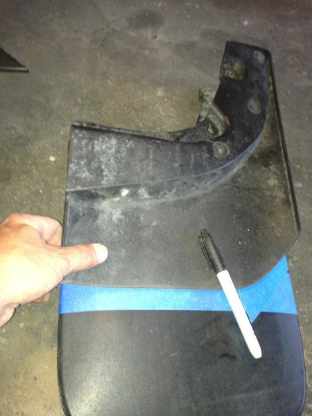

    Step 3

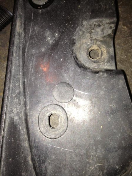

    Use 10mm socket and remove three screws. There will be three rivets that will need to be popped out. Use a small pry bar or flat head screw driver and pop rivets out. If the heads pop off save them (explain later)
    Step 4
    Use your cutting tool (Dremel, jig saw, hack saw, etc.) and cut your pattern.

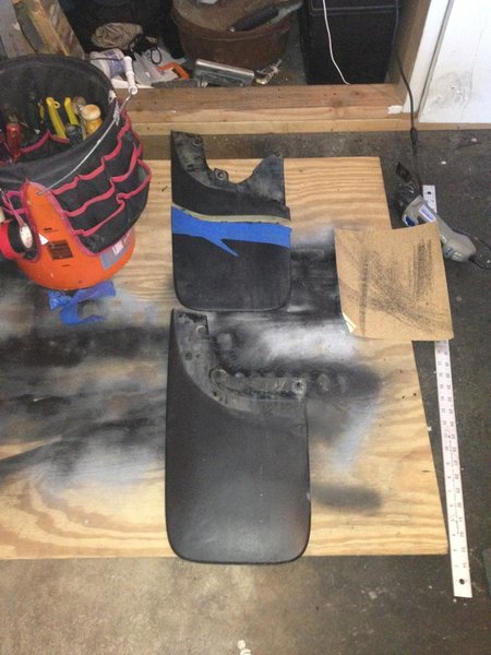

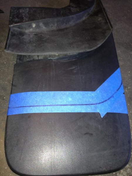

    Step 5
    Use your cut front flap and trace pattern on your rear flap. I lowered my front flap down 3 inches. I wanted the rears to be longer than the fronts. Again this is up to you.

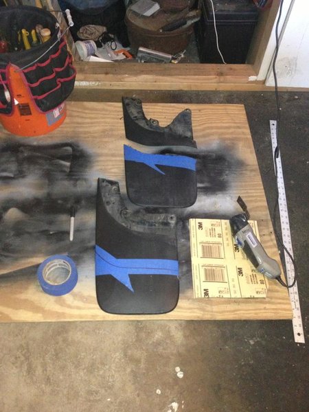

    Step 6
    Flip your cut flaps over and use them for the other uncut flaps

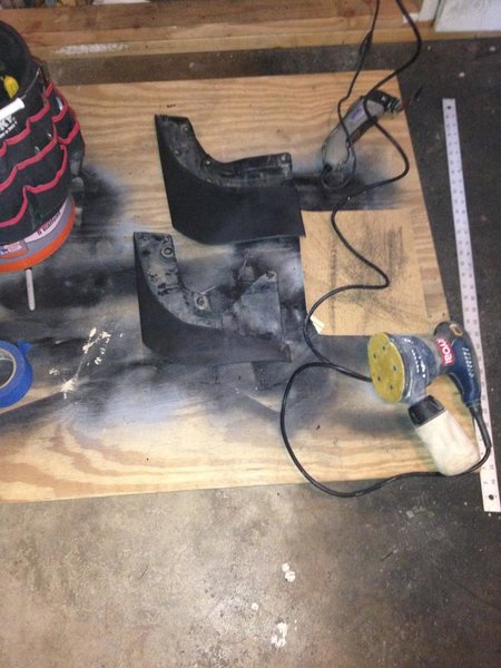

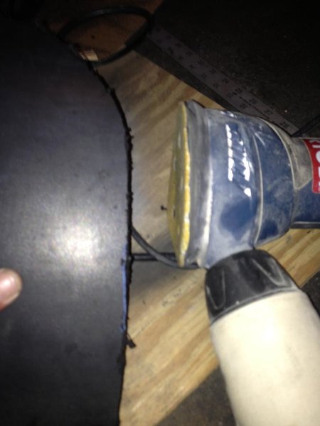

    Step 7
    Sand and shape using your sander (80 grit works best)

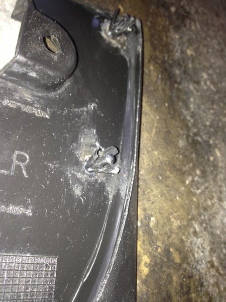

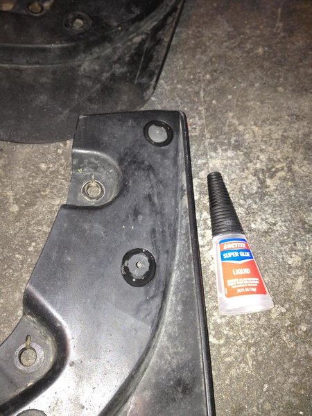

    Step 8 Optional
    Remember the rivets? I was able to pop most rivets but some of the rivet heads did come off. I did not want open holes so I super glued all the rivets and heads
    Step 9 Optional
    If you did step 8 you will have to cut off the three tabs on the rivets or you cannot put the flaps back on.
    Step 10
    Put cut flaps back on truck.

    Before I took my mud flaps off I read several posts where people were struggling to get the rivets out without damaging paint or the rivets themselves. I ended up using a pair of wire cutters and was able to get the rivets out with no damage to paint or the rivets. Basically you use the cutters like you are trying to cut the heads off the rivets (don't squeeze hard enough to cut the rivets). The cutters are angled and lift the rivets out while squeezing the part that spreads apart. Hopefully this helps someone (not sure if this method has been posted before). The cutters I used look like this.
