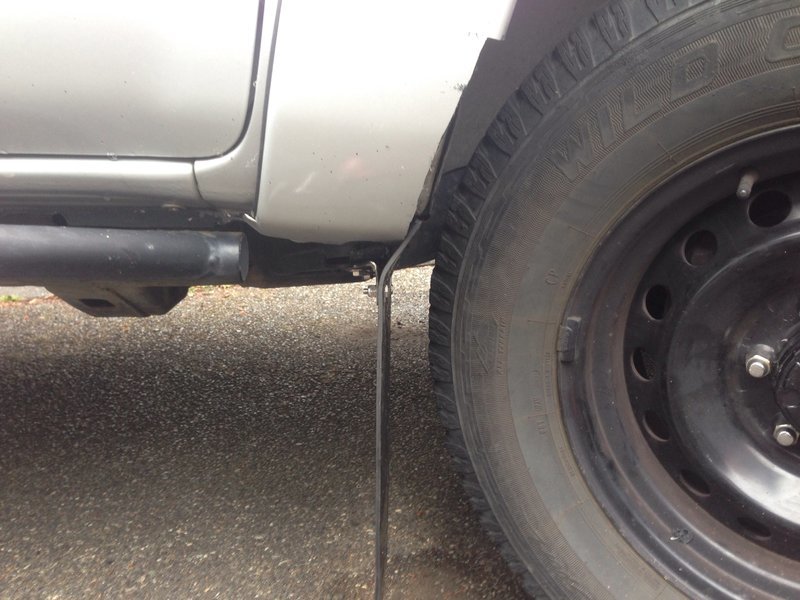

    So I wanted to mount the flaps essentially flush with the cab mount chop but not add any thickness on top of it. So I decided to use some L channel strapping from ace hardware (for hanging garage openers) to attach beneath the cab mount. I ended up oickinrbg up the two existing drain holes but then I added an extra drain hole since I filled the OEM one with a bolt.
    Went together pretty quick all in all took about 4 hours for measuring, trimming, painting and Install. I also trimmed the flare where it extended past the cab mount chop plate so as to keep the plate as the closest point of contact.

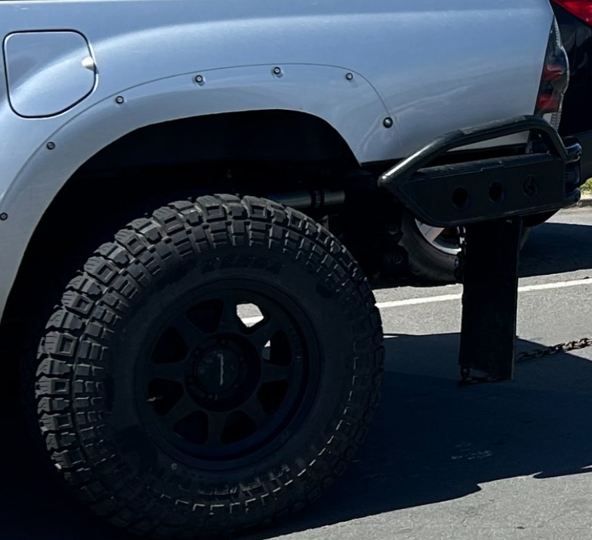

    found this searching for way to put front mud flaps
    and rear
    anyone figure out a better way?
    Truck has HC bumper, CMR, no liners etc
    The common stuff…
    and doesn’t seem any real way to mount mud flaps besides something like welding on a holder bracket
    the flaps seem easy, NAPA has HD big flaps $12/2

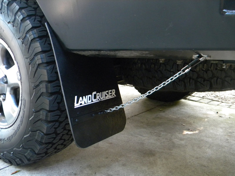

    Furthermore it’s recommended to chain the back up somehow at an angle so it kicks rocks down not up

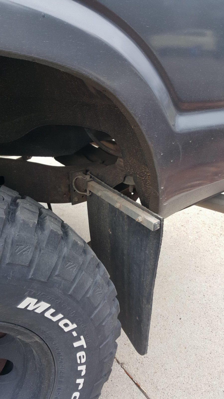

    Been running HD flaps clamped to Warfab HC tube but it’s kinda too far back and thin
    gonna stare under the truck again more see if I can figure out a way that doesn’t involve drilling into cab mount - which at this point wouldn’t even be possible with CMR
    here is last set up on rear as you can see doesn’t really look ideal
    Excessively far back and narrow matching the bumper line where it tapers in going back
    can always “revise” above setup to protrude out past bumper to cover tire more
    and just hope that it doesn’t rip dragging off road etc
    should be spots to secure a chain
