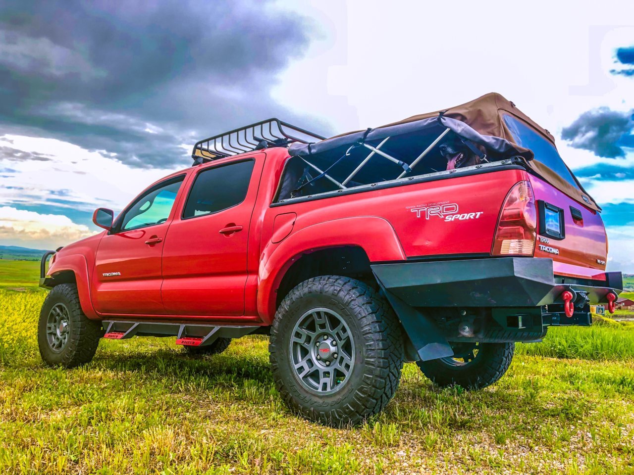

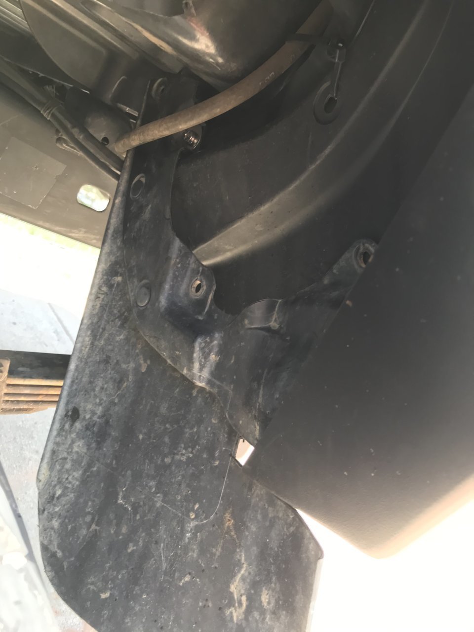

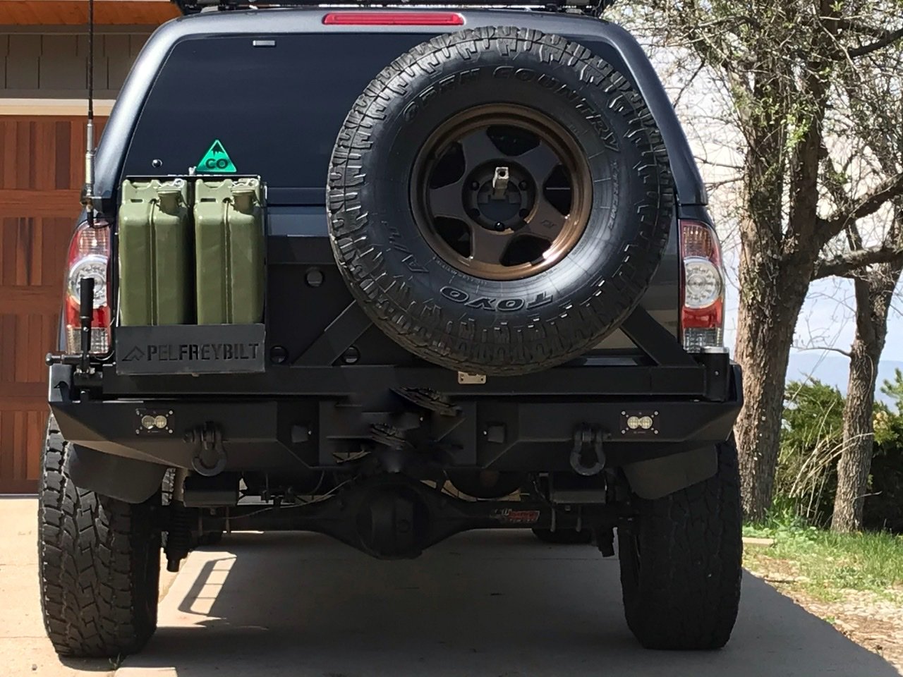

    8A97AFF2-F123-4F62-BA40-6BEC41F65EF5.jpg 00C14A6E-6127-4C94-A192-B581DEDD9B97.jpg Have any of you added up flaps on your high clearance bumpers? I have an air compressor in the bed cubby and the wheels were dumping all sort of debris into that area. So I used the old stock flaps and bolted them up in there. Ain’t real pretty but they have survived a few deep mud trail runs and seem to keep the rock collecting that my bumper used to do down to a minimum. What have others done to tame your rear wheel wells?8A97AFF2-F123-4F62-BA40-6BEC41F65EF5.jpg

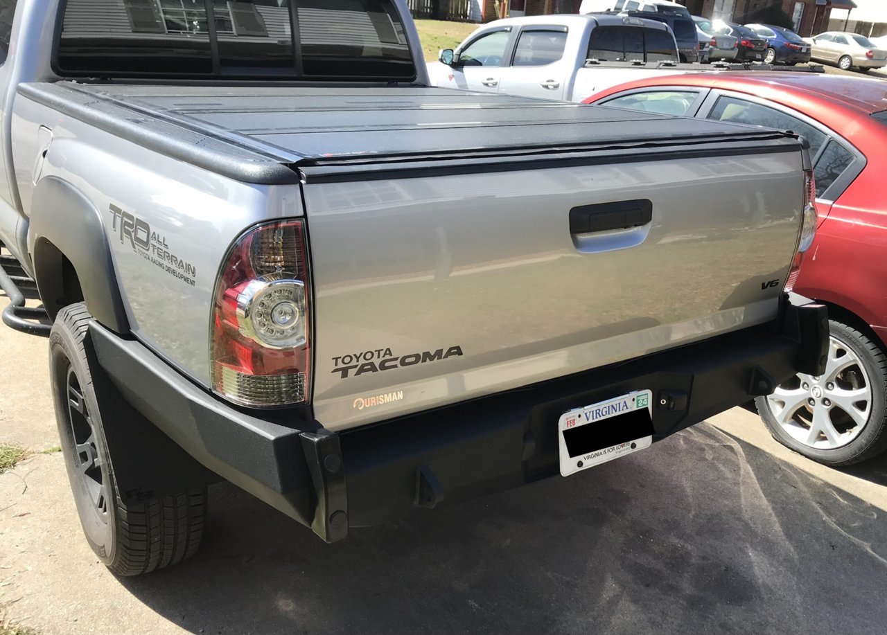

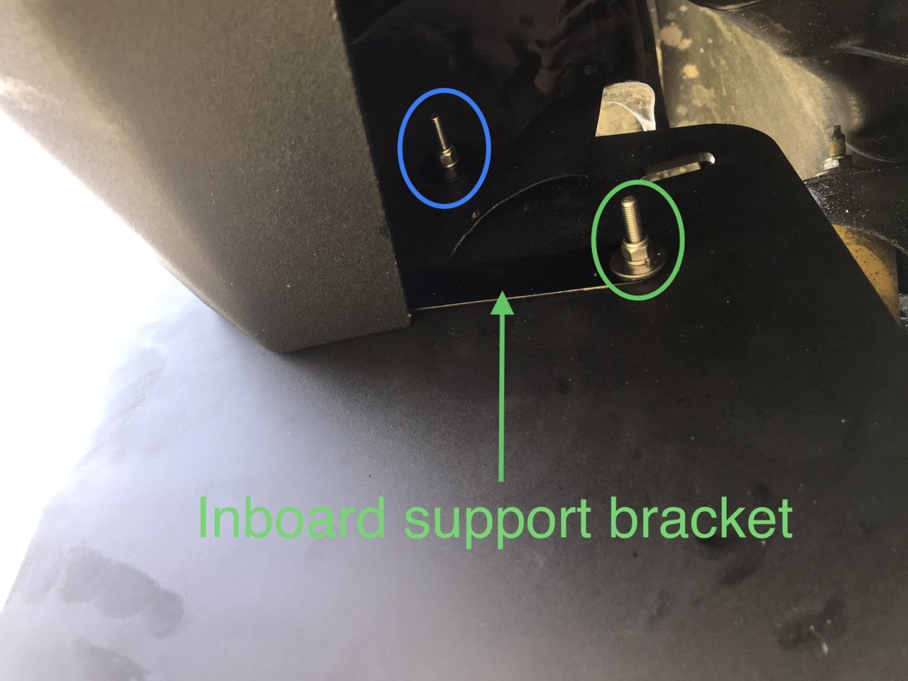

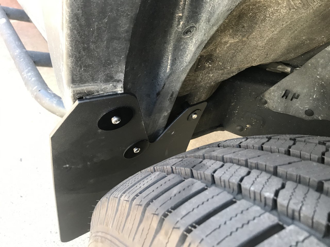

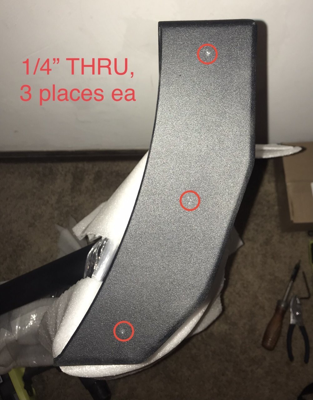

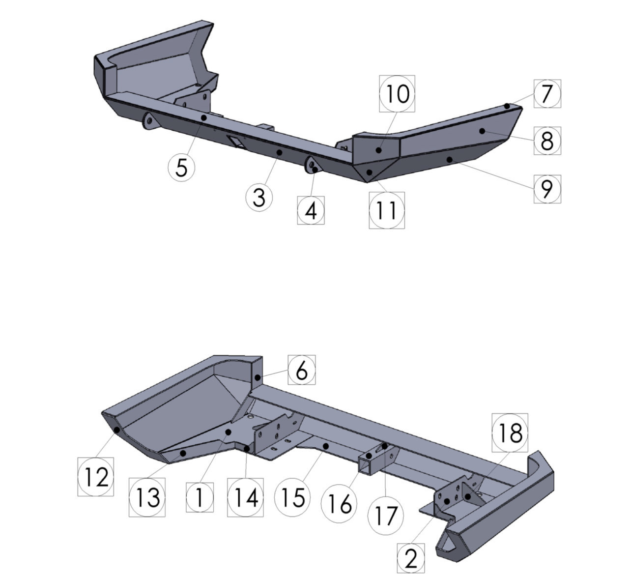

    This drawing from @coastaloffroad shows the detail best—I just leveled the truck, placed the mud flaps (level) and match-drilled holes on the surface marked “12”.
    I did use nutserts on the bumper for ease of installation—it really closes off that front edge (one reason I wanted mud flaps—I have a compressor and tank in that area). Another reason—I pull a toy hauler with my truck.

    Another view.

    Awesome, thanks for the detailed shot! I'm hoping I can do something similar with @Mobtown Offroad's HC rear bumper. I'll have a bedside mounted single compressor as well.

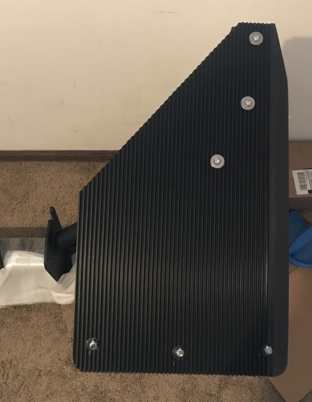

    Bit of a necropost, but I finally got this mod done.
    The universal mud flaps mentioned above didn't work for my front wheels, so I replaced them with a full RokBlokz setup.

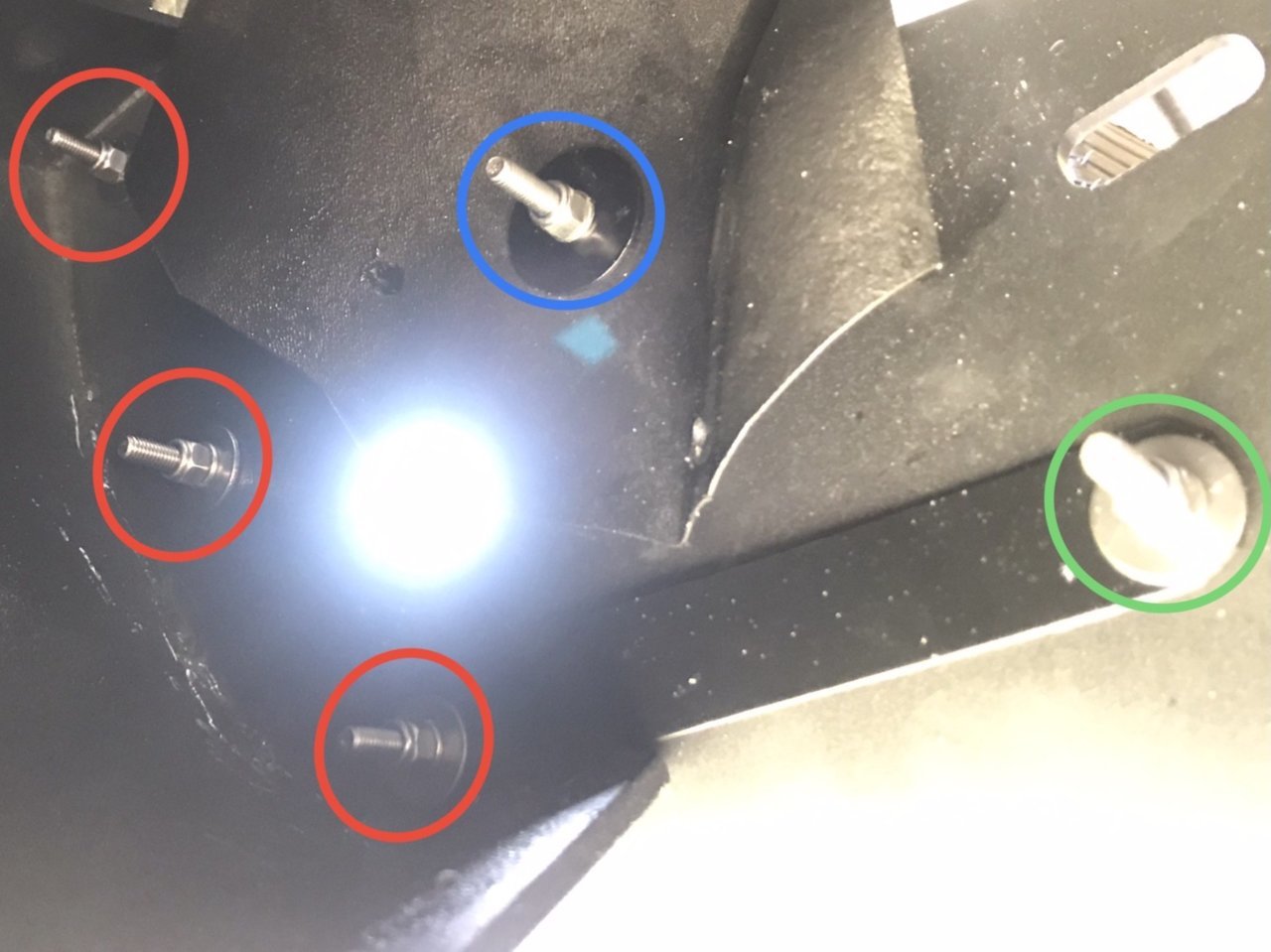

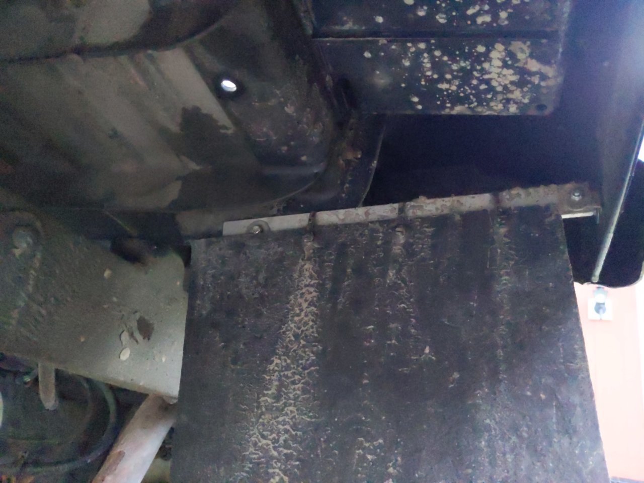

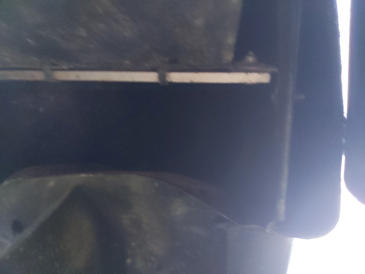

    That's what I did with my Phantom HC. 1.5" x 0.5" aluminum bar drilled and bolted to a bed rib, and a stainless angle bracket drilled and bolted under the Bushwhacker. It would fit under stock trim too.
    The flaps are ziptied to the bar so they'll break away. I got some big rubber universal truck flaps large enough to cover the full track of the tores about 1/3 of the way down, really tames mud/spray/rocks. Haven't hung them up yet.
