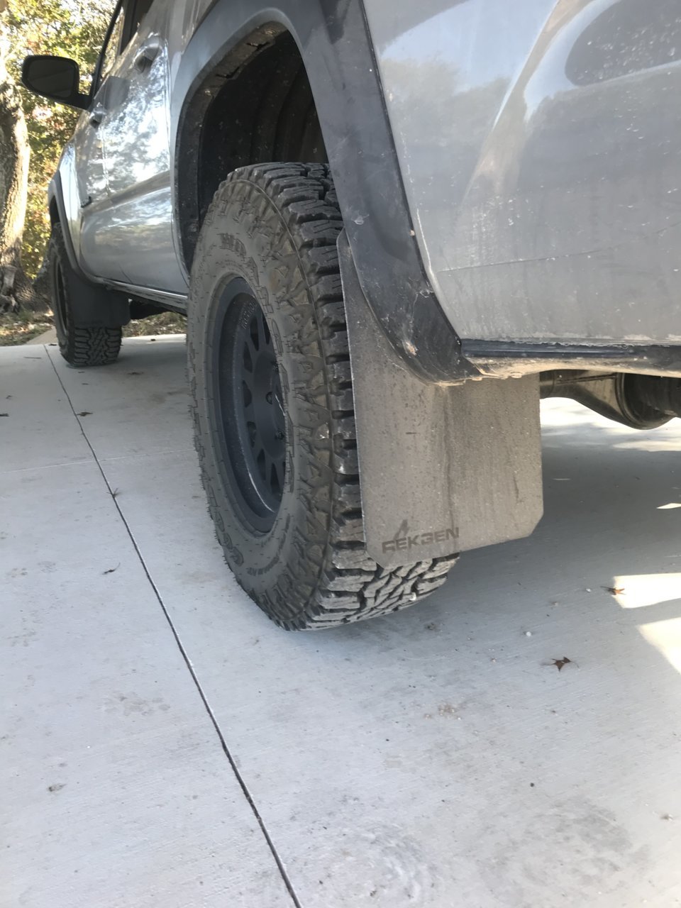

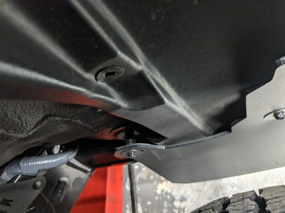

    I have Rek Gens and Im not super impressed. I mean, the spacers are just pieces of fuel line... And becaue how they don't really suck up tight against the fender, I do get tire rub on the fenders in reverse, full-lock, in a bump. So, they are okay, but not sure they were worth the $100 price point.

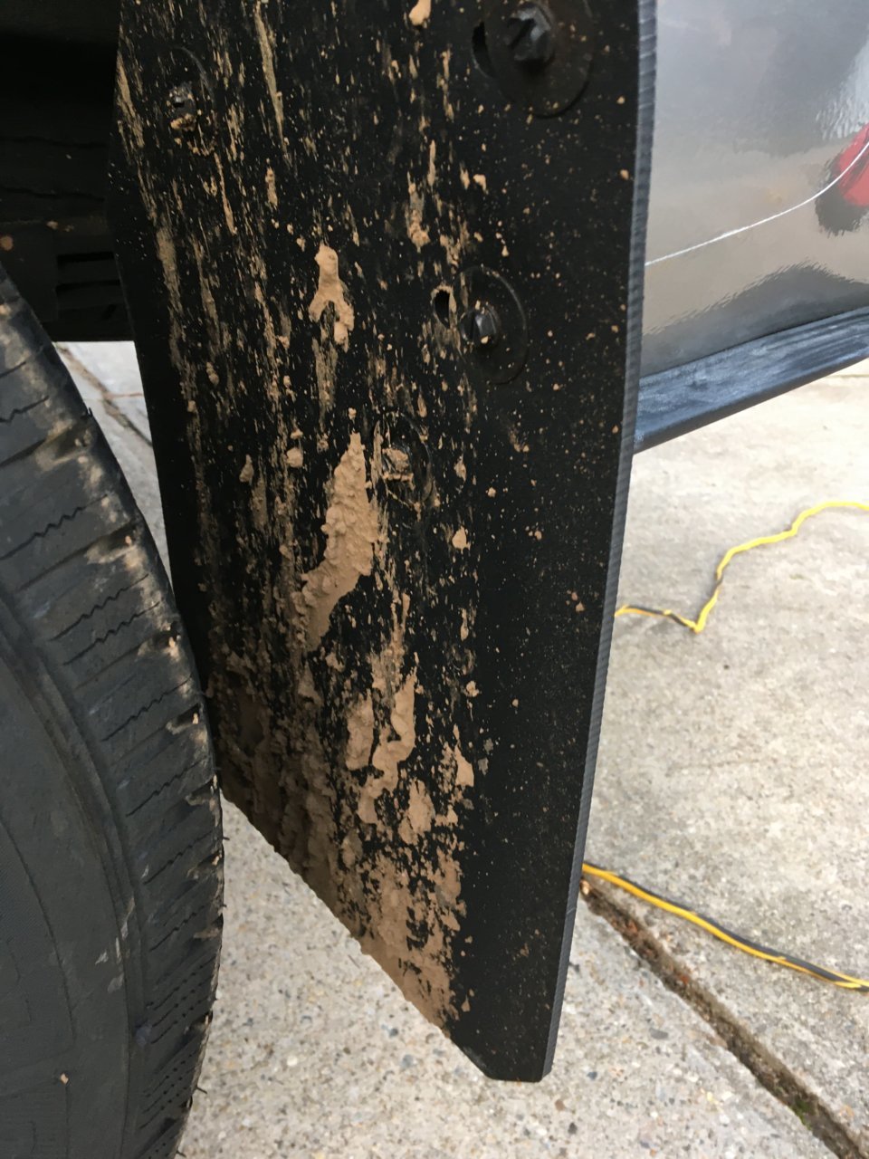

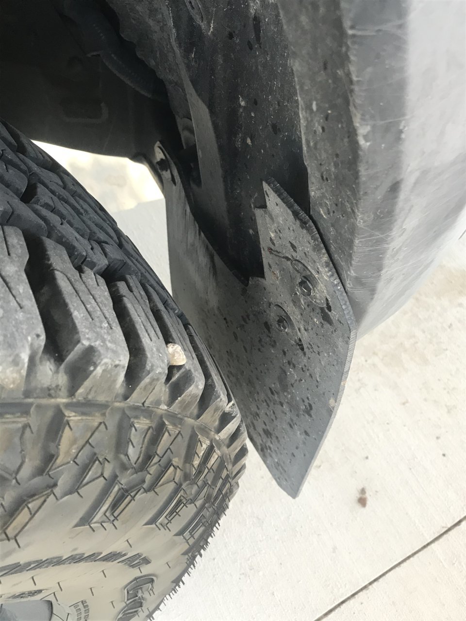

    hey here you go. They flex but to be quite honest I’m still getting rocks/gravel pinging the truck. Better than nothing though.
    edit: I’ve got rubbing on the driver side so I need to trim the little tubes they give you.

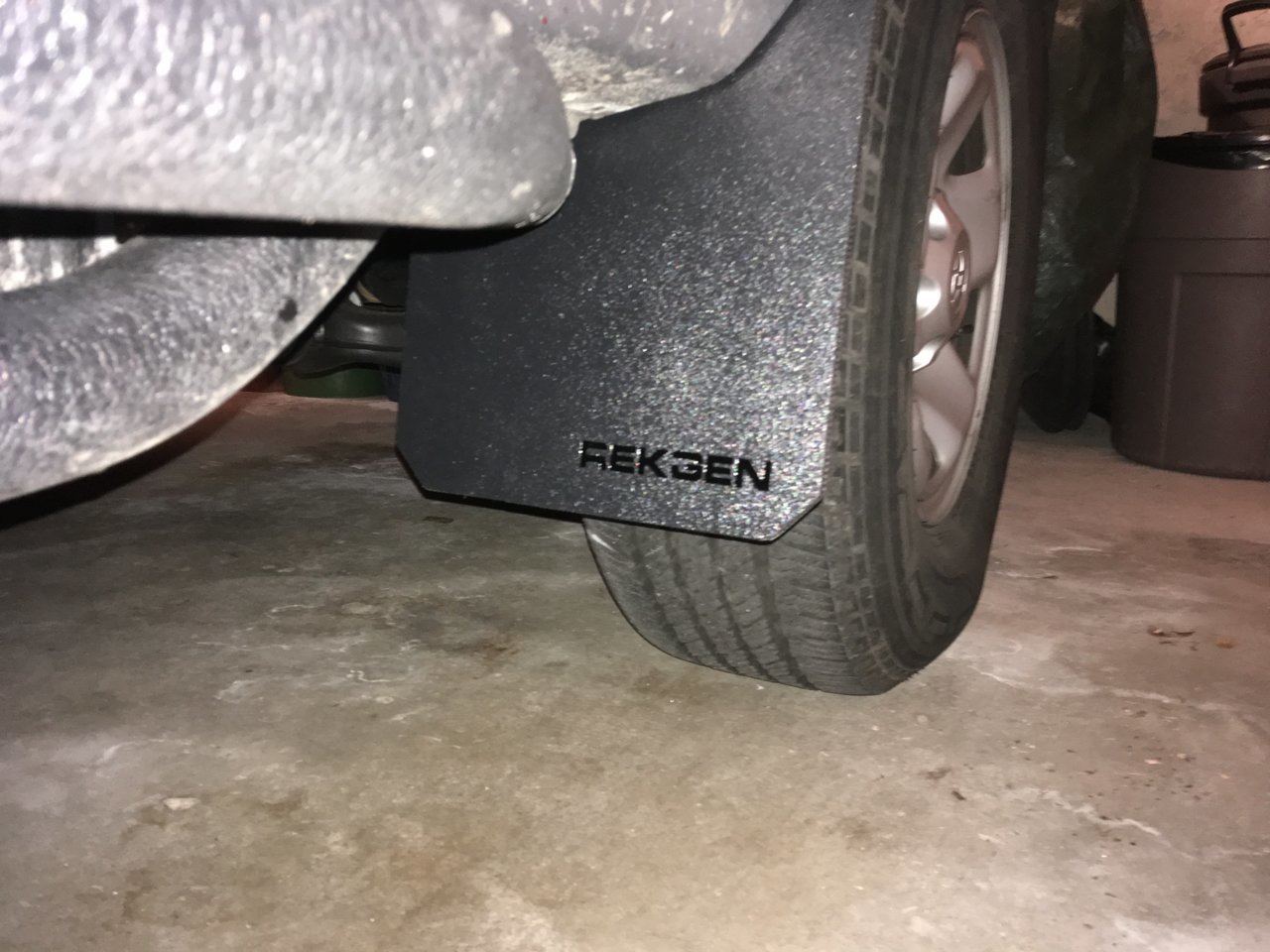

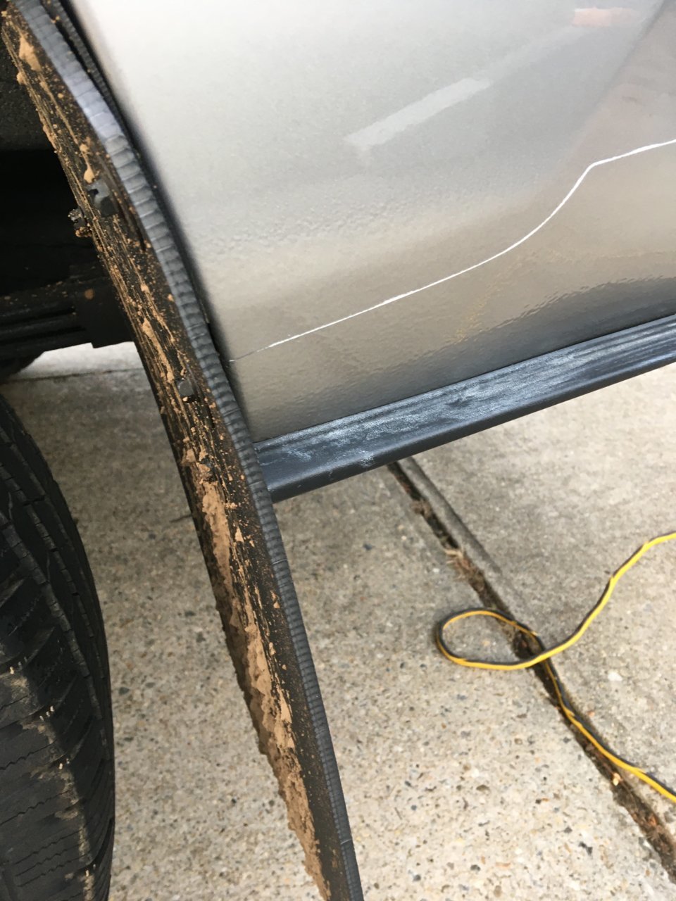

    Mud flaps live up to their name on wet, gravel roads. Get the mud on your flaps and off your truck.
    RekGens

    are these standard or the XL? any more pics? trying to figure how far out from the panel/flare, they sit. thank you! Ski

    Standard size. The fastening points on the
    flaps are slotted, so there is some flexibility in the mounting position 8AA3494D-DEAA-41CA-91E1-B4DA7480F35A.jpg

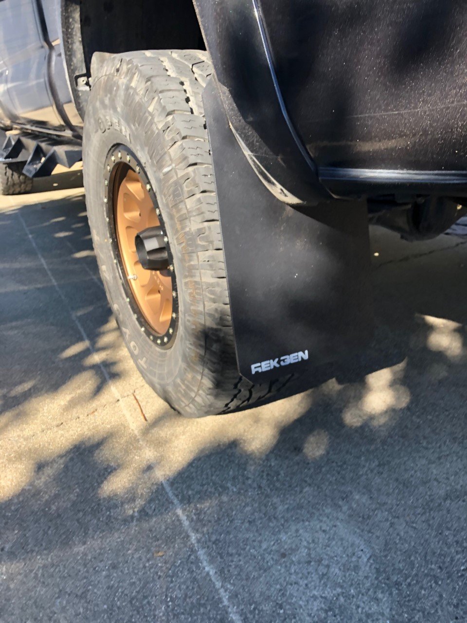

    Went with the Rek Gen's. Running 285's and get the occasional rub. Clearance is mighty tight.

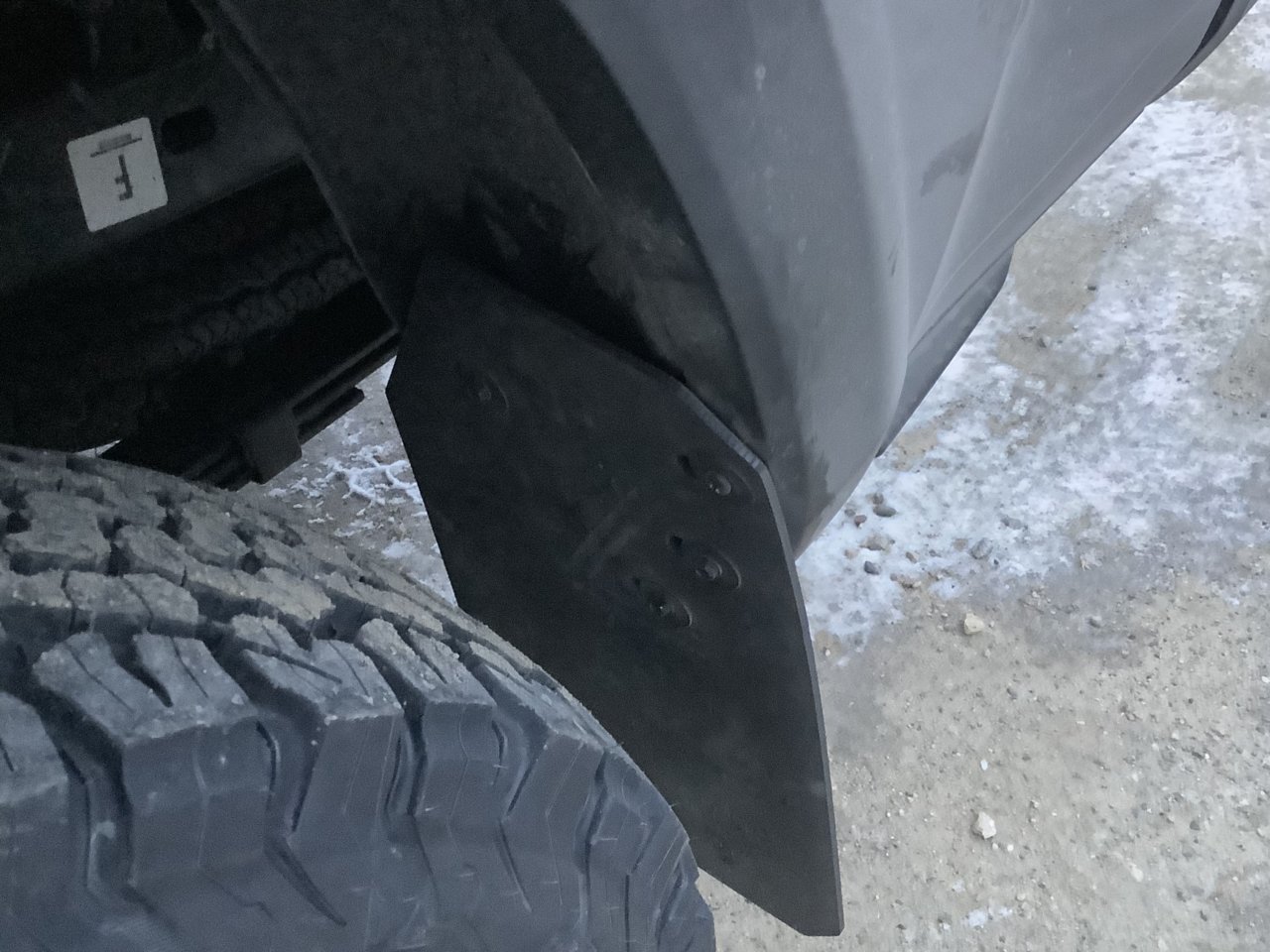

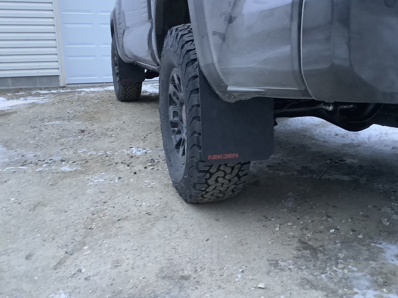

    Put some rekgens on today
  18. Dec 12, 2020 at 2:40 PM
    #118
    lonedrake
    lonedrake Well-Known Member
    Nov 24, 2020
    #347717
    78
    Minnesota
    Seems like a fair amount of space in there to hold mud snow and cause rustBBFF0DE0-9218-478D-B46C-5AC67FB94310.jpg
  19. Dec 12, 2020 at 2:42 PM
    #119
    lonedrake
    Nov 24, 2020
    #347717
    78
    Minnesota
    One thing that was odd was that the instructions said to use the short spacer on the front and the long on the rear. But,The gap was big on the front and smaller on the back so I reversed them. Fit much better.
