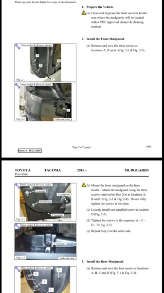

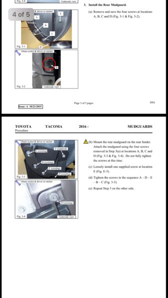

    Do any screws go in the tab on the bottom of the rear flaps, or just in the blank at each wheel?
