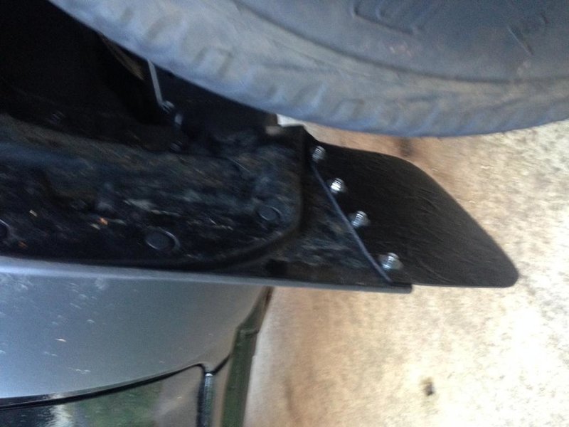

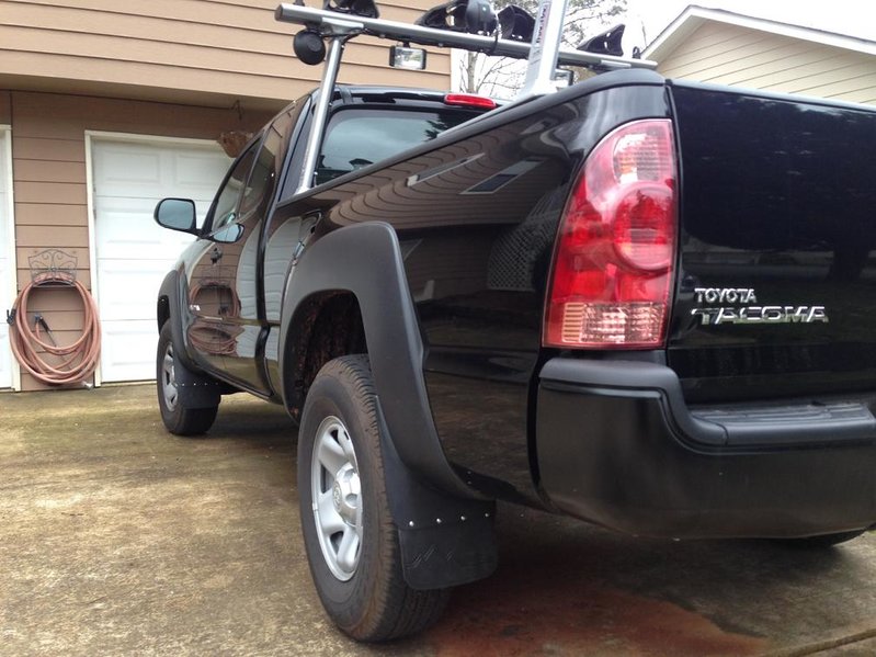

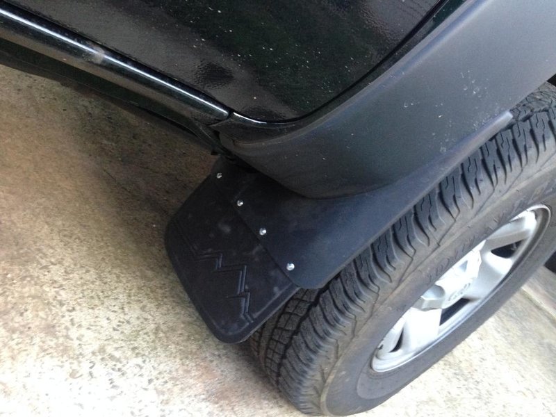

    Ok, after reading a gazillion messages and seeing a gazillion pics of trimming, removing, and modifing mud flaps I came up with a solution which I think is the best of both worlds. I trimmed approximatly 10 inches off the front factory mud flaps (14 inches up from ground) and added 5 inches of rubber Plasticolor ($15 from advanced auto parts) to the trimmed factory mud guards. I utilized ss #8 (1/8) pan head screws with 1/8 X 3/4 ss washers and #8 nylon locking nuts to attach trimmed Plasticolor mud flap. The total dimensions of the mudflap is 4.5 inches shorter than the origional mud flap and the lower 5 inches of the flap is flexible rubber. Excuse any blurriness. I combined Cold Iron's Idea in post #661. I meerly used the factory flaps and different hardware to attach Plasticolor flaps.

    The main problem with mudflaps is that when you back up the truck, it gets pinched with the tire and for example the curb or pothole, that's how I ripped mine off..............
    Either way your setup looks really good IMO

    This is just my opinion but that looks horrible...I'm sorry..

    I'm not a fan... there have been worse ideas on here.

    Agreed, but that dosen't normally occur except when backing up..... agreed
