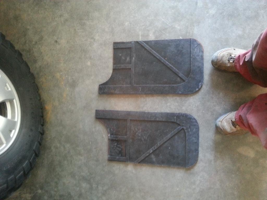

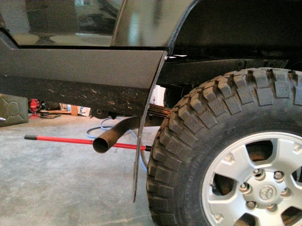

    HC Rear. Cutout of one giant flap for a semi. Secured with a bunch of 1/4 stainless. Works very well, beefy as hell and very flexible.

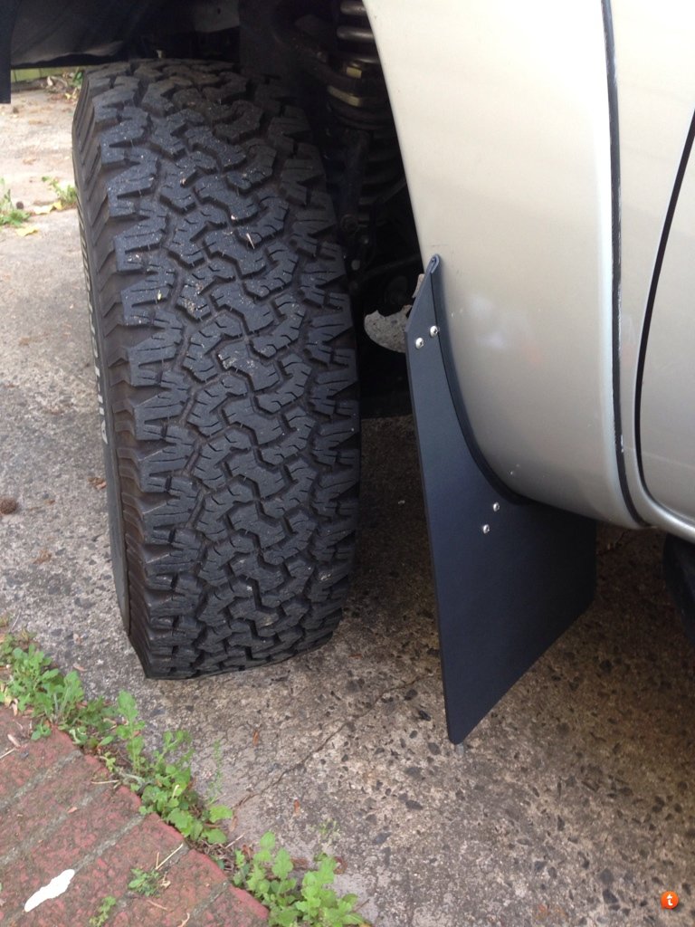

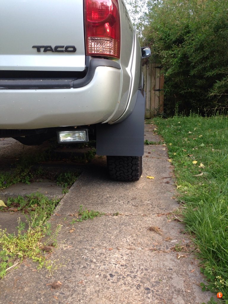

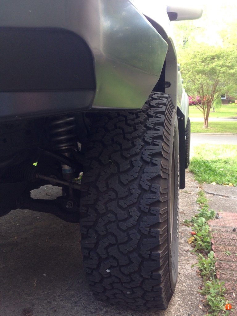

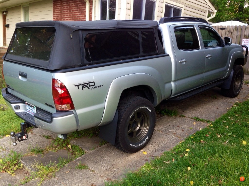

    I got my rokblokz oversized tire mud flap kit today. For a long time I have been running my cut-up flaps, with 275/70r17 tires on 4.1" b.s. wheels. Finally, no more scraping and full protection.

    did the brackets come painted black? Mine came silver.

    No, I painted mine black.

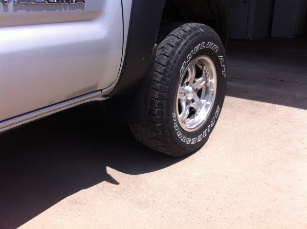

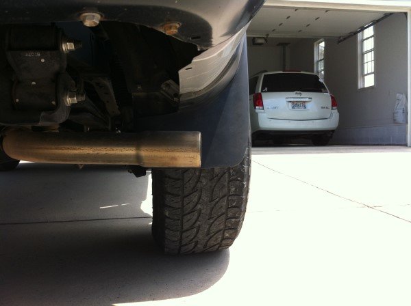

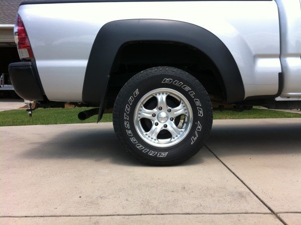

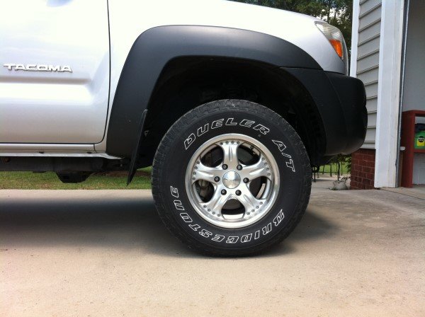

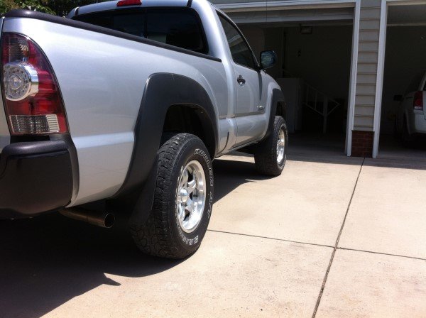

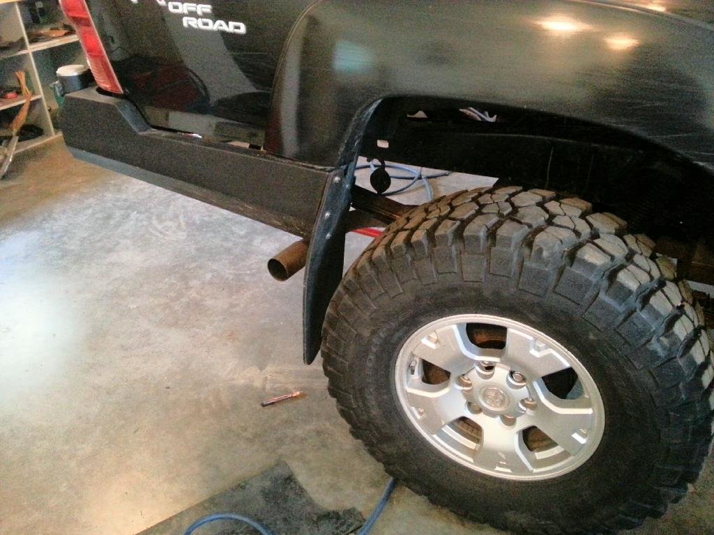

    i cut 7" off the fronts and 5" off the rears. they are about 5" long now.
    anyways here's some pics of the finished work:

    I like those rims on that truck. :thumbsup:

    the butt dyno says i gained 25hp and 25 lb/ft of torque.
    nah really i dunno if there is a difference but it sure felt different when driving at highway speeds.
    it felt like i was driving my old 1988 1st gen toyota truck from back in the day. :D

    i think i trimmed them too short. i was noticing alot more rocks and pebbles hitting the bottom of the truck.
    i ordered a new set and i'm gonna trim the fronts down to 8" and the rears to 6".
    this should do a better job than 5". still short enough not to hit on things but long enough to protect.
    ordered a new set and also some prerunner rear flaps. cut 3.5" off the fronts and 2.5" off the rears. the fronts are now 8.5" long and the rears are 7.5" long. perfect to me. protection and enough clearance as well. my truck is leveled out though. the front is 1.5" higher than stock. if you run stock you would probably want to go shorter on the flaps. maybe 7" or 7.5" in the front and 6" or 6.5" in the rear.
