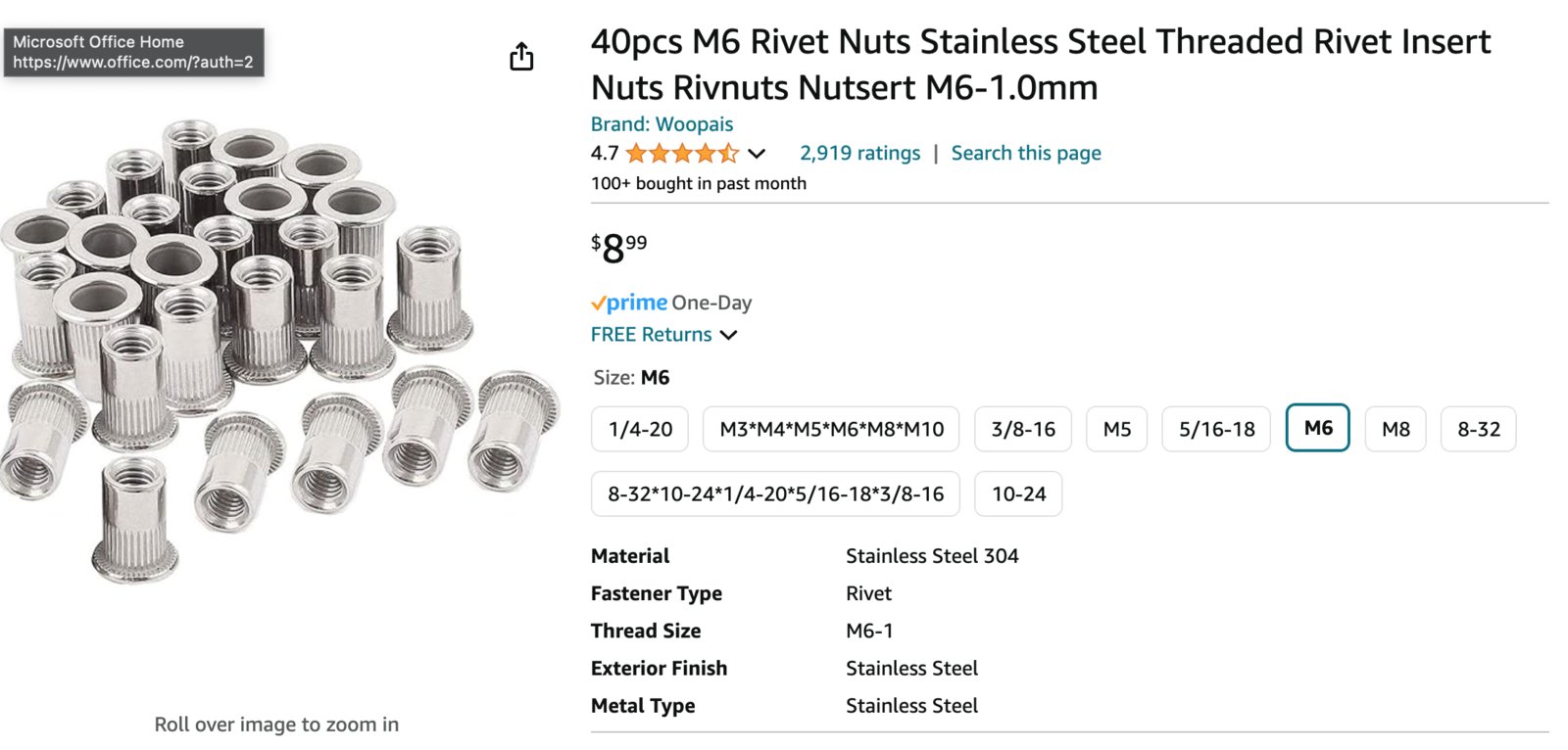

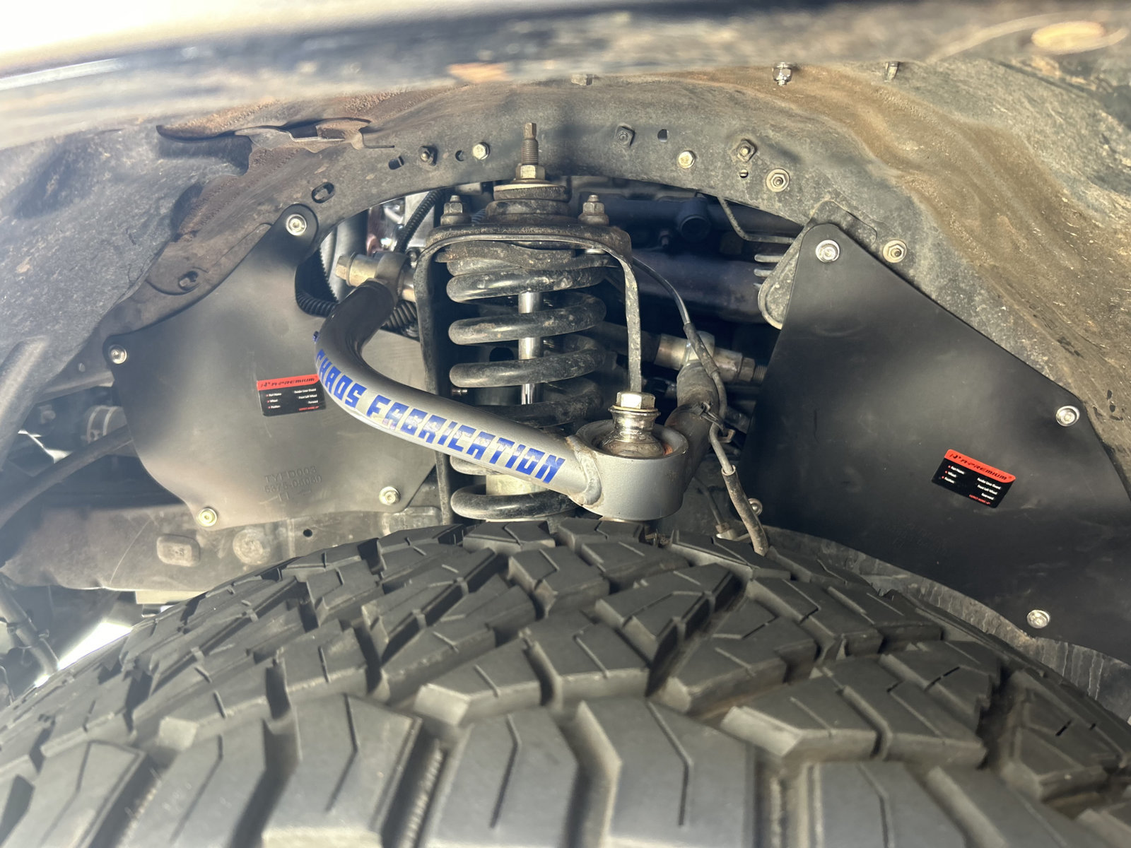

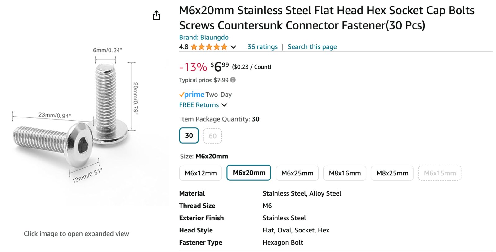

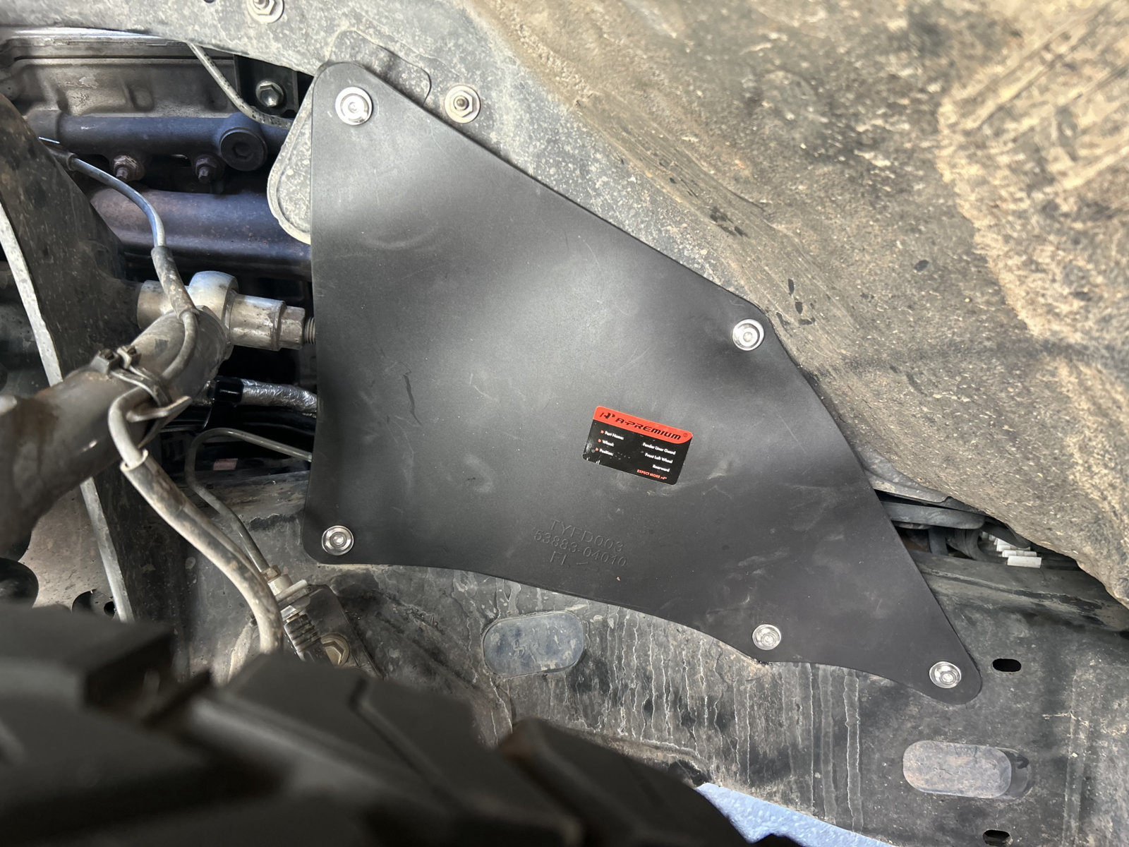

    I didnt really plan this one, but while working on the truck today i was fumbling with broken mudguard plastic retainer clips again so i just decided to drill each hole a bit larger with a 3/8 bit and then seated some M6 rivnuts and used some wide head socket head M6 screws and M6 washers.... i doubt these will ever flop around again. (note: the aft facing screw for the fwd guards that insert into the strut tower frame do not come in proximity of the coilovers, there is plenty of clearance)
    AFE670FD-6B8B-4F9E-A98E-E05E2CA494FF.jpg B480B203-139F-47F1-98C4-61532AB7C2F0.jpg
    i happened to have these left over from another project:

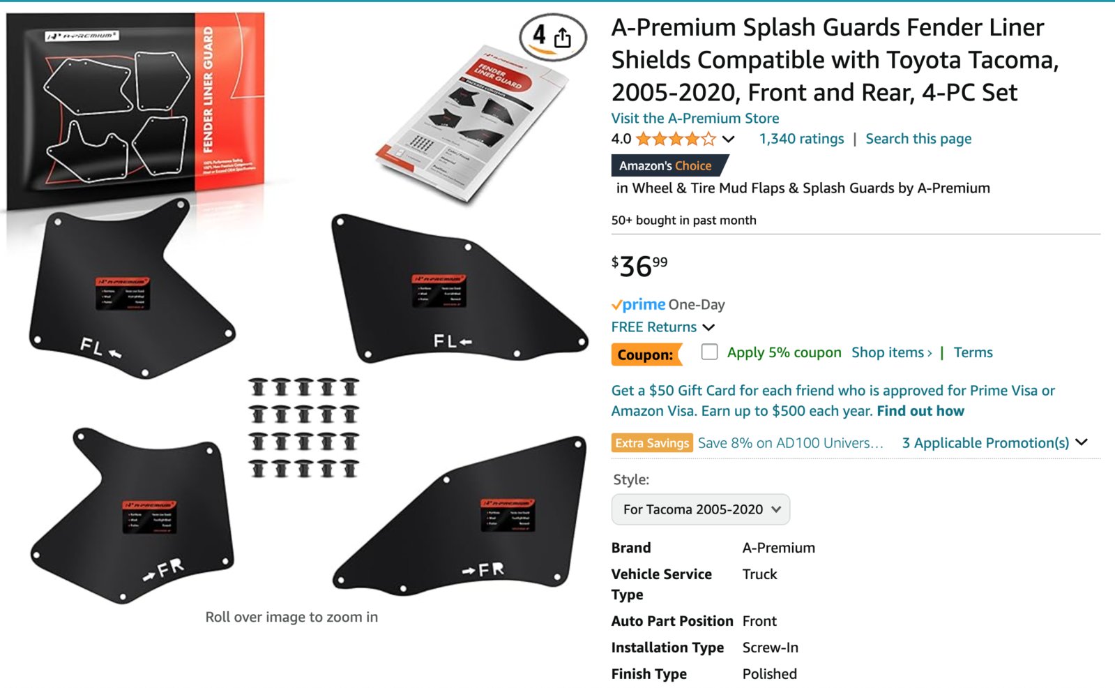

    Where did you get the mud guards? and great Idea on the rivet nuts!

    for the mud guards that i just put on, i got them from Amazon, they seem pretty good, we'll see in due time, but i think they are better than the cheap stock guards. they are so inexpensive so even if i have to replace every few years .... good enough
