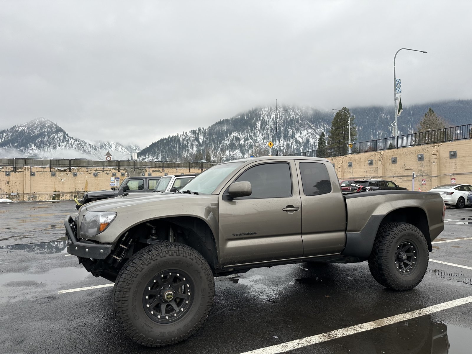

  13. Dec 17, 2023 at 12:37 PM
    #33
    JdevTac
    JdevTac Well-Known Member
    Jan 8, 2012
    #70234
    6,326
    Josh
    MD/GA
    2nd gen
    I went up to Leavenworth over the last few days and tires were fine up and down the mountain passes in the wet. Didn’t get a chance to try them out in the snow much but glad it didn’t storm while I was up there.
    I’ve had them for a few thousand miles now and have no complaints! Especially for the price (37x12.5)
    Gmak621, JSX, Ejctt and 1 other person like this.
  14. Dec 17, 2023 at 1:34 PM
    #34
    Taco_Runner
    Taco_Runner Well-Known Member
    Dec 6, 2015
    #171643
    180
    Jay
    Northern Oregon
    ‘23 Taco LTD On Road
    Sweet mother of gawd your truck is a beast! Right on, good to hear it thank you! I need to make a Leavenworth trip again soon.

  17. Dec 17, 2023 at 5:24 PM
    #37
    JdevTac
    Jan 8, 2012
    #70234
    6,326
    Josh
    MD/GA
    2nd gen
    I bought it off another TW user last year. The shop that built it tubbed the firewall and did a cab mount relocate. That and it is long travel with chopped 6” flare fiberglass fenders
