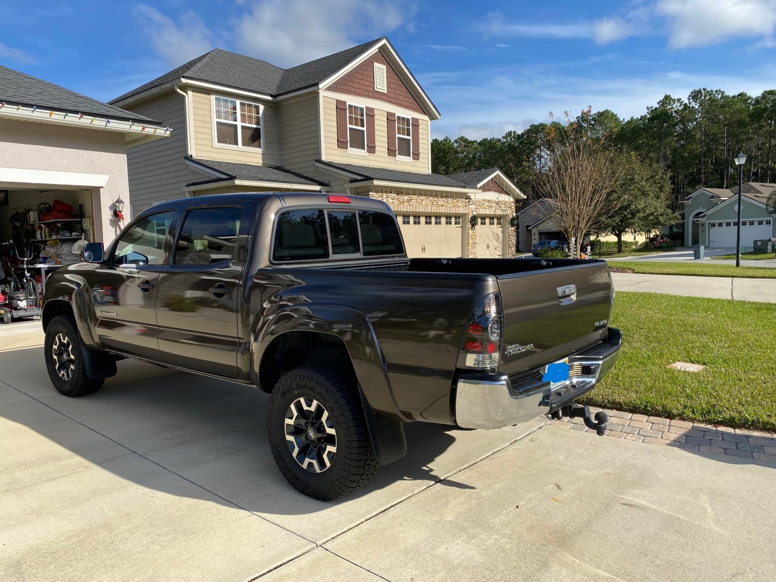

    Stock ones work well just cut 2" off rears (under the 4x4) and 4" off fronts. Used tin snipes and then a file can't tell they were altered.
    Fronts sometimes crack or split apart right under the cab where they were over flexed so JB weld plastic bonder fixes that and then the 4" cut off.
    I reinstalled with stainless metal screws and new push pins.
    The aftermarkets holes never line up with stock and are almost impossible to get on and are too long anyway.

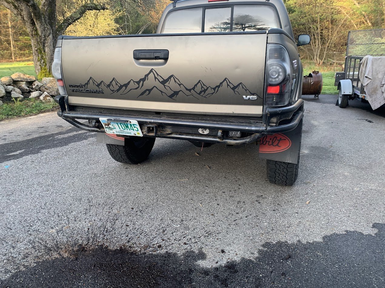

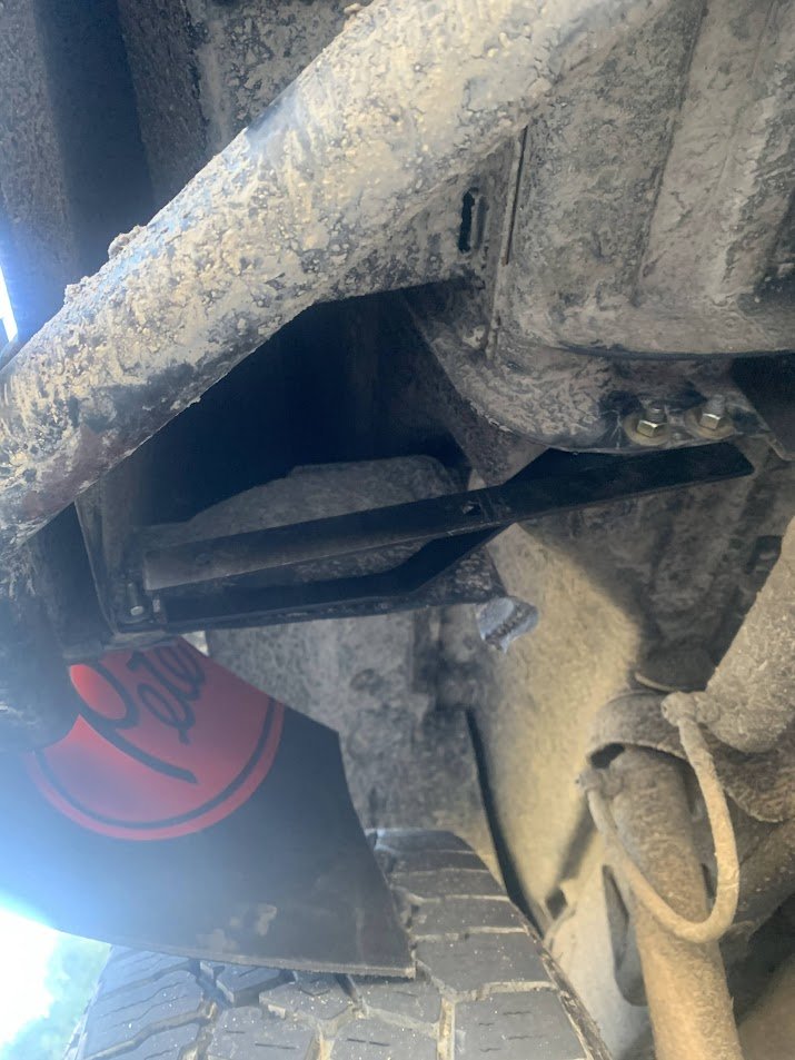

    Theres ways. I wouldnt do it this way again but works good enough.

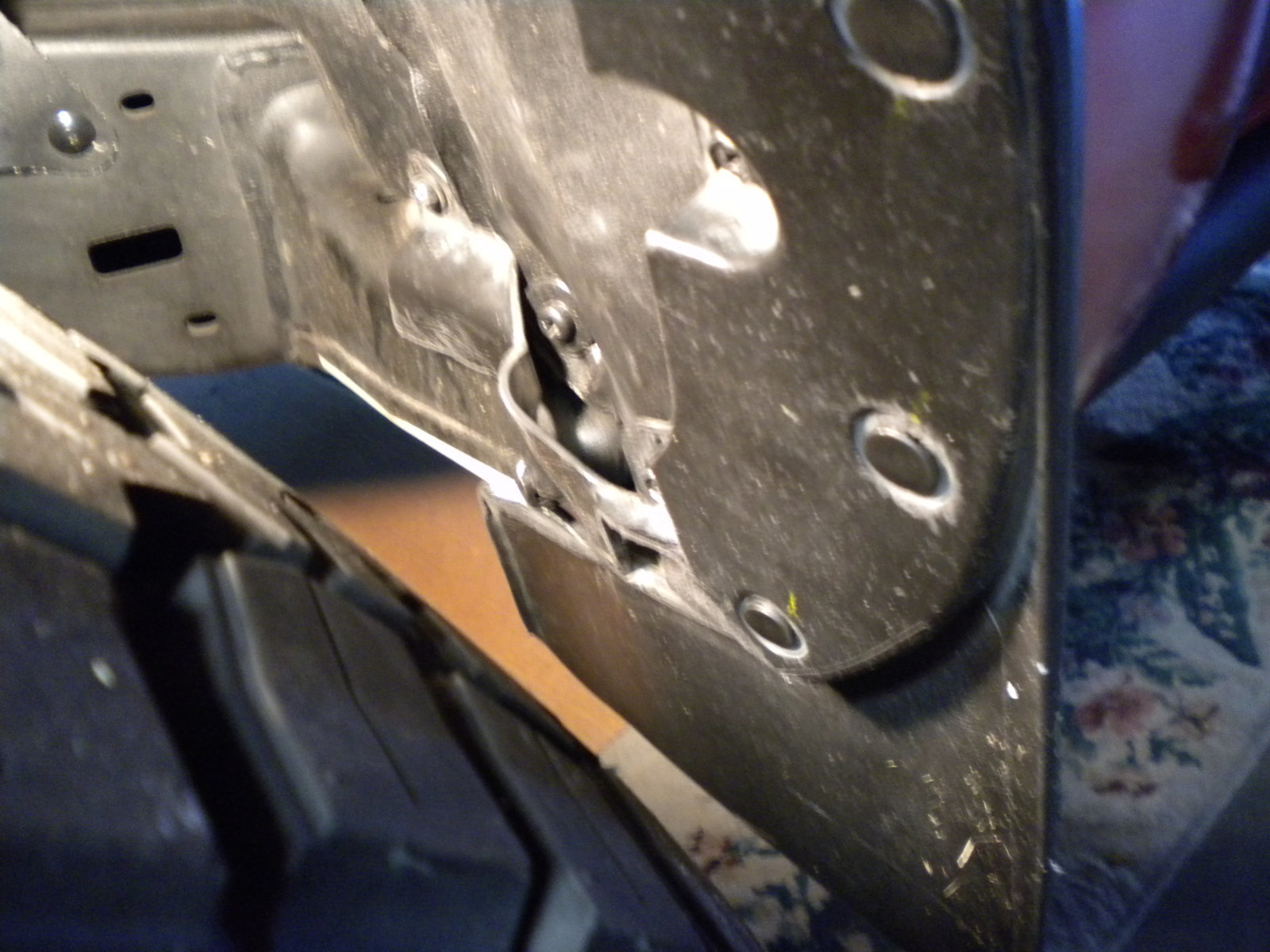

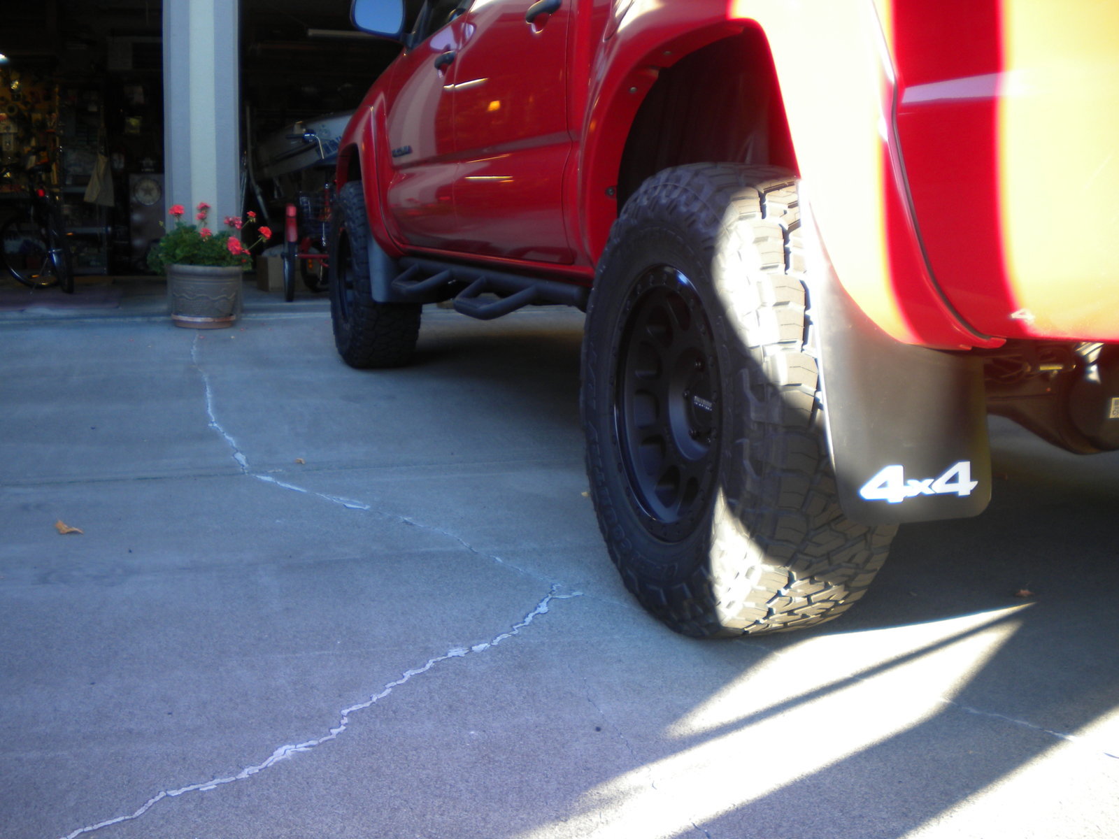

    1" off rears / 2" off fronts. Also, trimmed/molded fronts due to rubbing with larger tires.

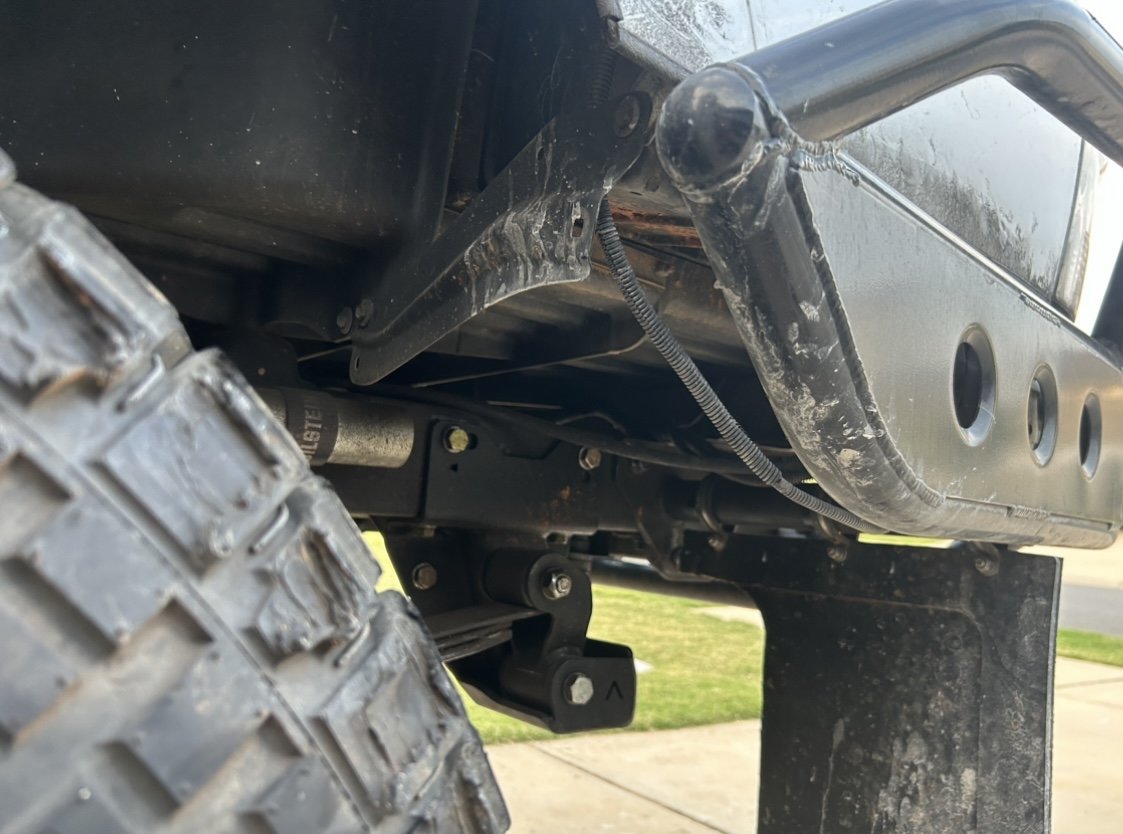

    I bolted my flaps onto my HC bumper. They’re holding up well. Deets:
