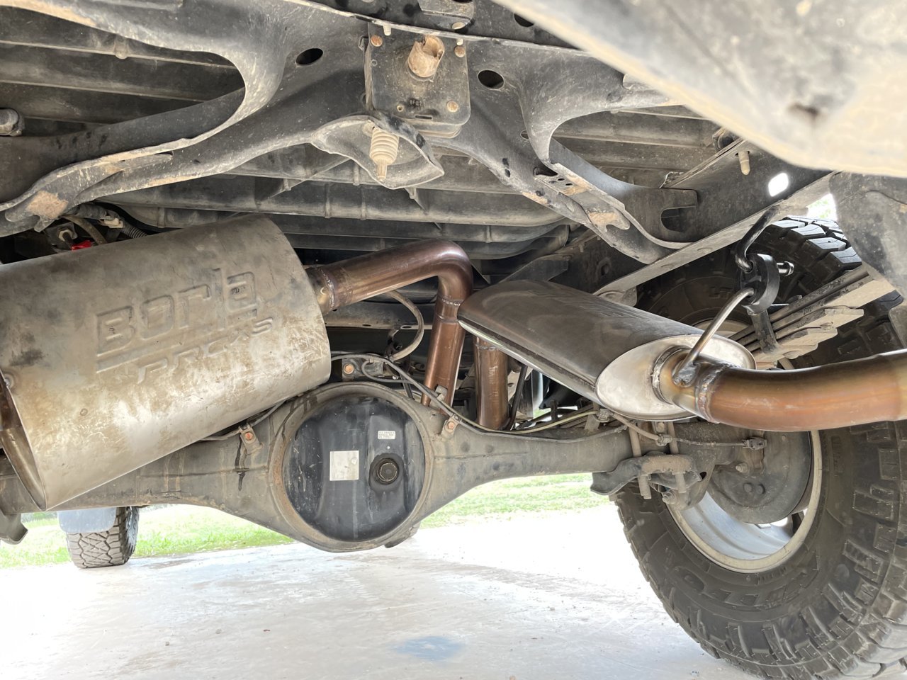

    You can make it quieter with flow through mufflers, but since you deleted your cats, you’ll need at least two, but probably three to get it to a good sound level if the mufflers are straight through style. I run borla pro xs mufflers on my truck and I’ve been happy with them. Vibrant resonators also help with drone/raspiness/noise level, but a little less so than a straight thru muffler
    here’s a straight thru exhaust I recently built
    vibrant resonator>borla 3” in dual 2.5” out> borla 2.5” mufflers on the tail pipe. this is my daily and I am very happy with the noise level/sound
