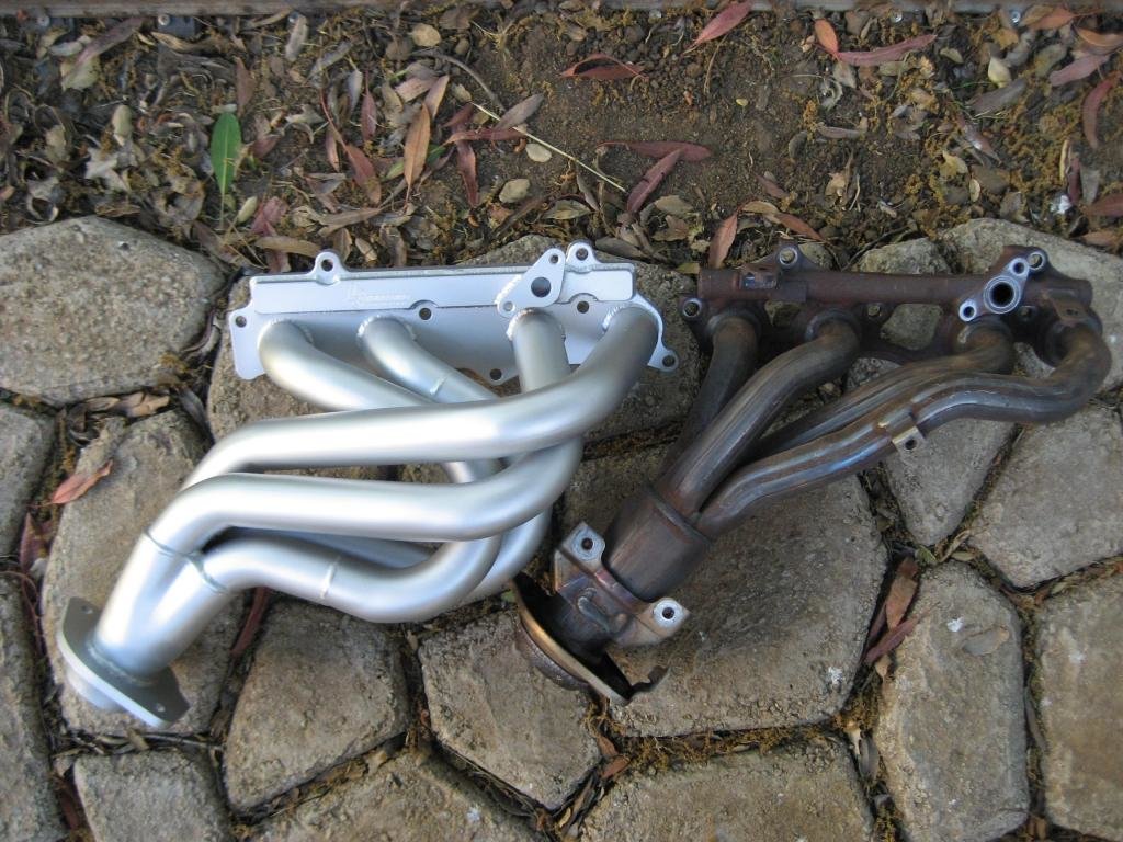

    Built for maximum low end torque, tooter II.VII intake manifold spacer, LCE long tube header, Injen long tube intake, 2,900 rpm torque peak.
    In my opinion, no.
    I installed an 18" Magnaflow with the stock tailpipe on my 2.7 and lost low end torque. And even though when I reinstalled the stock muffler and cut the tailpipe behind the rear axle, I still got the low end back.
    So from this experience, I learned that the engine needs some exhaust backpressure for low end pull. If you open up the exhaust, you'll likely gain more performance at high rpms, but it will come at the cost of low end torque.
    I'm running a long tube LCE exhaust header before I had changed the stock muffler...
    It keeps the exhaust pulses in the runners separated from each other for a longer distance. This creates a resonant tuning of the pulses which lowered the rpms needed to achieve peak torque by 650 on the dyno. But even with the exhaust header, I still needed the stock muffler to provide enough backpressure for efficient exhaust scavenging at low rpms.

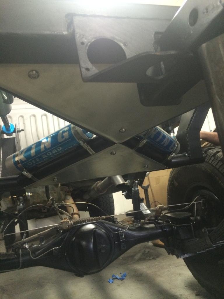

    TRD Supercharger, URD 7th injector, 2.2" S/C pulley, light weight crank pulley, CAI, CB exhaust, Camburg Mid-Travel front, LSK Cantilever L/T rear

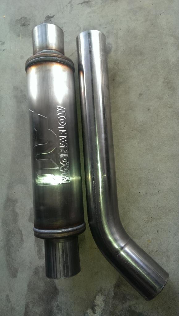

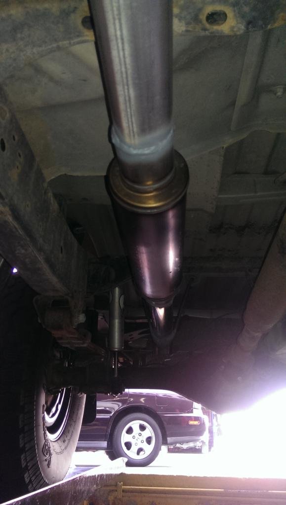

    00 3.4 supercharged 14" long 4" round magnaflow turned down before the axle
    IMG_6712_zps5pticodg_57e66e366127a546f912bf0b85a620c85e1200a9.jpg IMAG0999_zps7nebjman_150a86f235898a644f4ac08165470e81df37f04f.jpgIMAG0997_zps5u6znnwq_d3088359f97ef9e85f0fff07d4b218691b1c9e22.jpg

    I wanna see this, Something I've been wanting to do for a while, I wouldn't be changing my muffler though, just getting the mandrel bent piping needed, I'm very pleased with the sound of this 14"x4" round Magnaflow muffler.
