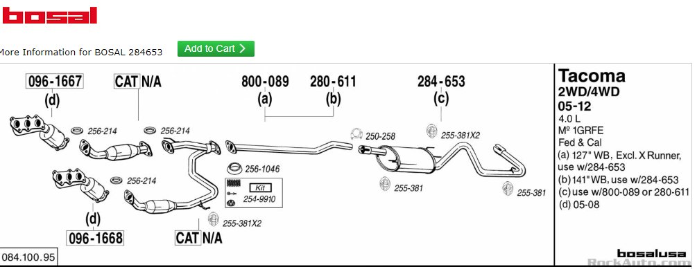

    Reviving an old thread here but wanted to see current recommendations. I am in the same boat and need to replace my muffler to pass inspection.
    TRD Cat back - $400
    OEM Toyota - $400
    Bosal - $110
    Is the TRD worth the price compared to Bosal?

    I know this is an old post, but I'm surprised no one has the Bosal part number, too. I'm interested in this cheaper option. Anyone got info?

    I know its an old thread but adding for comparison was just quoted at a DC area small muffler shop $400 for a Walker "OEM", seems pricey to me even for DC, guess Midas or a chain shop would be even more $. Just ordered from Rockauto for $116 with 3-day shipping, I'll save the $280 and install myself.

    That’s what I did basically - ordered a Bosal from Advance Auto Parts which had a site wide sale and installed myself. I paid $124 at the time shipped.
