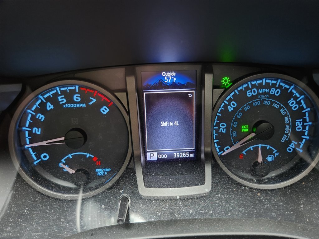

    I think this warrants a separate thread, as I seem to have identified the issue.
    For context: I installed the VLEDs footwell light kit last year. Shortly after that, I started getting a "Shift to 4L" error notification on my dash. I realize that this pops up whenever the auto-headlights would turn off. I tried to re-seat the connection for the VLED V2 harness and it seemed to have fixed the problem initially, as the auto-headlight turning off would not trigger the "Shift to 4L" message anymore. However, the issue showed again the next day and I tried reseating the connection to no avail.
    I also discovered that the MTS is not activating; pressing the button does nothing. Perhaps this is where the "Shift to 4L" message was coming from. I tried disconnecting the VLED harness and directly connecting the original overhead harness and the MTS was still not activating. This makes me think that its likely the overhead console that has a problem.
    Can anyone with a TRDOR AT please confirm that pressing the MTS button on 2Hi/4Hi will show a "Shift to 4L" message? Also called the dealer and inquired about a warranty appointment, but they want to run their own diagnostics first (189CAD/hr fee) before categorizing the issue.
    I'm trying to decide on a path forward hopefully sometime soon.

    Thanks. Would you be able to check if pressing the MTS button while not in 4L will result in "Shift to 4L" message?

    Here's what I get when pressing the MTS button in 2WD. I also have the VLEDS footwell lights version with the harness in the overhead area vs the A-pillar.
