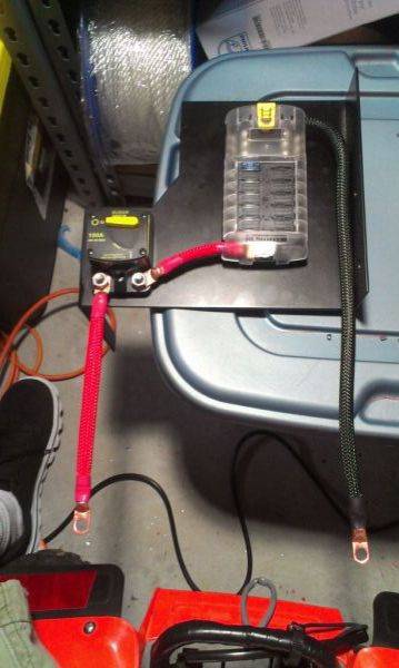

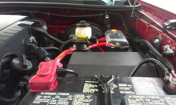

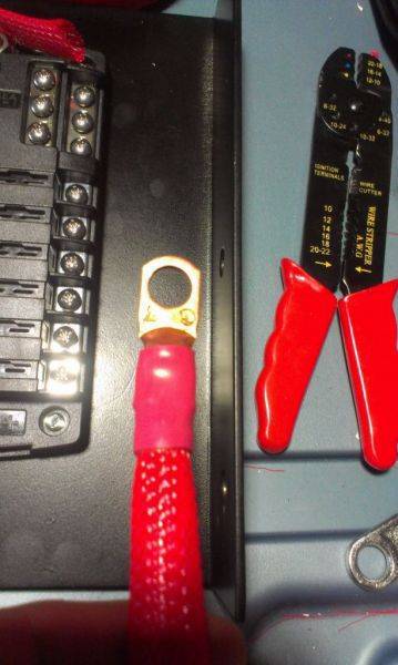

    Make you some cables

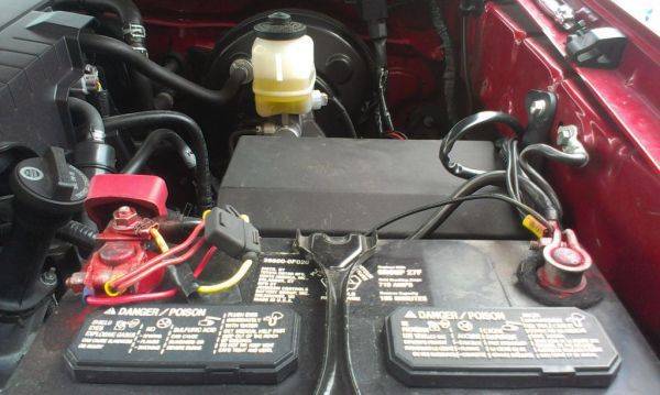

    And the before pic.

    Got it. Thanks. I just went to look at the OEM positive connector again, and it does have a 12mm or so stud that I can tap into just like your setup. Does the ground from your fuse box go back to the battery negative or to the frame? Or it doesn't matter?

    Yup, to the battery negative from the fuse block.
