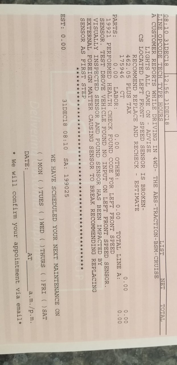

    Just picked up the truck. Turns out it is wheel speed sensor kind of relieved. Heres my papers 15462915581925752217915156440600.jpg

    Nope. It wasn't defective, it was destroyed lol. So looks like its about 200 and change from autozone and 15 minute install.

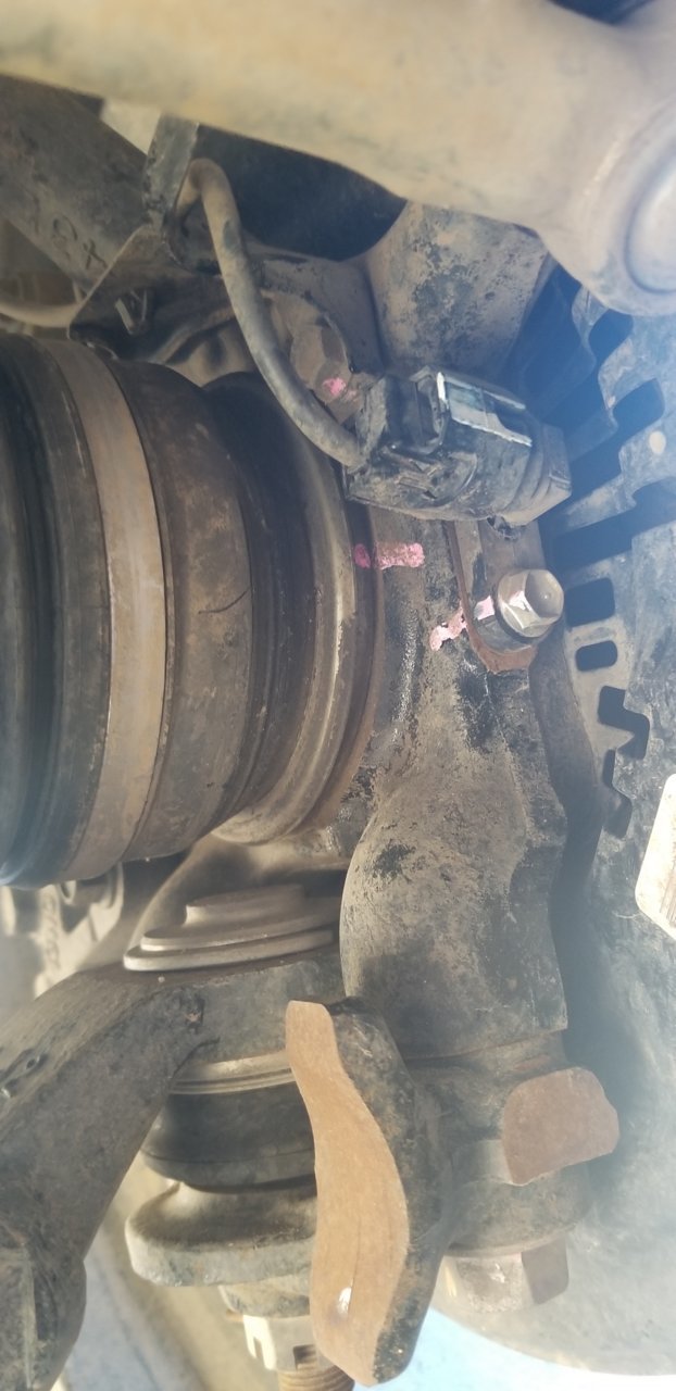

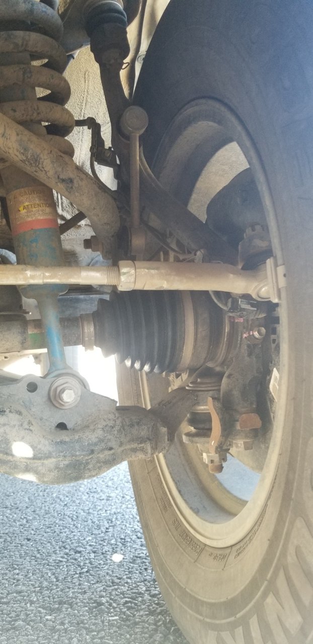

    Just for reference heres pics of the wheel speed sensor they're claiming is broken. You can't really see it outwardly broken but theres definitely alot more play than the other ones. 20181231_134225.jpg
    Heres another shot from a few inches back to gi e you a better idea what you're looking at if you're unfamiliar
    VaToy likes this.

    Yeah those things are scary how fragile they look with the other heavy duty stuff in the same area. I haven't had to replace one yet so look forward to hearing how it goes.

    SO I guess a chunk/shard of ice flipped up there and bashed the sensor?
    Wow. That's unlucky AF.

    Yep Guess so. That or a rock or something. Idk. Happened out of no where no impact no big obstacle nothin.
