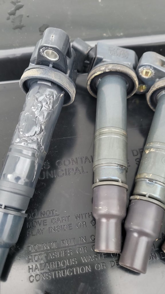

    I will look for the picture of the melted coil. I was shocked when It came out of the engine.

    I found the photo

    So far, only one that looked like the photo. The others are just frying/stopping

    Only times I've seen coils melted like that it was either a coil driver getting stuck on in the ECM or shitty coils.
    I've never seen a coil driver get stuck on on a vehicle with indirect coil drivers like Toyota though, not to say it can't happen.
    I'd certainly want to take a scope and compare bank 1 and bank 2 coils though.
    I doubt a dealer would have a scope or even know how to use one, most dealer techs follow the troublemaker flow chart in the FSM and don't think outside the box.

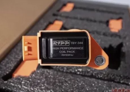

    The last time I got this problem is was due to aftermarket performance coils, the entire back #2 failed on a 3.5 tacoma and they all had blistering, it was truly odd.

    Those RIPP coils are junk, so many people have had issues with those but they still keep buying them.
    I rarely have to replace a coil on Toyota stuff, when I do it's usually a failed aftermarket one not an OEM one.
