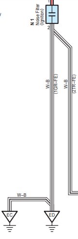

    Wiring diagram for the coils.
    TRDMopar[OP] likes this.

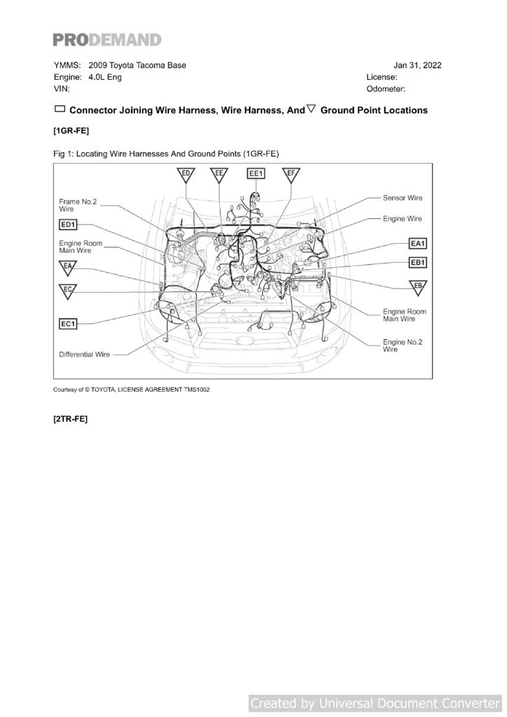

    Is there a list of all the grounds in the engine bay?

    Thanks! I am really curious if there is a rusted ground. I had to get the frame repaired and I might have overlooked some connections.

    The ground for the coils and some of the ECM grounds are at Ground Point EE on the back of the right cylinder head.

    There's a stupid one on the power steering pump and on the frame next to it if I recall.

    Yea Ground Point EC, it's for the ignition noise filter capacitor only and has a redundant ground at Ground Point ED.
