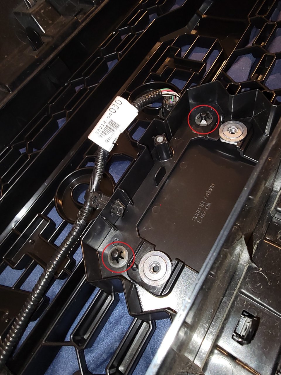

    From my experience when swapping to the pro grill, the garnish you use matters. I tried two different ones from Amazon, the lights / warning messages would always eventually come on. Then I bought one from tacogarage and it works great. Also, make sure the push lock nuts that hold the garnish are on tight (they can be a pain in the ass to push down all the way). I didn't have to use washers to adjust the angle, or disconnect the battery. Not sure if it matters, but I went with the OEM pro grill and aftermarket garnish.
    Circled in red
