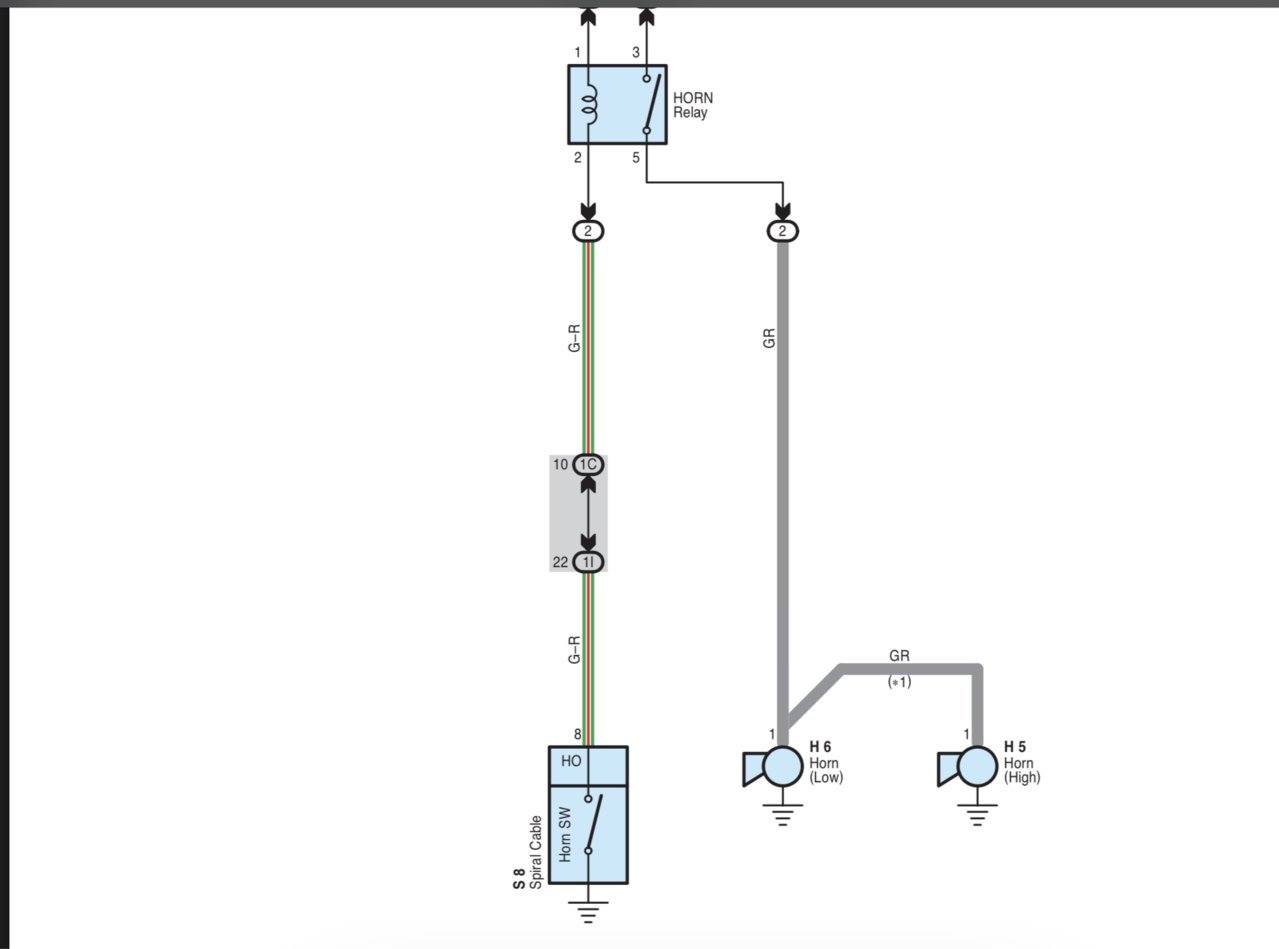

    There are multiple ways to check it.
    1. Unplug the horn and check for power when the horn is pressed.
    2. Test the relay.
    If you are careful, and have access to a wiring diagram
    3. Test the ground side of the relay terminal for continuity when the horn is pressed.
    When you press the horn it grounds the relay.
    Remove the relay.
    Probe the ground terminal of the relay (not the relay, the spot where it plugs in)
    Press the horn and see if you have continuity.
    @Jimmyh
    The above method should work, right?

    Yes.
    I would start at the horn power wire(s) first.
    Unplug the horn(s). Connect meter to one of the wires and ground with the other lead. When you mash the horn button you should get 12 VDC if you don't then have someone move the steering wheel and mashing the horn as you are reading voltage if it comes and goes it is the spiral cable.
    ------------->Horn Wire-----> Meter Red Lead----->Volt Meter set to VDC----------->Meter Black Lead------> Chassis Ground or Battery Neg Terminal

    So, before I started taking stuff apart I tried cranking the wheel all the way to both sides and pressing the horn, and it worked. Pretty sure I can safely assume it's the spiral cable at this point. Any expert consensus on $26 Amazon replacement vs. $200+ OEM?

    I’d feel safe with doing the spiral cable at this point.

    Yes.
    And it looks like you have it isolated already.
