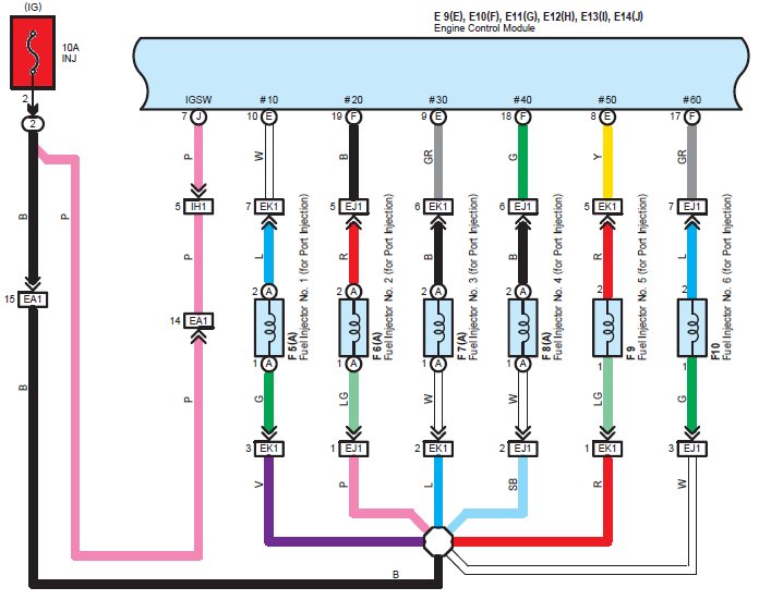

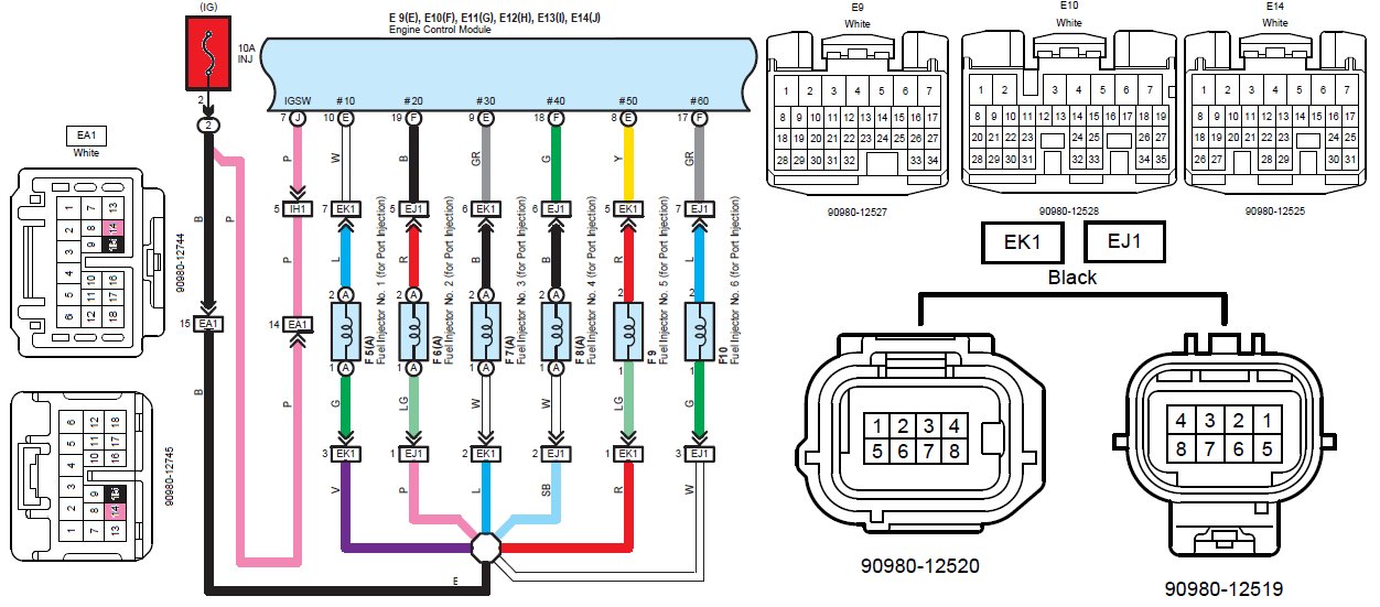

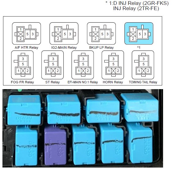

    The overall issue I am having is I reside in a very very remote location. The mechanics here cannot work on the vehicle without warranty guidance from the manufacturer. Due to the incredible high cost of mechanical labour here, my warranty will not blanket cover fixes unless Toyota works with the mechanic on the work needed. Toyota will ship parts free of charge to this location then cover up to what their shop rate would be then I pay out of pocket for the rest. Because the mechanic explained to Toyota what the issue is (essentially the the INJ 10A fuse constantly pops after various drive times after replacement which then causes the above symptoms), Toyota's response was it is related to the fuel pump recall that they have yet to provide action for it.
    If anyone has suggestions that are not too invasive in mechanical work to trouble shoot this issue with the INJ fuse, I would be willing to try as both the mechanic and Toyota cannot figure out a solution to my issue.

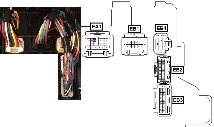

    What all feeds the inj fuse @caribe makaira ?

    Haha beaver eater love it! I'll run over to the truck today and follow the wiring and check some of the above diagrams.
