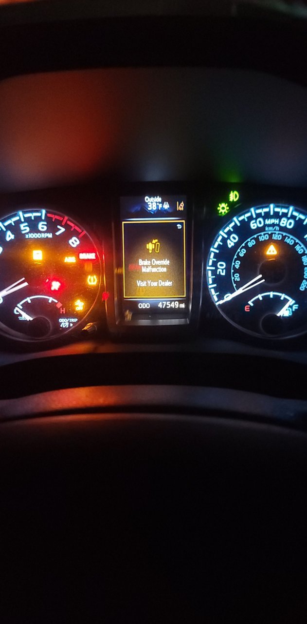

    Hello everyone,
    I have a 2019 4x2 Tacoma. Im having an issue with multiple sensors going off. The weird thing is if I shut the truck off and start it again they disappear for about 10mins.
    I've taken it to toyota but they couldn't really do anything without seeing any of the sensors going off. They ended up just resetting the codes and sent me on my way. They told me if it happened again they would have to recalibrate my pre collision sensor because they think it's because I put a after Market grille on it. I put the grille on almost a year ago. I even drove 5 hours to Tennessee and never had any issues.
    I did recently go to Valvoline for an oil change because it was too cold to do it myself. The next day, after the oil change, my dash lit up light a Christmas tree. They also had an issue getting the skid plate off but I don't know how that would interfere with anything. Anyone have any ideas why everything would go off?

    Check your abs sensor wires on both front wheels. Oil change clown may have snagged it somehow when dropping or installing the skid back on.

    It would have been nice to know what codes they erased?
