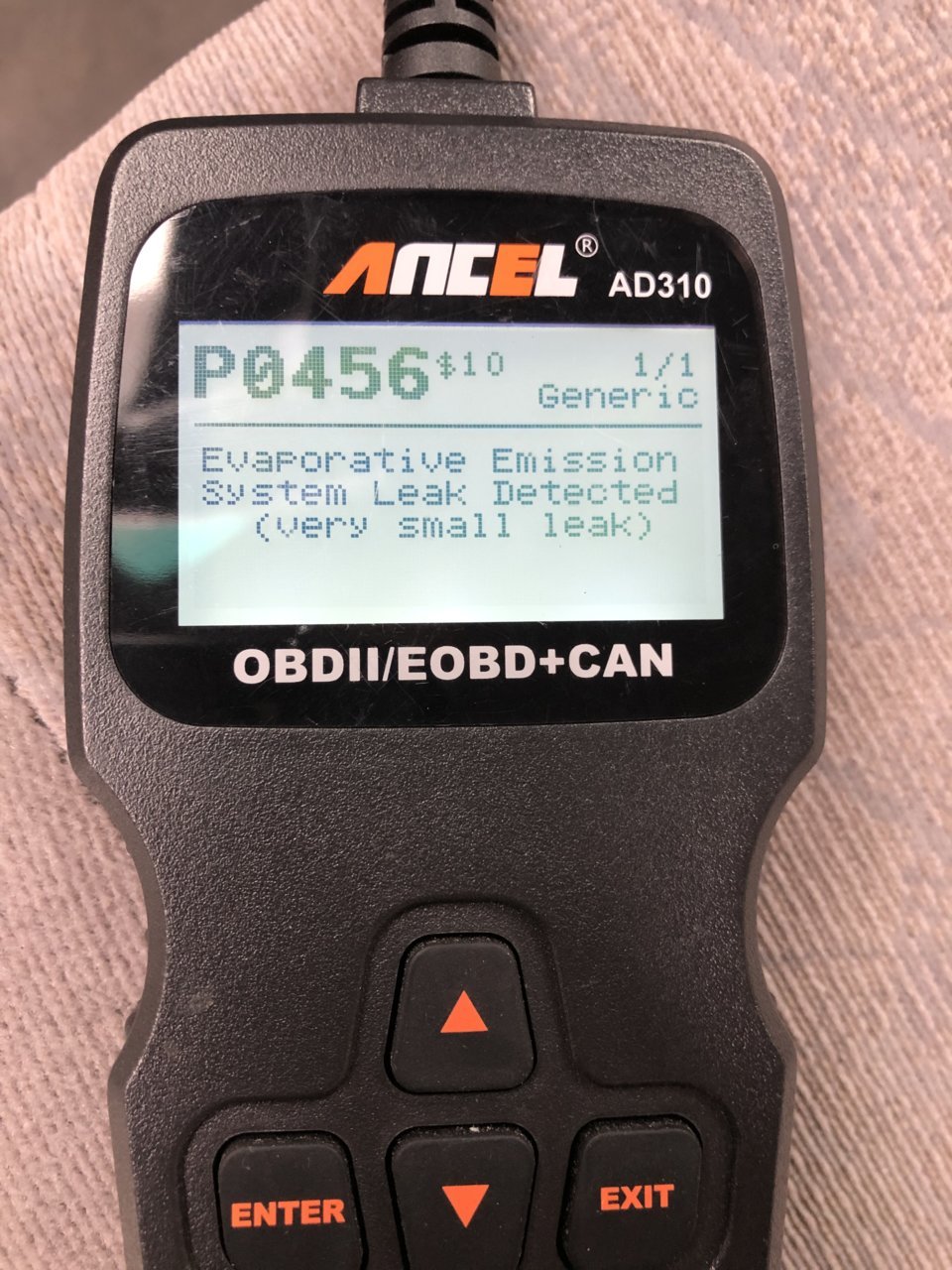

    I get this code ones or two times a month. I cleared and just wait till the next one . I swap gas cap already . AA2988BE-1254-41E7-A1AA-9A403B054C70.jpg

    charcoal canister.
