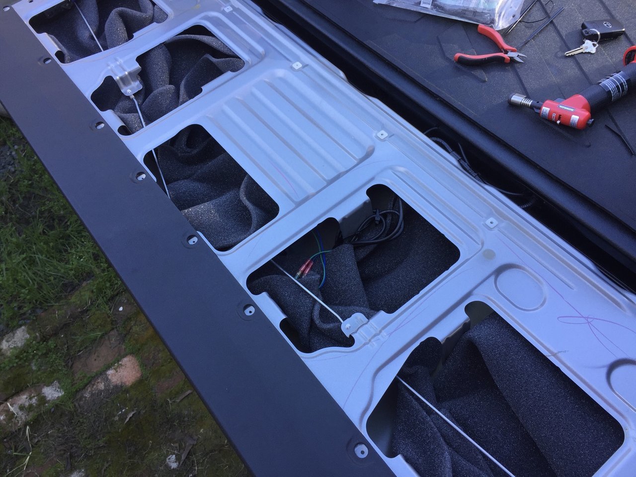

    Just installed the Pop & Lock, my tonneau is on order and didn’t want to key the tail gate every time. I put cheap foam in the tail gate to deaden the loud sound of the actuator. Cheap and easy solutionA2A248F5-7630-4D7E-845E-038E875C34DA.jpg

    does the foam reduce the loud actuator? thinking about greasing the actuator instead but havent gotten around it yet..

    Just a thought, do you know or think that particular foam will retain moisture? Would suck to have both low tide smell and rust due to it. Wonder if styrofoam or closed-cell product would be a good choice? Not criticizing your work, just thinking out loud.

    I think it helps some with the echo reverberation of the sound. It’s not about grease but that the actuator is violent. It just slams each direction like a sucker punch to the locking mechanism.
    So I used wall mounted AC filter foam, it’s cheap and is meant to be resistant to moisture as it’s used on those box AC units.

    Smart! (Couldn't tell that from that from the photo)
