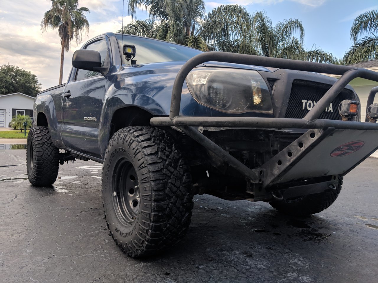

    I got my 2015 Tacoma 5 Lug stock with 32x11.50r15 and 15x10 rims to fit by cutting out the fenders..
