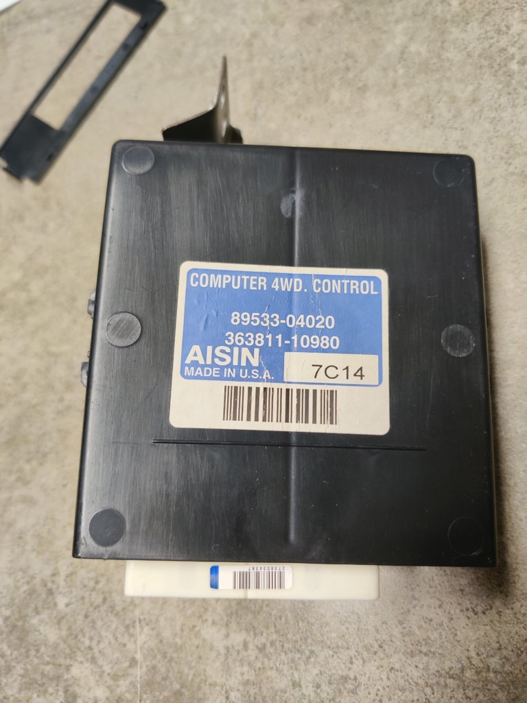

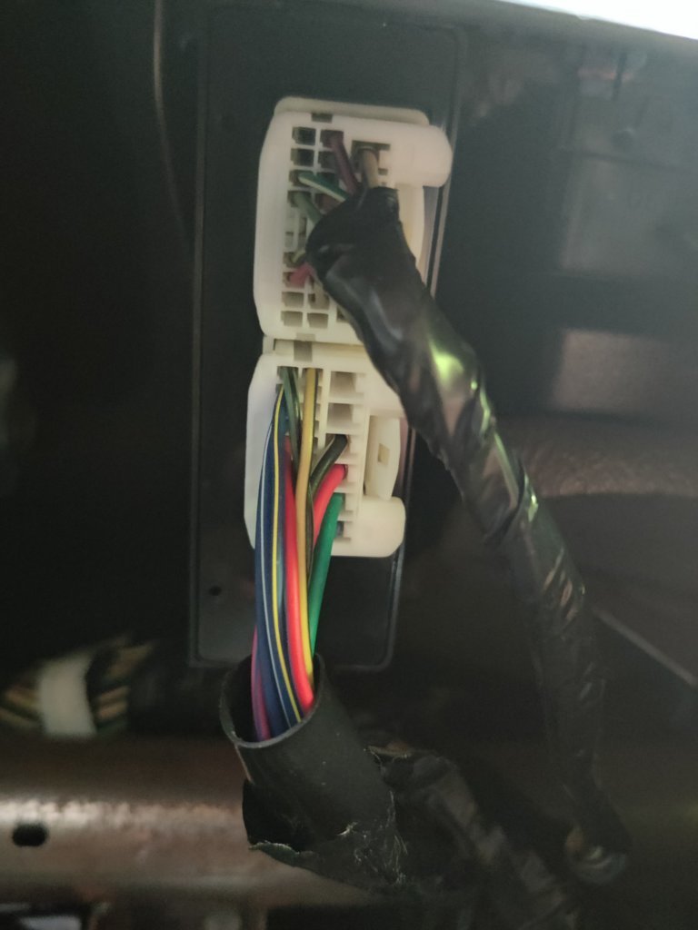

    Alright I've pulled it, but I'm unable to get the circuit board out to examine it. Delicate plastic for sure.
    Dm93 likes this.

    There should be a latch on each side where the connector is to take the cover off, then the board should slide out.

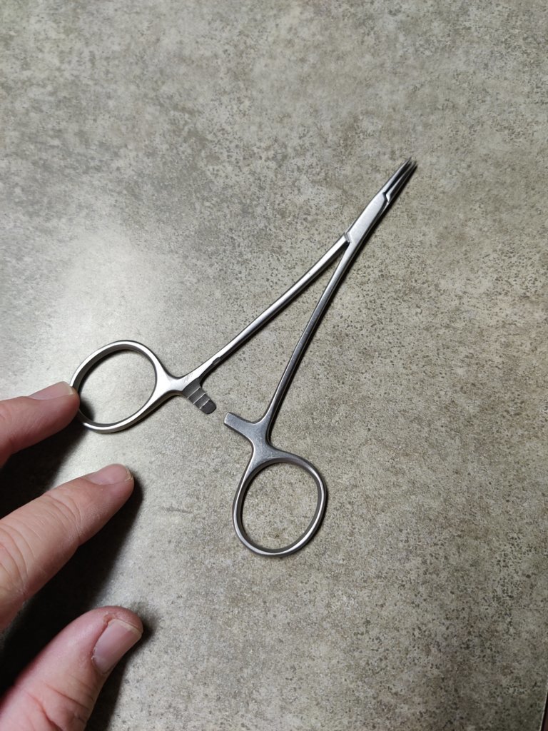

    I removed the cover but the circuit board doesn't come out. I was pulling with a set of medical pliers, tried prying with a small flat head. She's got a scase of the don't wants.
    I'm quite famous for breaking plastics so I'm cautious.
  17. Jun 27, 2025 at 6:45 PM

    Broke my jaw many years ago and these were given to me to use in case of an emergency to remove the wires binding my jaw.
    They're very handy.

    Interesting, it should come right out with the cover removed.

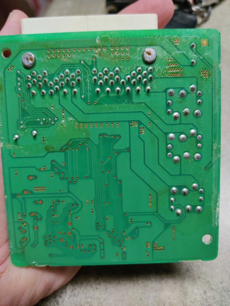

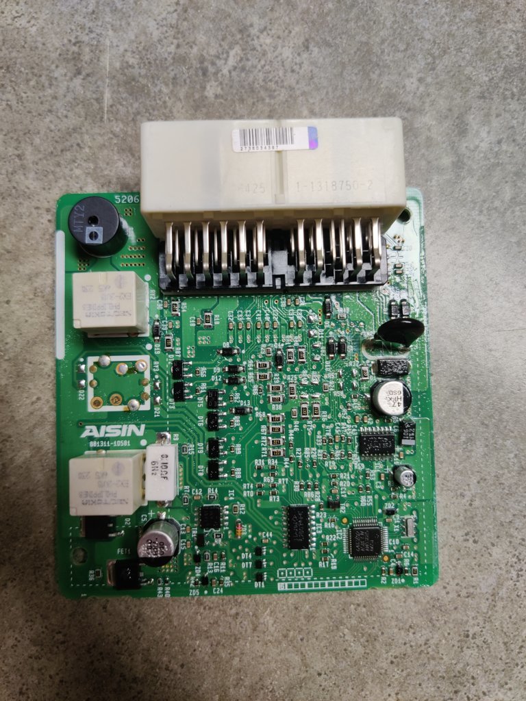

    Ok I reinstalled it. Left the cover off and used 2 sets of those pliers and managed to get it out.
    Dm93 likes this.
  20. Jun 27, 2025 at 7:01 PM
    #20
    Dm93
    Dm93 Test Don't Guess
    Mar 3, 2015
    #150066
    13,561
    Texas
    2014 DC OR 6spd 4x4
    Predator tube steps, Ranch Hand grill guard, Magnaflow CatBack exhaust, Toyota tool box & bed mat, 2LO Module by @Up2NoGood, Rearview Compass/Temp Mirror, Tune by @JustDSM.
    I don't really see anything amiss but I can't see the pins well enough to tell if any solder is cracked.
