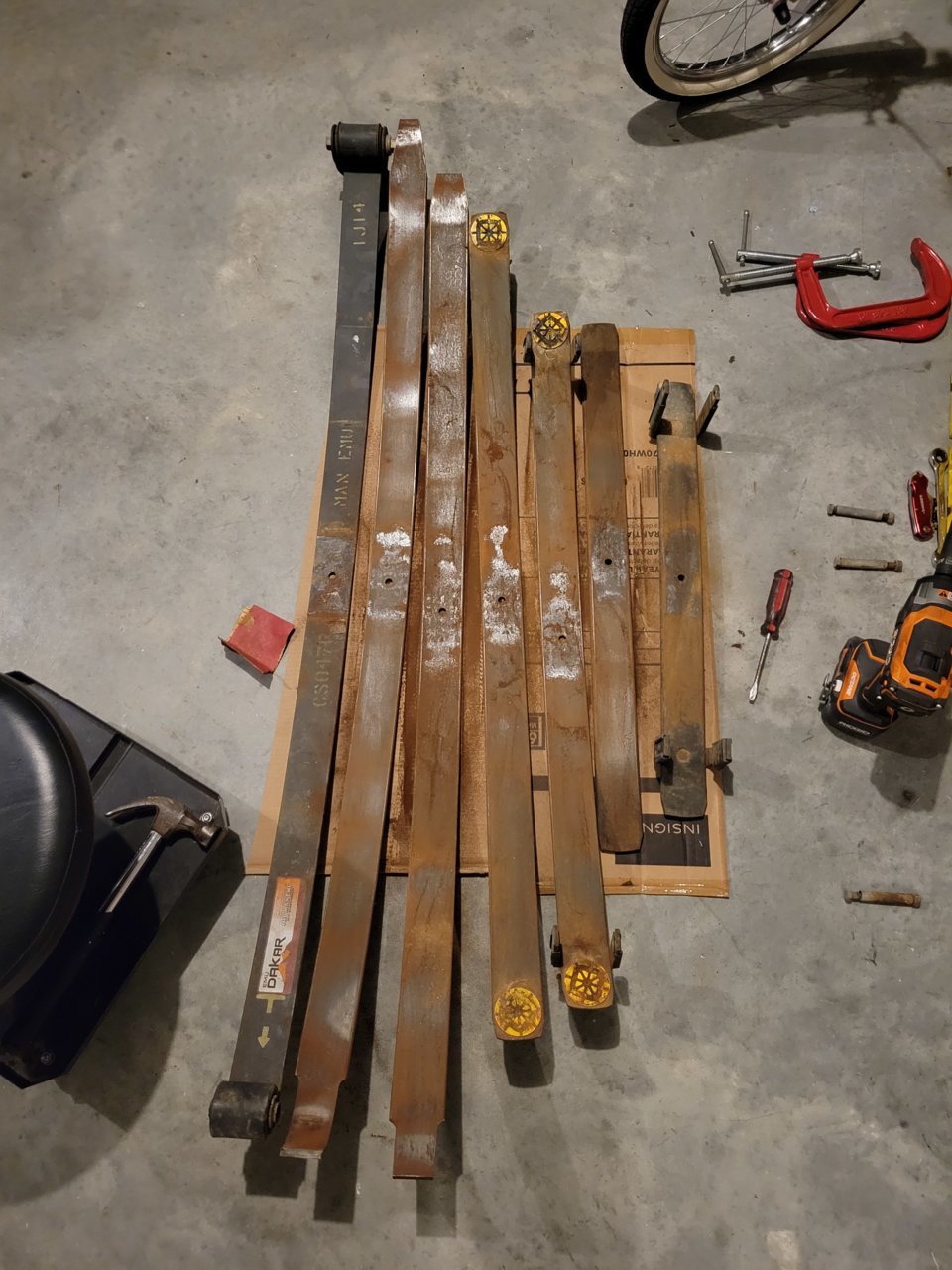

    Got the leafs done before leaving for Christmas vacation.
    packs disassembled
    sanded to remove surface rust
    painted with EZ-Slide graphite paint
    ES grease applied to anti friction pads
    3* shim from wheelers installed
    D29XL AAL installed
    longer u-bolts installed and trimmed

    Looks like the same kit I run on my 1st gen.
