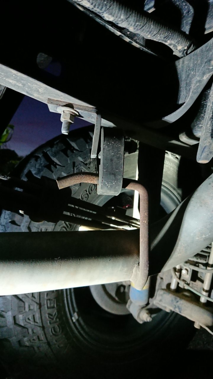

    Yes, there is an extra hanger that comes with the kit.
    It installs into an existing hole on the left side of the frame.
    It can be adjusted to a certain degree, so that you can clear the rear end of the leaf spring.
    It is best to install without the spare tire, as it can limit working space drastically.
    I'll try to get a picture of it later, it has been pouring for the last couple of days.

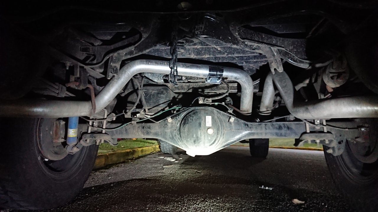

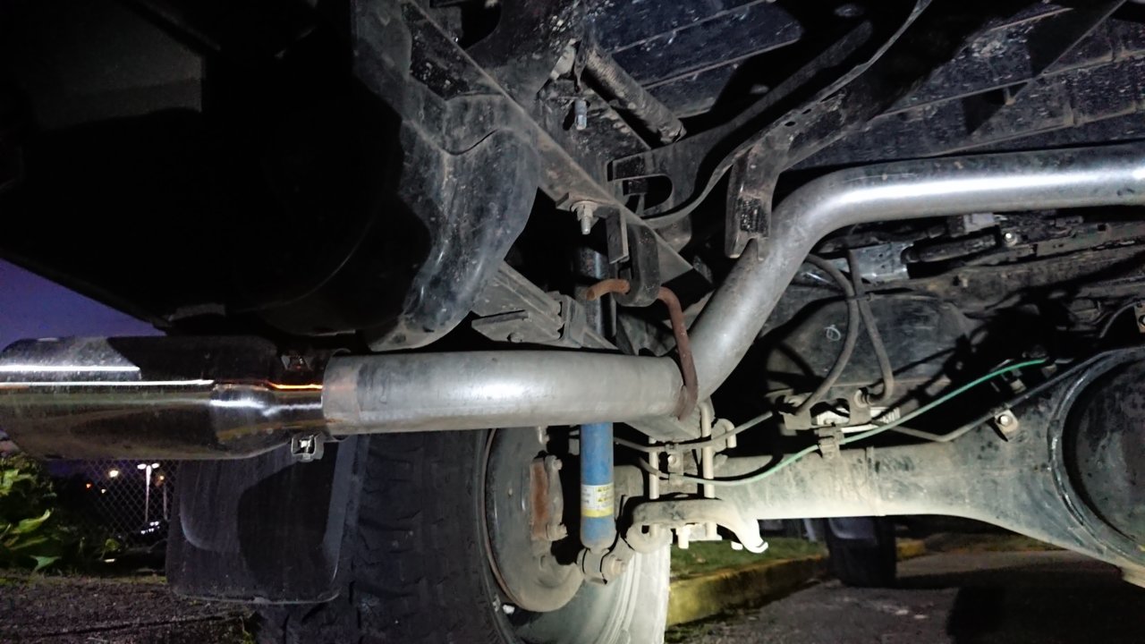

    So I finally got around to taking pictures of the underside.
    The driver side piping uses an existing hole in the frame for a hanger.
