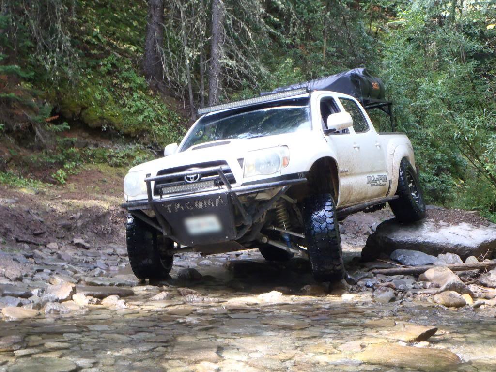

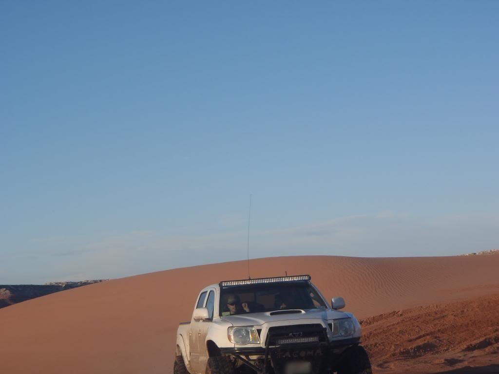

    any close up pics of how the light bar is mounted?
    Thanks

    Uses stock roof rack holes. I went with 3/16th steel so it would be stable. You'll have to use a press brake to bend the steel out since the 50'' light bar is wider than the rain gutter on the truck where the stock mounting holes are found.

    Nice, cleanest mount ive seen. pretty flush

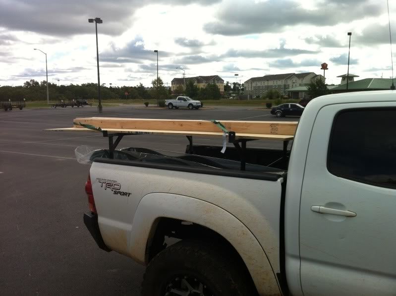

    Short bed, full bed cage, but still hauls a full sheet of plywood.
