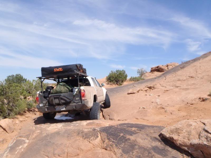

    love your truck:cool: would you happen to have any detailed pictures of how you mounted the roof top tent? im really interested in making my truck more of a hybrid trail/desert truck and i love the idea of have everything contained on my ride!:D
  16. May 26, 2014 at 6:03 PM
    #296
    Mxpatriot
    Mxpatriot [OP] Well-Known Member
    Nov 18, 2009
    #26163
    3,625
    '06 4x4 AP LT and Locked
    Same bumps
  17. May 26, 2014 at 6:08 PM
    #297
    Mxpatriot
    Nov 18, 2009
    #26163
    3,625

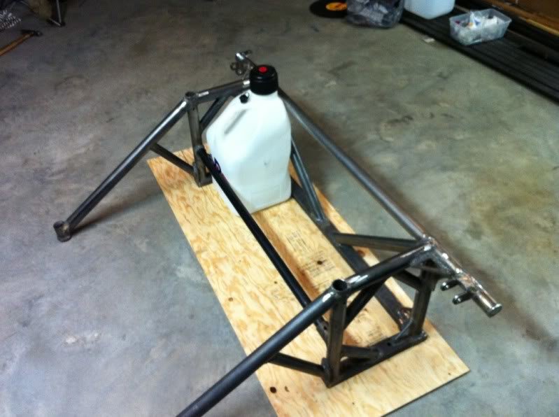

    I built four vertical tubes into my bed cage design, two up front and two out back. My rack is two double T posts (TT) that slides into those tubes. It is height adjustable and rock solid since it uses the bed cage as its base.
    Back tubes:
    You can see front tubes here:
    6CBB6DB2-CCB4-4703-ABBA-2B5A1A71D8FA-251_2d034a4adca2e2555e636abe6dbad102abdc6a40.jpg
    I used to have the tent mounted to a steel frame that I would bolt to the supports but now I just mount the tent direct to the supports. Saves weight
