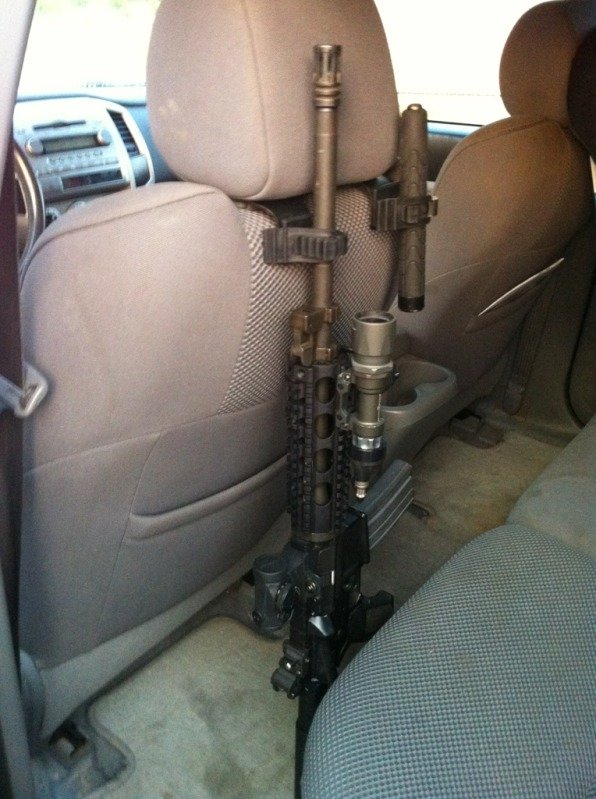

    Built this rack today for my AR-15. Would work with other compact long guns and I already have a second design in my head that will be more flexible for different size weapons.
    Holds two 16'' AR's or similar weapons (or any object that will fit in the mount). Benelli M2 would not fit (handguard extends too high), but I will build another version of the rack that will have some adjustability.
    Mounts to the headrest, goes on and off in seconds.

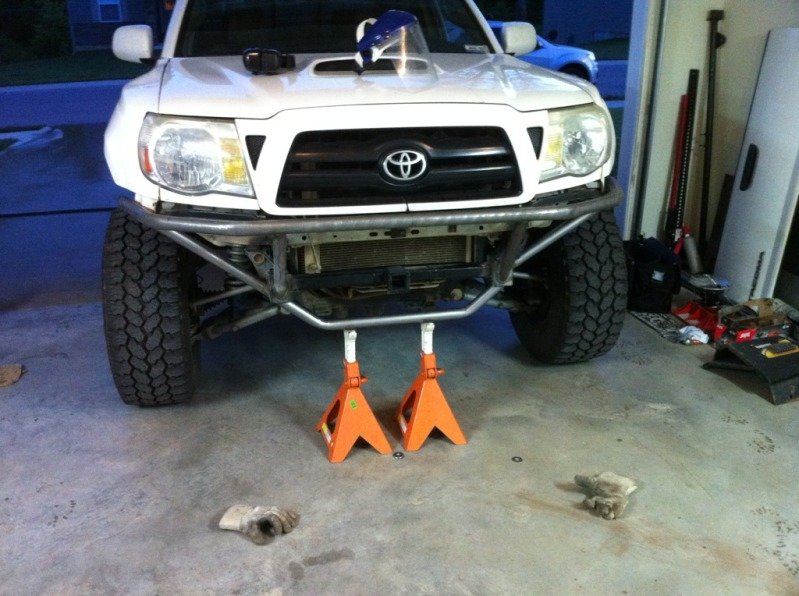

    Built a plastic backsplash for the bumper

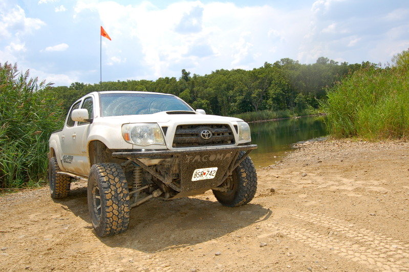

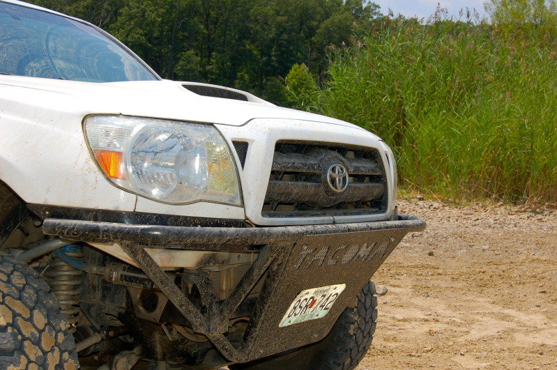

    More bumper pics:

    Good looking front bumper.
    Is the crossmember cut? I can't tell from the pictures, looks like it might be.

    The front most crossmember was removed and trimmed up to the level of the frame, which was then plated. A hidden hitch is welded between the frame spars, which acts as a recovery point (winch mount - remove license plate to access) and a higher clearance cross member.

    This shows it:

    It is a very good looking design.

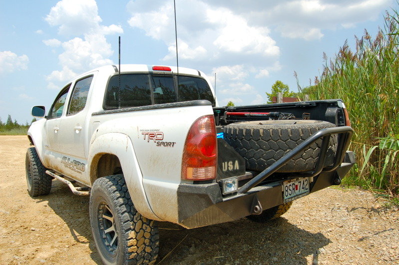

    really liking your rear bumper/tire carrier set up
