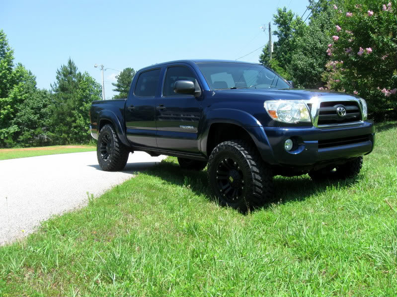

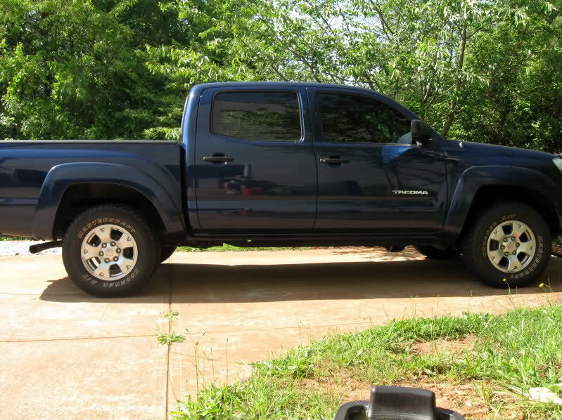

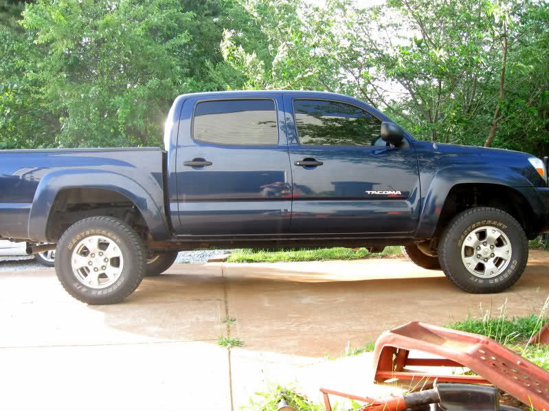

    Well, might as well start one now. I just got cleaned up after a day of hell. Installed my 2" Toytec AAL's, and my 5100's on all four corners.
    2006 DC SR5 4x4
    Modifications
    - TRD OR Wheels from factory
    - 255/70/16 Mastercraft Courser AT2's
    - 2" AAL's from Toytec (Non-tsb)
    - Bilstein 5100 Shocks all the way around (Front set at 2.5" of lift)
    - Front tint to match rear
    - Jensen Flip screen head unit (DVD, MP3, & Ipod hookup)
    - K&N Drop-in Air filter
    Before AAL's and 5100's
    After 2" AAL's and 5100's set at 2.5"
    More to come, maby? Definitely larger tires when these Matercrafts are done (another 50k miles)

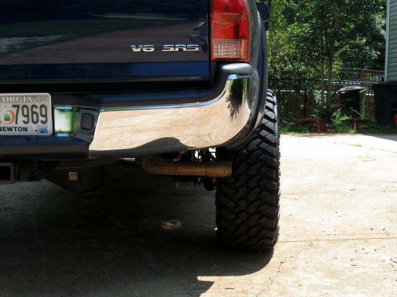

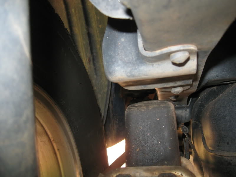

    Sorry she's dirty, its pointless to wash when the pollen is like it is. Here's a before and after look at my bump stops to frame gap.
    Before
    After

    So I guess you figured it out! :D Looks good!

    that looks GREAT! did you take any measurements, before and after? i didnt on mine. still kicking myself.

    I freaking did!. . . but I lost the damn paper I wrote it down on. I do remember the new measurements,
    Rear Center of wheel to fender is 24.5" (approx)(I think)
    Front Center of wheel to fender is 23" (approx)(I think)
    hoping the rear will settle a half inch or so.

    Would you say your truck is about level or is the front slightly higher than the rear?
    It's a bit hard to tell from the pics.
    I've got a 2" AAL from Toytec (no TSB) on my truck and the front set at 1.75" and I feel that the front is a bit too low for my liking.

    Actually the rear was higher than the front at first (more than I wanted). But, now that the AAL has settled it looks perfect. Definately go 2.5 with a 2" AAL

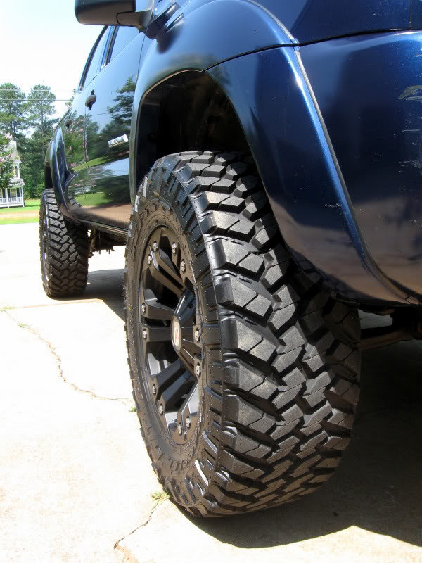

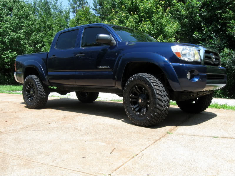

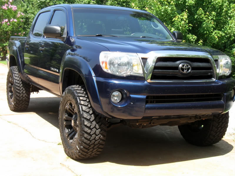

    18x9 XD Monsters wrapped in 285/65-18 Nitto Trail Grapplers :D

    sweet looking truck!

    love those rims, looks great
