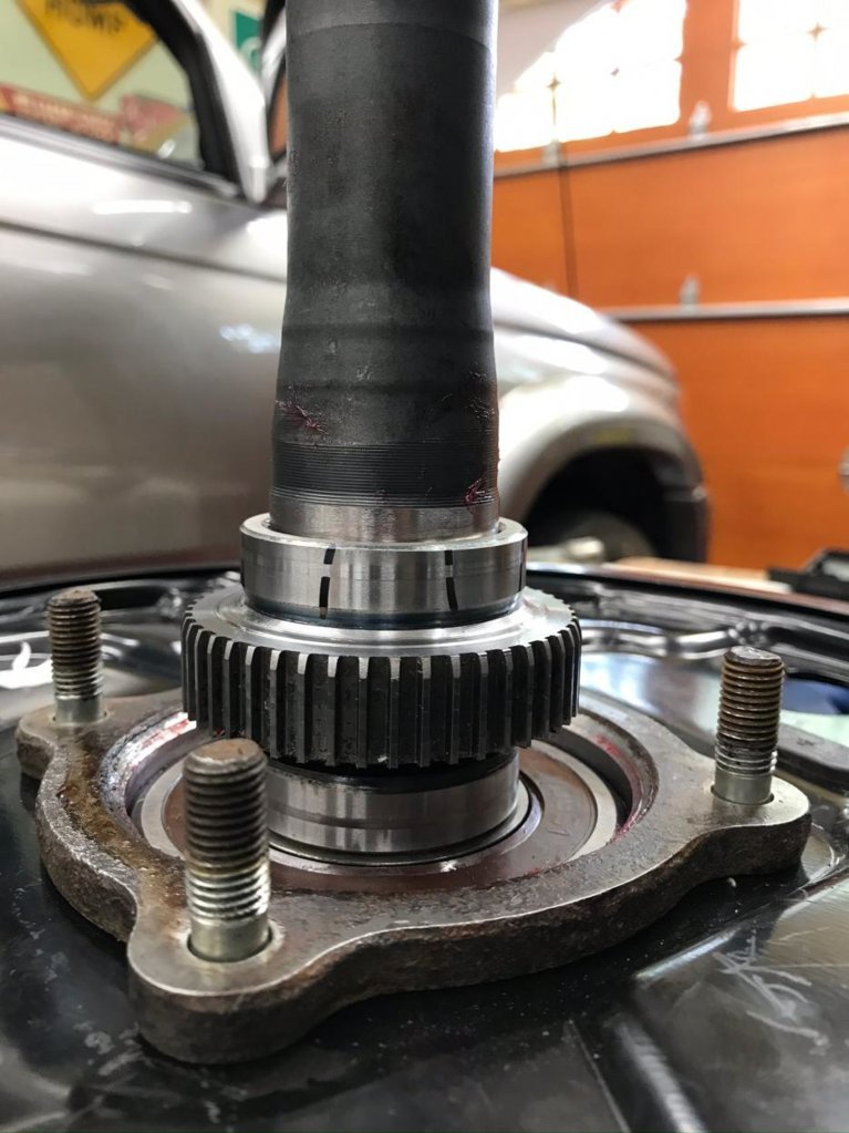

    as stated in below post.....always check the 'breather' for clog 1st....
    that'll rarely be it tho....just the easiest to fix....
    However beyond that seal design changed about 10 yrs ago
    now you have to set that set ring so the seal straddles it in perfect center
    https://www.tacomaworld.com/threads/rear-diff-fluid-leaking-out-of-rims.865521/#post-30833620
    You cant just do it blindly anymore......you have to 'test' where that seats on the retainer ring
    most just reverse that ring so its taper points outboard (pic below), giving a larger usable seat area.... 5BBE7060-0D69-4606-853E-EE6B82F9D412.jpg
    can see on the above pic.....if they didnt reverse that ring....edge of the seal would have been really close to that bevel
    best fix would be if they got rid of the bevel.........
    ......evidently the new seal is still able to set against that edge without trauma....
    A lot of non toyota mechs will screw this up....
    if you screw it up.......no worries......you just get to do it again in 10K ~ 20K
    practice makes perfect....
    grease test or marker test takes less than 10min
    4 runners been going thru this for a long time....they're the ones who first alerted about the newer seal's shorter stiffer lip...
    and the ones who developed the reverse ring fix(Mr coffee mod) and grease test
    Timmy does the grease test at the 57:00 mark
    Toyota Rear Axle Seal/Bearing Replacement (ABS Rearend)
    obviously if the axle is rusty or pitted......the ring itself may get undermined
    a very good reason not to drive thru deep water....

    Actually its that ring that the adjustable part....tiny amount
    you could actually have a machine shop press out the axle(s) initially with the ring./bearing...
    .....jerry rig a pipe and tap it back together.......if you had someone to pull it apart
    only special tool then is a reverse pliers for the large cir-clip(s)
