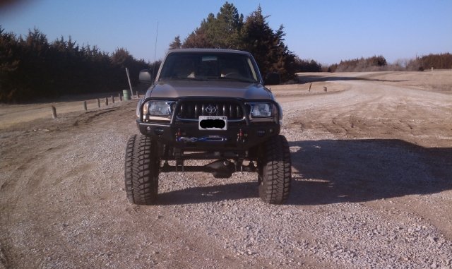

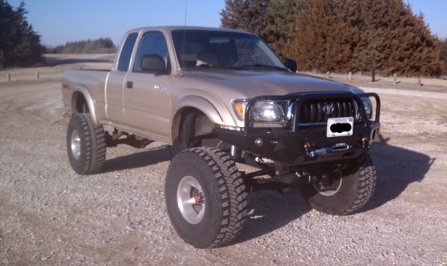

    b8fd439b-42a8-4864-adb0-0205f5fc5ff6_zps_1148fbb97b7debe8599564f33eb4b220e523a62f.jpg
    031cda83-efe9-4c42-b531-6f3b5a818634_zps_d1f3a47c94cb2a21d7d492f032658b348364fef2.jpg
    9a7bc2a5-c2e4-455e-a0ef-9eadcaca66e1_zps_5e706136260c741a655f60c9543c10d6ef867c89.jpg

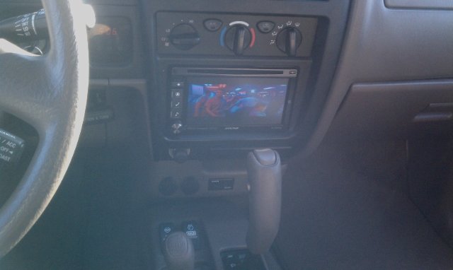

    Head unit and ARB compressor and locker switches fwd of the 4x4 shifter

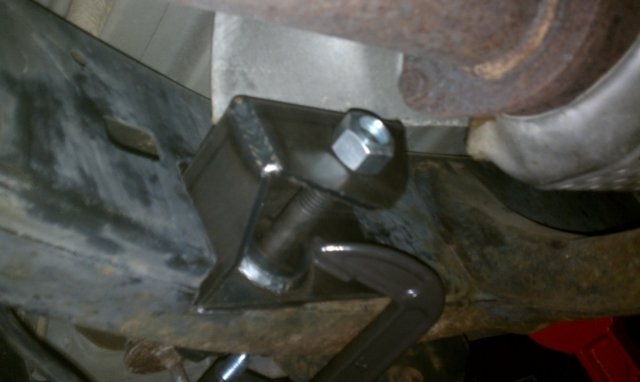

    Setting front shackle mounts

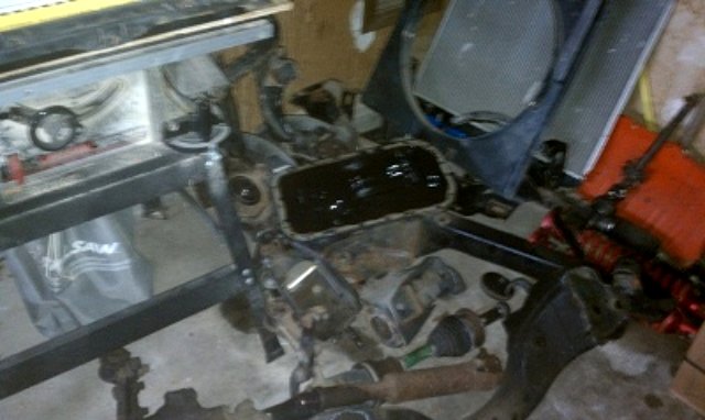

    Pile of old parts

    Hey, just wondering what you painted the frame with after all the grinding down and re-welding of the shackles? I have rust issues on my '01 and need to re-weld the inside of the frame rails. Just wanted some advice on what to paint it with after all the welding is done. I've heard of folks using POR-15....but seems pricey (at least in my neck of the woods...).

    Just a couple coats of primer, then a coat of heavy duty undercoating.
