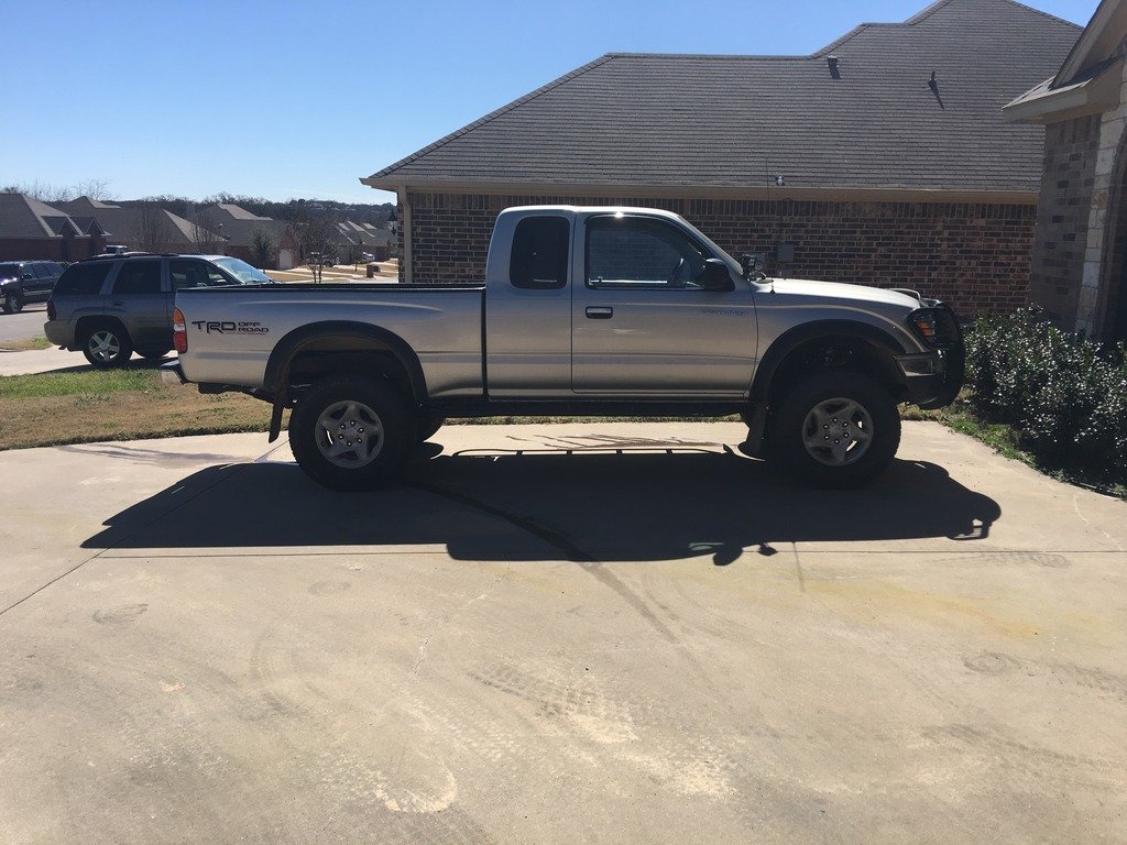

    Got the truck all aligned and the exhaust re routed and tucked up a little higher.

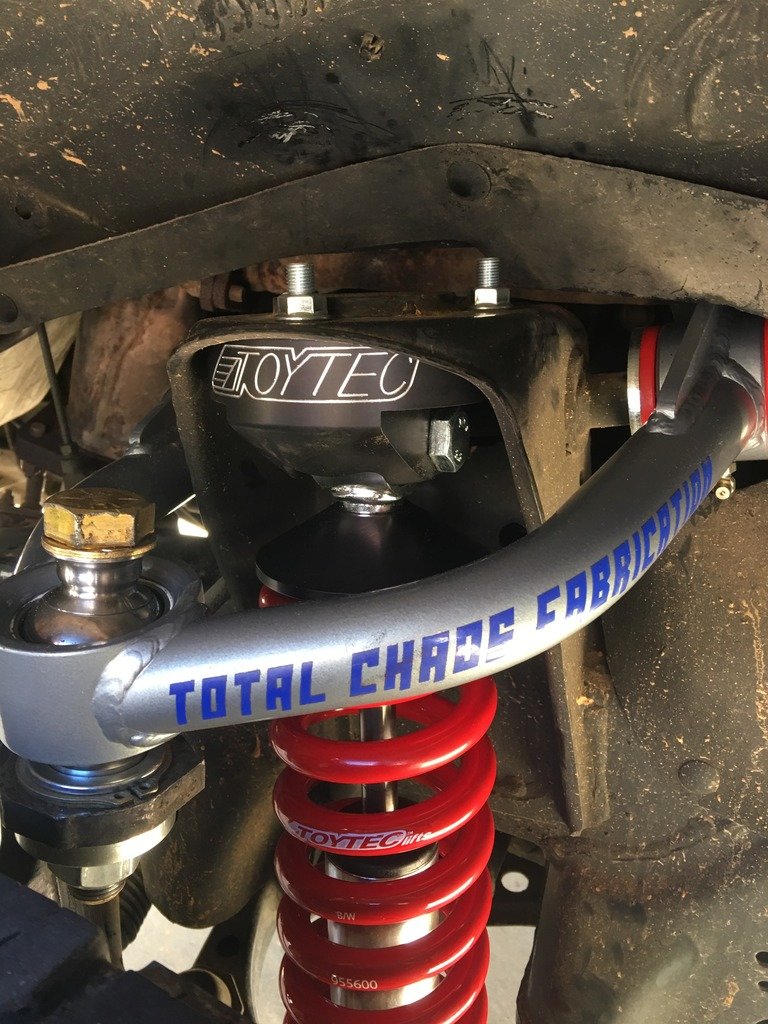

    Little shot of the total chaos UCA and the boss coilover

    2004 Tacoma ext cab TRD 4x4
    CBI sliders, ADS extend travel with compression adjuster coil overs, 9” Bilstein 5125 rear shocks, Icon Tubular UCA, Alcan custom leafs, All Pro Apex bumper and skids, NWTI rear diy bumper, 295/70/17 Cooper St Maxxs and nitro 4.88s.
    Looks good! Did you install yourself?

    220
    Weatherford Tx
    01 xcab TRD 4x4 5spd
    yes installed everything myself. My dad came over and helped on the front, I did the rear alone in my garage. Had I not done UCA's the front would have been stupid easy, but the ball joints were a bit of a pain to remove

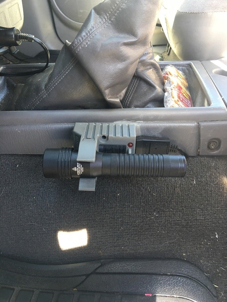

    Installed this streetlight strion charger during hunting season also. Buddy shot a deer and neither of us had a decent flashlight, won't make that mistake again.
    Just JB welded the charger to the side of the console and tucked the wire up under and plugged into 12v outlet. May hard wire it later on, but no real need as of now.

    I had never done this specific install either, but it wasn't too bad. If you have an impact and an air ratchet, a good floor jack and stands (mine are harbor freight) and some general mechanical knowledge you should have no problem doing it. I used the oreilys BJ press w/ their 4wd adapter, there was nothing to put on the stud end of the BJ in the kit that would work, so I held a 7/8 deep socket up to it and marked it the length of the stuff and cut the open end off and this helped center the pushing tool over the BJ

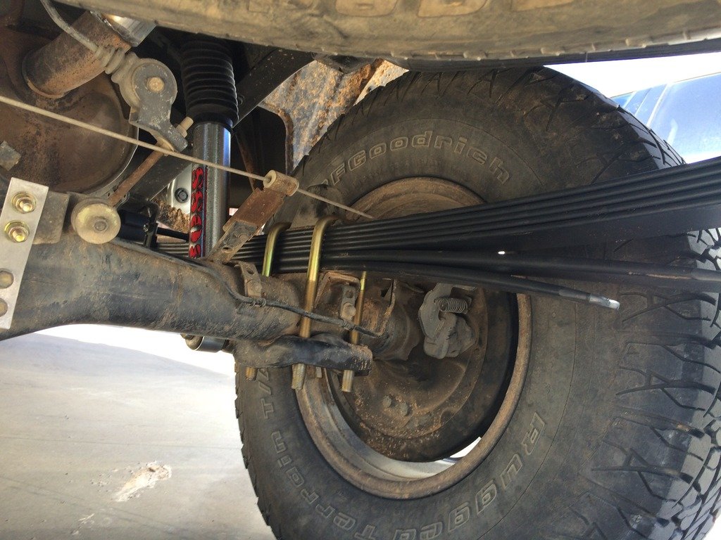

    quick shot under the rear so you can see the full leaf pack and the boss rear shock.
