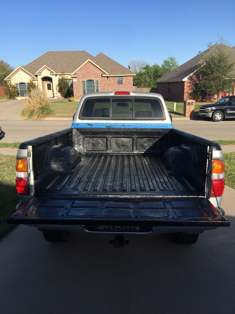

    01 xcab TRD 4x4 5spd
    Got one good layer of herculiner rolled in today. Application is not difficult, but the prep work definitely takes some time. I read somewhere that the roller that comes with the kit sucks, thats pretty accurate. I gave up on it after it came apart not even a third of the way through. I dabbed the rest with the included brush which works well, but takes some time. Ill probably add some more once this first layer is good and dry, i noticed a few thin spots so a second layer will definitely go on.

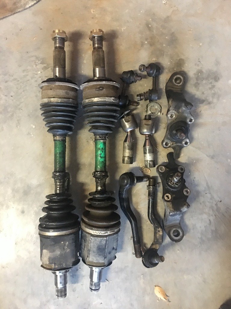

  18. Jun 20, 2017 at 6:51 PM
    #78
    gbollom
    gbollom [OP] Well-Known Member
    Oct 11, 2016
    #199512
    220
    Weatherford Tx
    So this is all I've done on my truck here lately, just some good ol' PM work. Developed a clunk in the front, drivers side I believe, thats been driving me nuts so I basically went on a crusade on the front of the truck. Pretty much everything that had a boot, was torn, and got replaced. Here is a pile of the parts that were removed/replaced. Hopefully this solves the clunk, didn't get to drive it tonight because I didn't want to wake up my infant. Will find out in the morning.
    989FB955-D532-47C7-8529-EC6D14659F84_zps_c52915da738f2697b2114f1983b7763bd1d40f4e.jpg

    Have you checked the lower shock bushings? Mine were worn out and would clunk hitting dips and bumps. Something to check out...
  20. Jun 21, 2017 at 7:44 PM
    #80
    gbollom
    Oct 11, 2016
    #199512
    220
    Weatherford Tx
    They were replaced when I put my lift kit on. I'm now pretty certain it's the body mount bushings.
    The front end of the truck is now much tighter and doesn't drive like a 260xxx mile truck near like it did.
