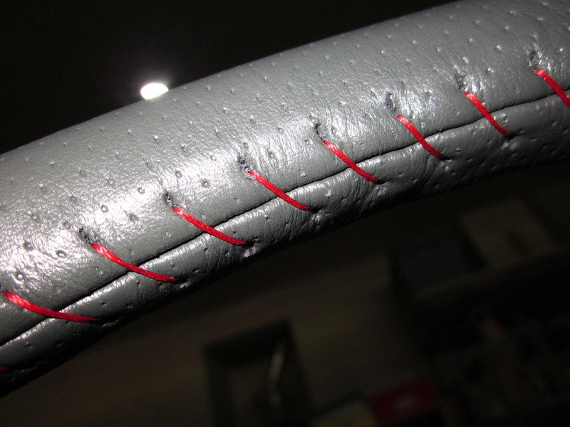

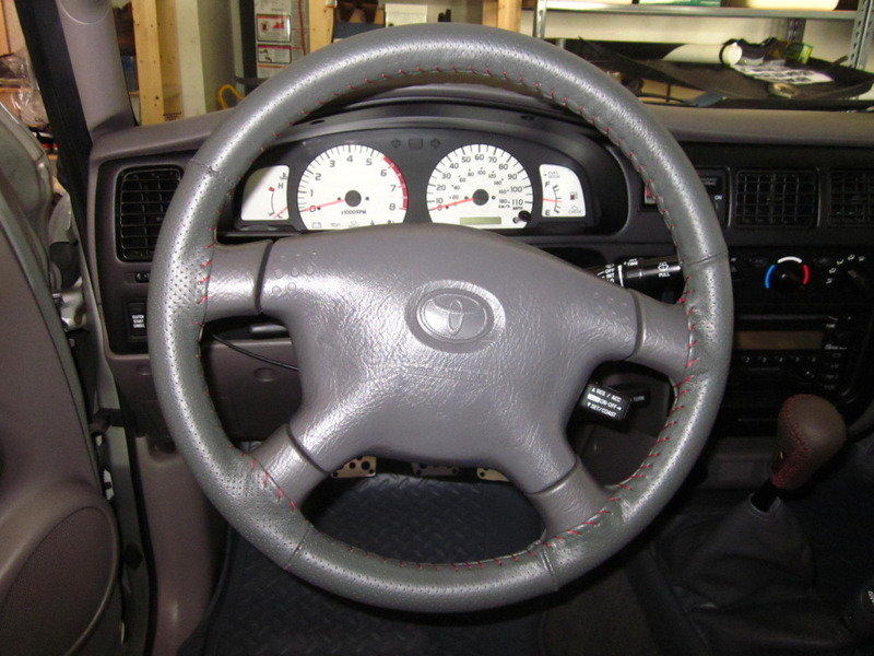

    Red thread for my steering wheel wrap finally arrived. The thread was thinner than expected, so I had to double up on the threading during stitching. This caused me all kinds of issues, mainly dealing with tangles. What a PITA. Took me about 2 hrs, not fun...
    Single threading would've definitely been much easier and faster. Stitch pattern was simple and technique easy to get the hang of. I should've been done in 1 hr.
    Close-up of the stitching. Notice the double thread.
    It turned out ok, but it's not exactly centered on the wheel. Oh well, at least I was able to get the wrap on tightly. Steering wheel feels SO much better now.

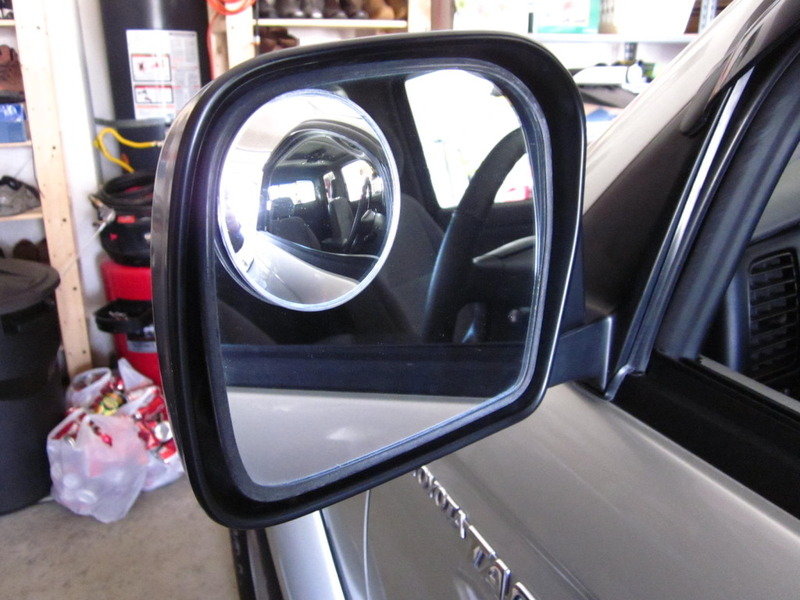

    Since Belle parks outside on the driveway (FJ gets garage), I thought I'd better try and protect my gas. Found a new Stant Locking Fuel Cap (#10504) on eBay for $1. Shipping was a bit high ($7), but $8 total is still pretty good. I love eBay.
    Compared to the FJ, the visibility inside a Taco is like a convertible with the top down. Nonetheless, these 3" Blind Spot Mirrors (Driver & Passenger side) are still a must-have for me.
    I have the same ones on the FJ, so I've become accustomed to them on my mirrors.

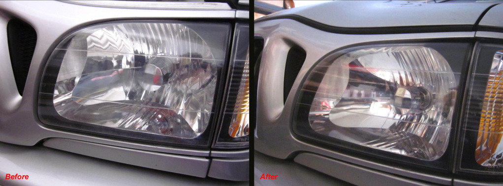

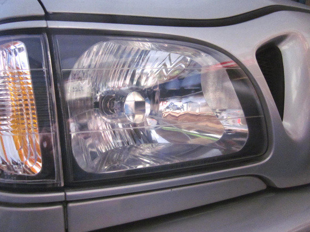

    Belle's headlights looked pretty good for her age. But, there was some hazing and a little TLC couldn't hurt.
    After a quick google search to determine which one was the best, I went out and bought a 3M Headlight Restoration kit from the local auto parts store. Easy to use and worked better than expected. A few more sessions would've made them look even better, but my arms/shoulders were too tired/sore from holding the rechargeable drill.
    Driver
    Passenger

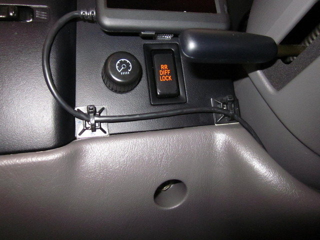

    I finally tidied up the UltraGauge cable with some zip ties.

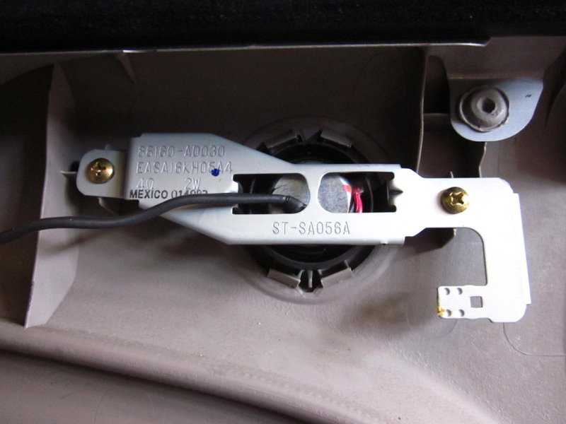

    As soon as I opened the box to start installation, I realized I'd forgotten one important detail - the 5.25" speaker adapters for the doors. Damn it, the 5.25"s will have to wait (Part 2). Oh well, on to the tweeters.

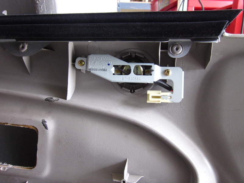

    My only concern regarding the new tweeters was mounting them to the door panel. I was hoping they'd fit inside the door panel with little/no cutting to the panel or OEM tweeter bracket.
    OEM Tweeter/Bracket Assembly

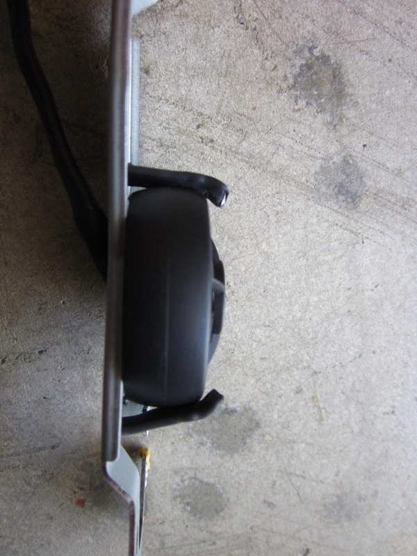

    The OEM tweeter is mounted to the bracket with two screws, but that wasn't possible with the MBQ tweeter.
    After some tinkering, I came up with a simple solution. By flattening both L-Tabs straight, they could basically hold the new tweeter in place.
    I hammered them as flat as possible on my vise, added some heatshrink (to add grip and protect the plastic tweeter housing) and slightly bent the ends inward. Tabs were then adjusted in/out accordingly, to adjust clamping tension.
    MBQ Tweeter/OEM Bracket Assembly
    The new tweeter/OEM bracket assembly fits inside the tweeter pocket perfectly, with no chance of dislodging loose from the door panel. Success.

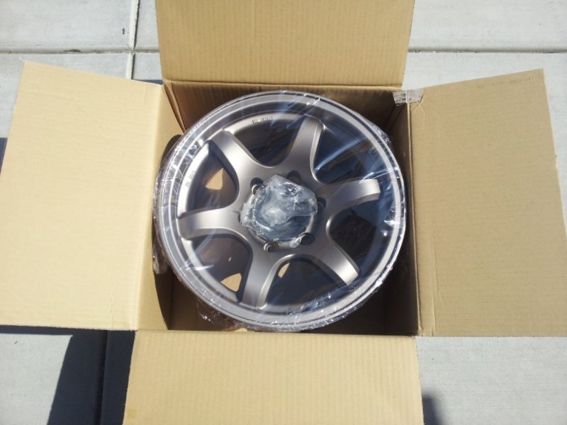

    Picked up my wheels today.
    By paying the balance with cash, I was able to save another 3% :yay:. Not much, but every bit helps!

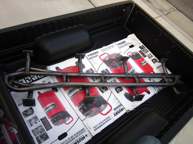

    Bed/roof rack is coming along nicely, ~70% complete. Last major components left are the lift-up spare tire carrier and jerry can/CO2 tank carrier mounts.
    No photos taken, since it was sitting on the garage floor when I stopped by. I have to visit Demello again next wk, so I'm hoping for a better photo opp then.

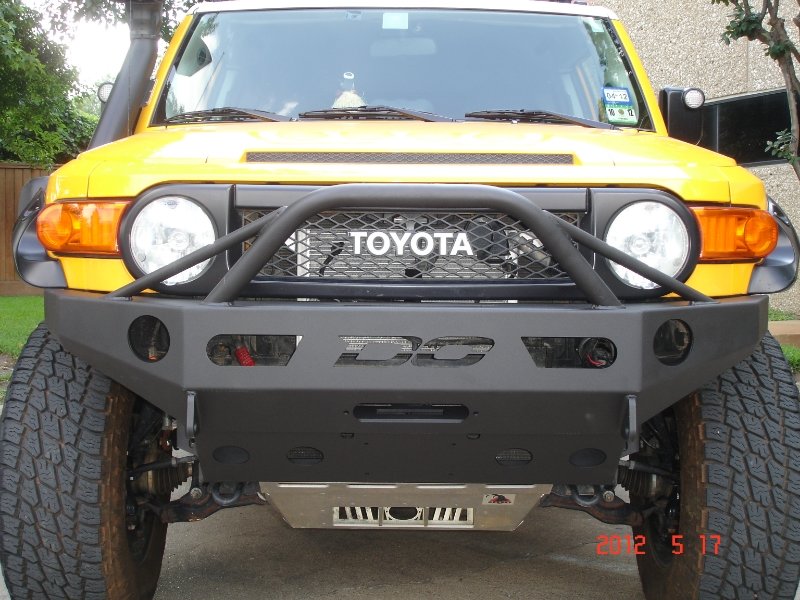

    Meanwhile, I decided on getting Belle a Demello Baja front bumper in aluminum.
    (Image courtesy of Demello Offroad)
    Aluminum costs more, but should pay itself off with gas savings eventually. Total weight is only ~50lbs, less than my FJ tube bumper.
    I went with this particular style hoop to match the FJ. A winch will be added later.
