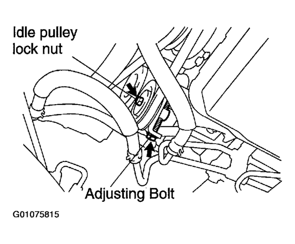

    Here's how to adjust the a/c belt, the picture is from the bottom of the engine compartment looking up.

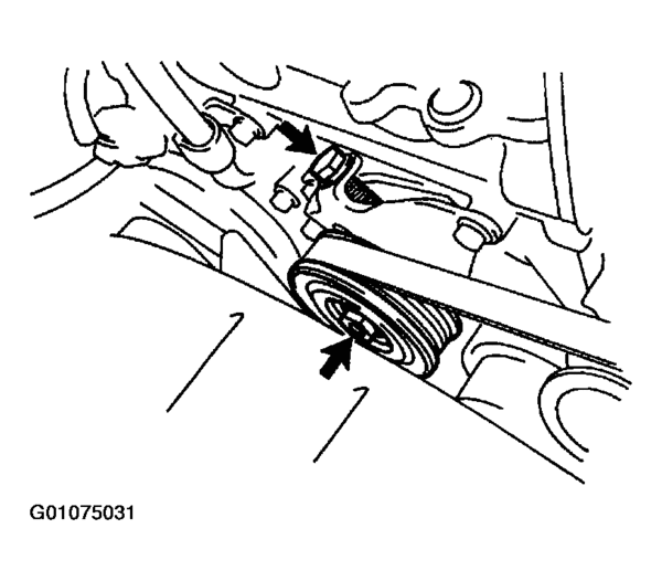

    Here's how to adjust the p/s belt. This is from the top of the engine compartment looking down.
    Chances are you need to replace your drive belts, don't overtighten them or you will kill a bearing or accessory. You might also look into if you need a timing belt since at your mileage it's due for that soon too.

    I already changed the timing belt at 90k, but those diagrams helped alot, i'm use to working on american cars with auto-tensioners. The fluid is a good amber color. I think it's the belts after listening to you thanks!
