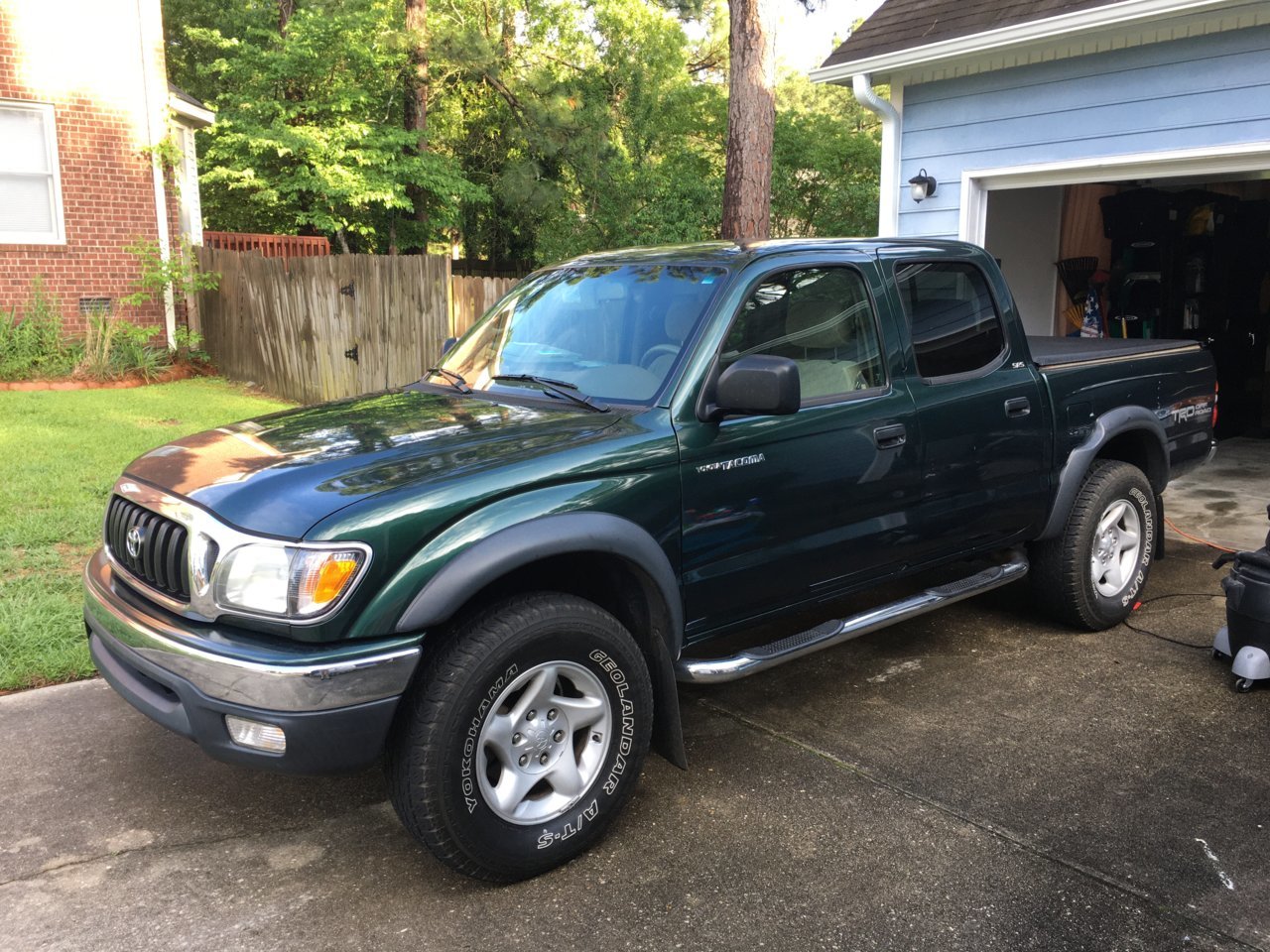

    Original post is bellow. Here's a current pic:

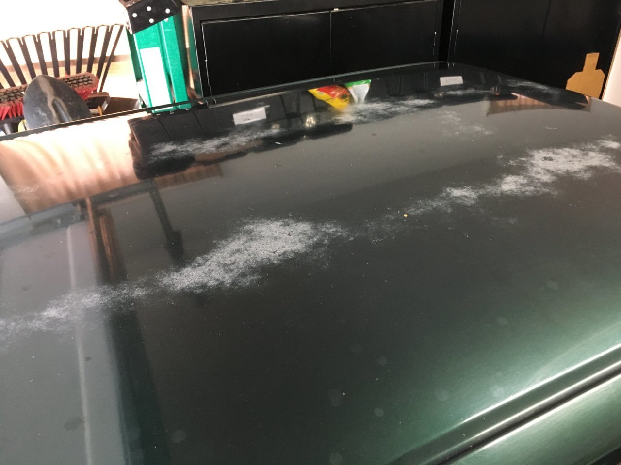

    Hey all! As stated, just picked up my first Tacoma (first real truck actually.)
    2004 PreRunner TRD Off Road
    -184K
    -1 Owner (older gentleman, handed me the original sticker!)
    -Factory upsized wheels, 16"
    -Tow hitch
    -All organized maintenance receipts with list of dates, mileage, on each one.
    -No rust whatsoever.
    $6500!
    Only known issues: Paint will need to be addressed eventually, one bearing assembly will need replacing.
    Already picked up a set of WeatherTech mats, and ordered TRD stickers for them from @CBoy808
    Plan: Get it back to factory like-new. Then a few simple mods/upgrades. Want to keep the factory look.
    Questions:
    1. Can I get someone to re-clear coat the hood/roof? Or am I in for a new paint job?
    2. The fender flares are a little grayed. Is painting them an option for the long run? Or are replacements the best option? Again, going for factory look.
    3. Is there a cheap option/place to get replacements for door seals?
    4. Any other suggestions for a newbie will be well received!
    Thanks gents!

    Hard to tell if the white is just in the clear coat or whether it has gone down through the color. Try some compound and wax first -- if it has gone through the color, you'll need more than just clear coat. Personally, I'd just make sure it is protected with some wax and focus on refreshing mechanical stuff first, then worry about fixing the paint.

    Scuffing and clear coat touch up will buy you some time and better appearance.

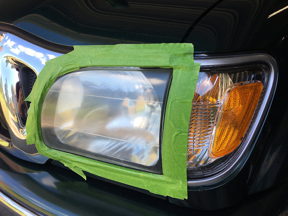

    Just used the Mothers NuLens Renewal Kit on the headlights. Didn't come out "like new" as I was expecting, but still a night and day difference.

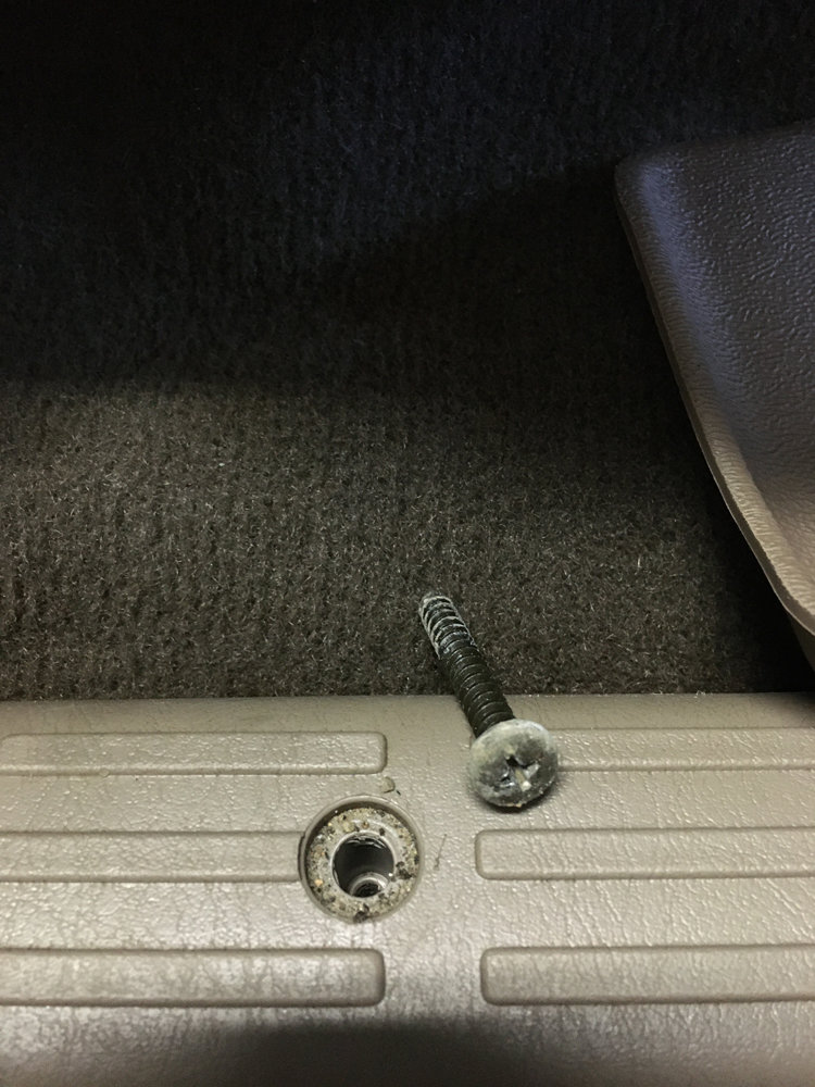

    Today I refinished the screws and bolts in the cab. Took them all out, put them through my ultrasonic cleaner to eliminate the rust (I have one on hand for reloading ammo), used a wire brush attachment on my drill to brush the heads, then put them all through a cold blueing agent to turn them black/dark. Then a quick wipe of a gun oil/solvent for protection and put them back in. Gooder than new! Also took a toothbrush with the same gun oil/solvent to the seat mounts to clean them up some.

    Congrats on the find! Really nice truck and wow the headlights came out really good!

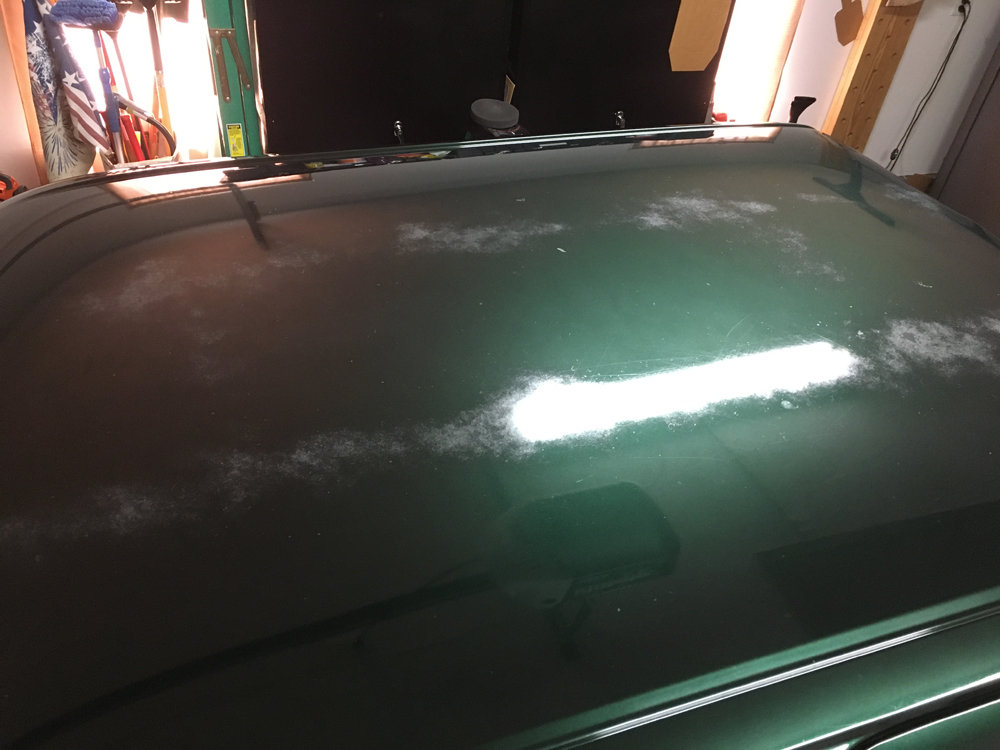

    A friend came over and helped me make my first attempt at fixing up the paint oxidization on the hood and the roof. Polished it with a moderate cutting pad, and finished it off with a...well, "finishing pad." Outcome is not "like new" (how could I expect it to be?). But what a difference! I think I bought some time before taking it to a paint shop.
    Also, this Imperial Jade color is really growing on me. Never hated it, but I thought I'd make the move over to white if I had to get it painted. But I'm really liking the outdoors look of the Jade. Think I'll keep it.
