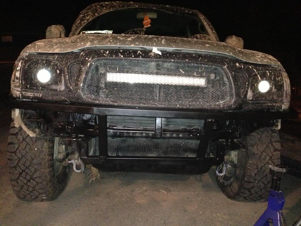

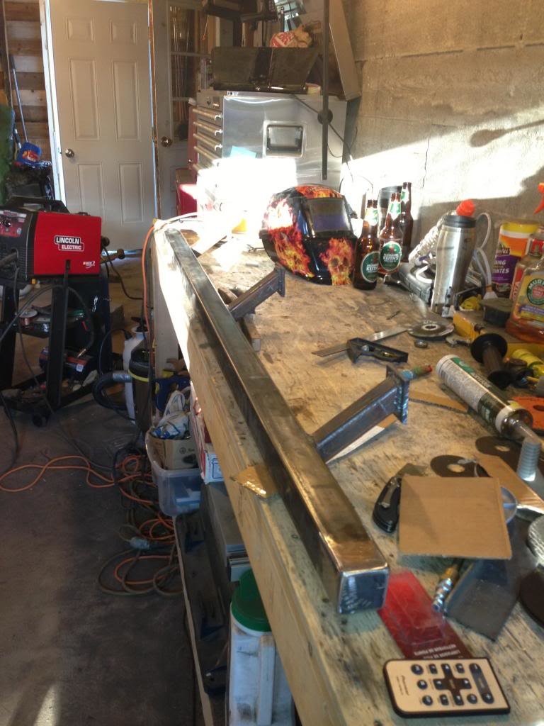

    Finished off the bumper for now
    C2697EAB-0CC5-40BC-9827-825C1A67520F-357_051788eafa275e4b13a7c05abff8f226e8fabd5e.jpg
    46875326-E2E4-45F6-ABE7-6FEA67C17A7C-357_a094bbc33c7a1b9e4a9fe5cf58b26bc2ca646c75.jpg
    D6747FA7-A294-40F6-91CA-169FDF7944E2-357_bc5b260ee23219cc0d176d0e006b3a8fa4d0a852.jpg

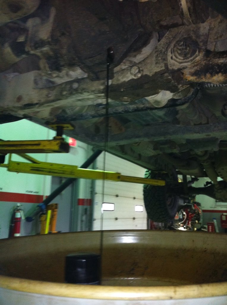

    Changed my diffs tranny and transfer case fluid
    9DB6E363-2C87-4250-849B-361444104F20-357_dee1e13530b7218526a714977c19628c48322b14.jpg
    F4017CC4-7A4B-49BD-865D-480331469C07-357_5c3d0fc3eaf2e222851757041021b4a2ed6ffb6e.jpg
    A4864EE4-88D6-4F93-A930-FFC69CD3F5B0-357_a33b88c975708e19ca775d612c13f79a3c1672f8.jpg

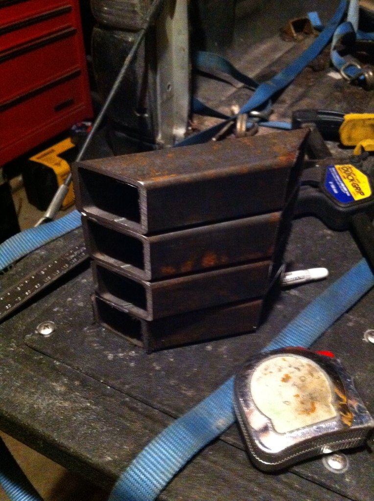

    Started my tire carrier

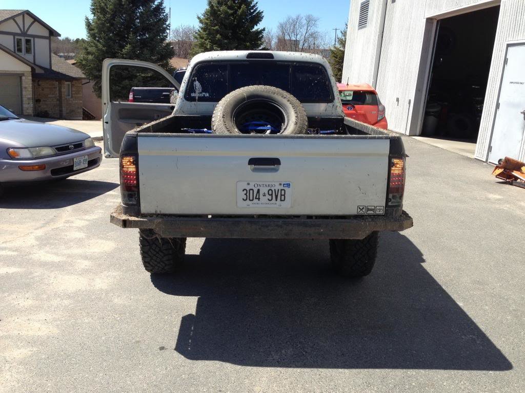

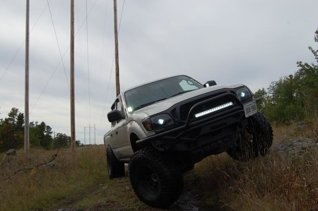

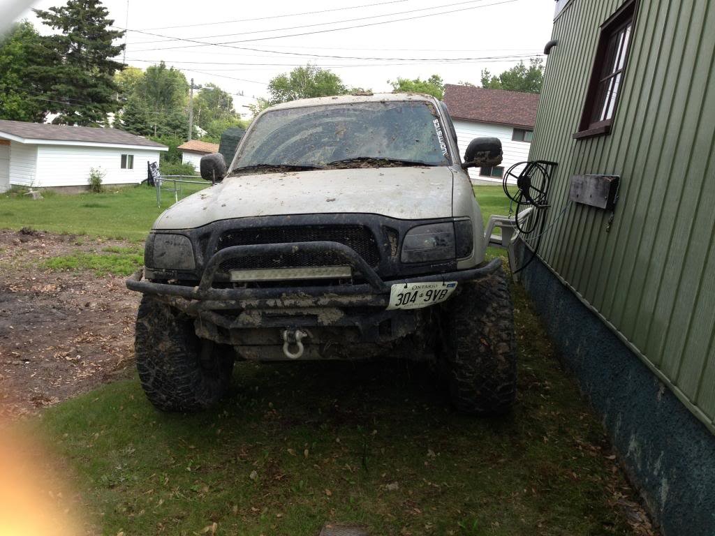

    So.... Giant update. Its been a while, so here we go.

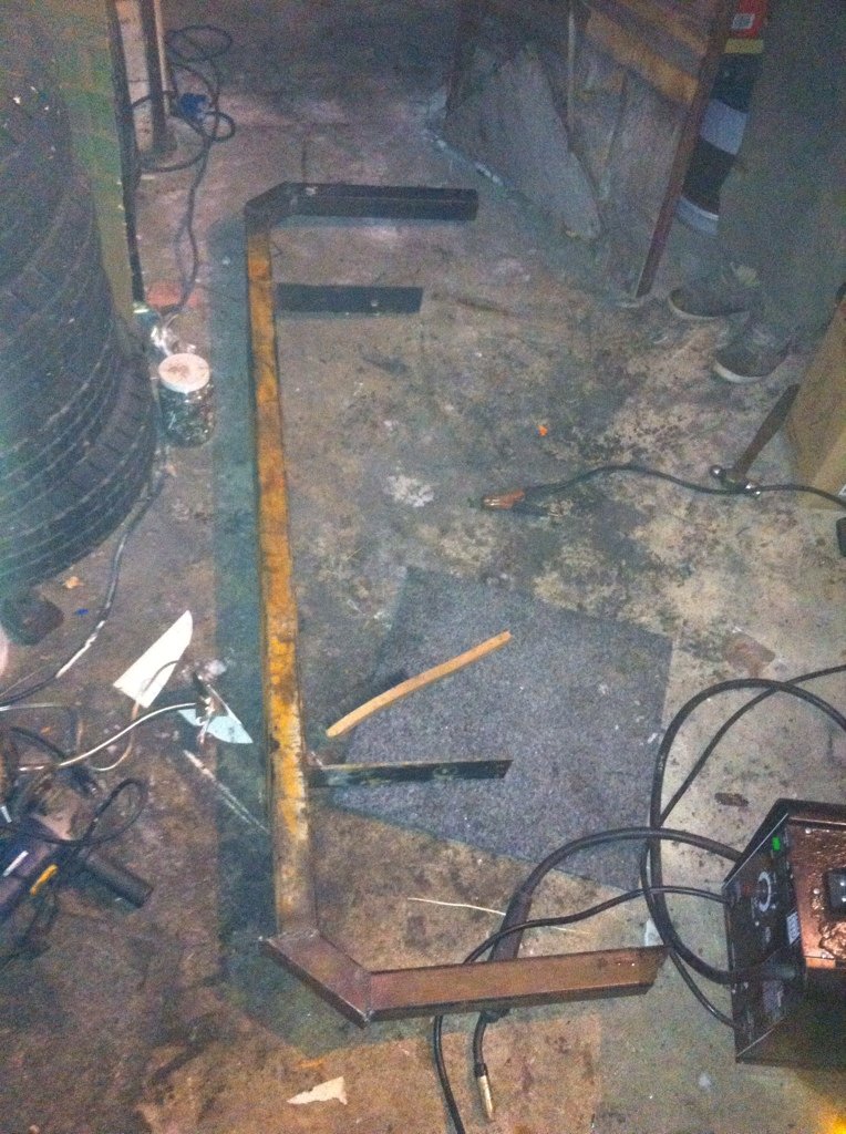

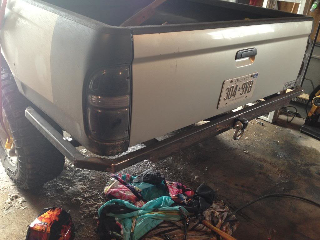

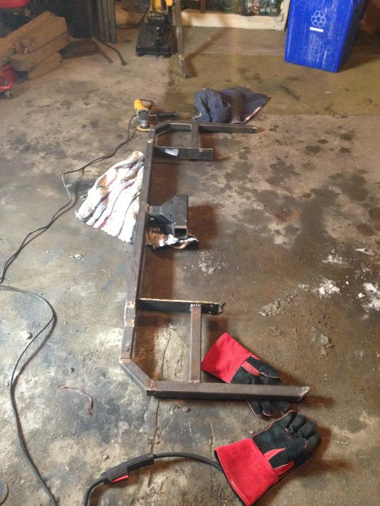

    Ill start with my new bumper, same as my old one but i can weld better and i took my time on this one, and addeda hitch.
    Its been more re inforced now, just no pictures of it, tows both my quads on the trailer no problem! With a 12" hitch... lol.
    After that, I made a temp front bumper out of some 1.5x1.5 tubing

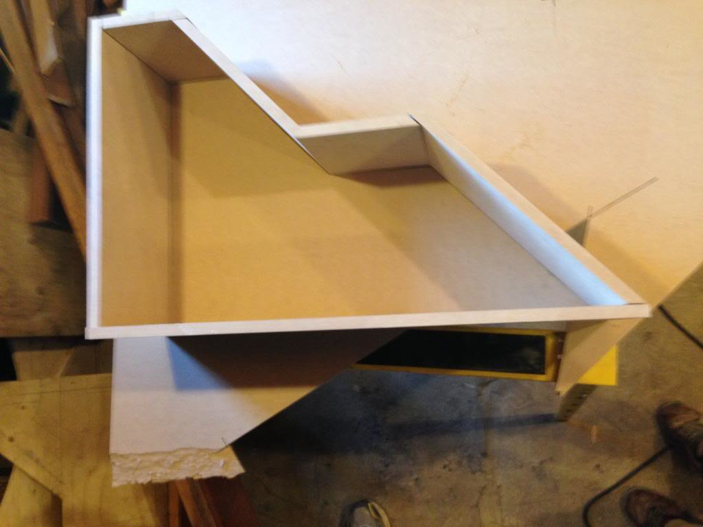

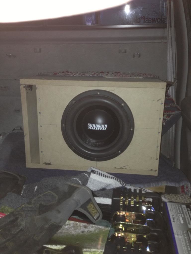

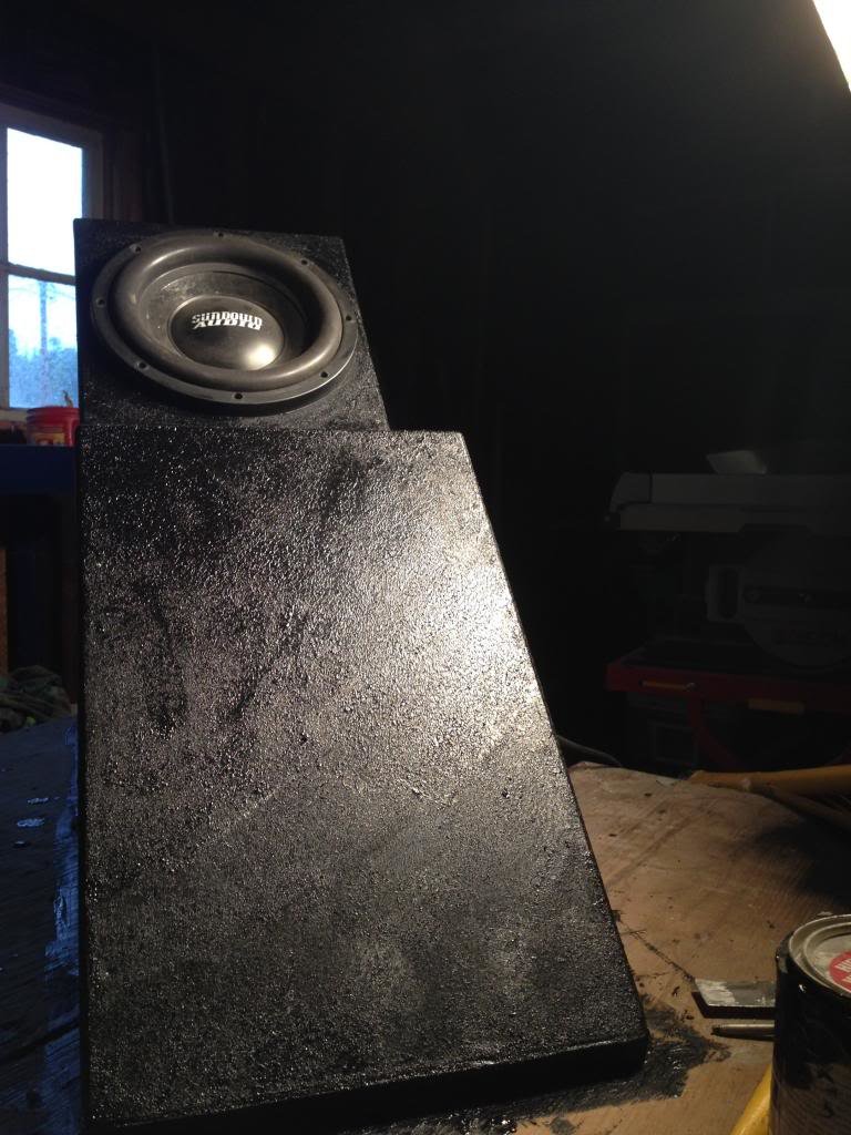

    Then bought myself a sundown sa 10 and made a box for it, ported tuned to 35 hz.
    Then i ordered my lift and tires, among other things.
    Ended up with,

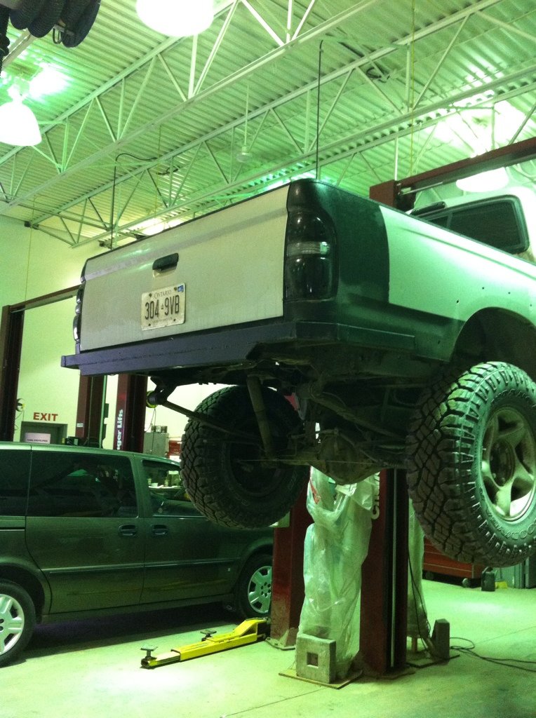

    Eibach adjustable coilovers, 1" diff drop, ubolt flip kit, allpro 3" springs, 5150s in the back, BPV bracket, timbren bumpstops, and im sure im forgetting a few other things. I bought the trail gear front bumper and rock sliders (which ive hacked up to make my own with) and some 33x12.5x15 duratracs, and 15" procomp wheels, and some 1.25" allpro spacers. And i re did my exhaust with a magnaflow, and 2.5" tundra tailpipe made into a rear axle dump with a 3" tip. And some leds tails and smoked corners.

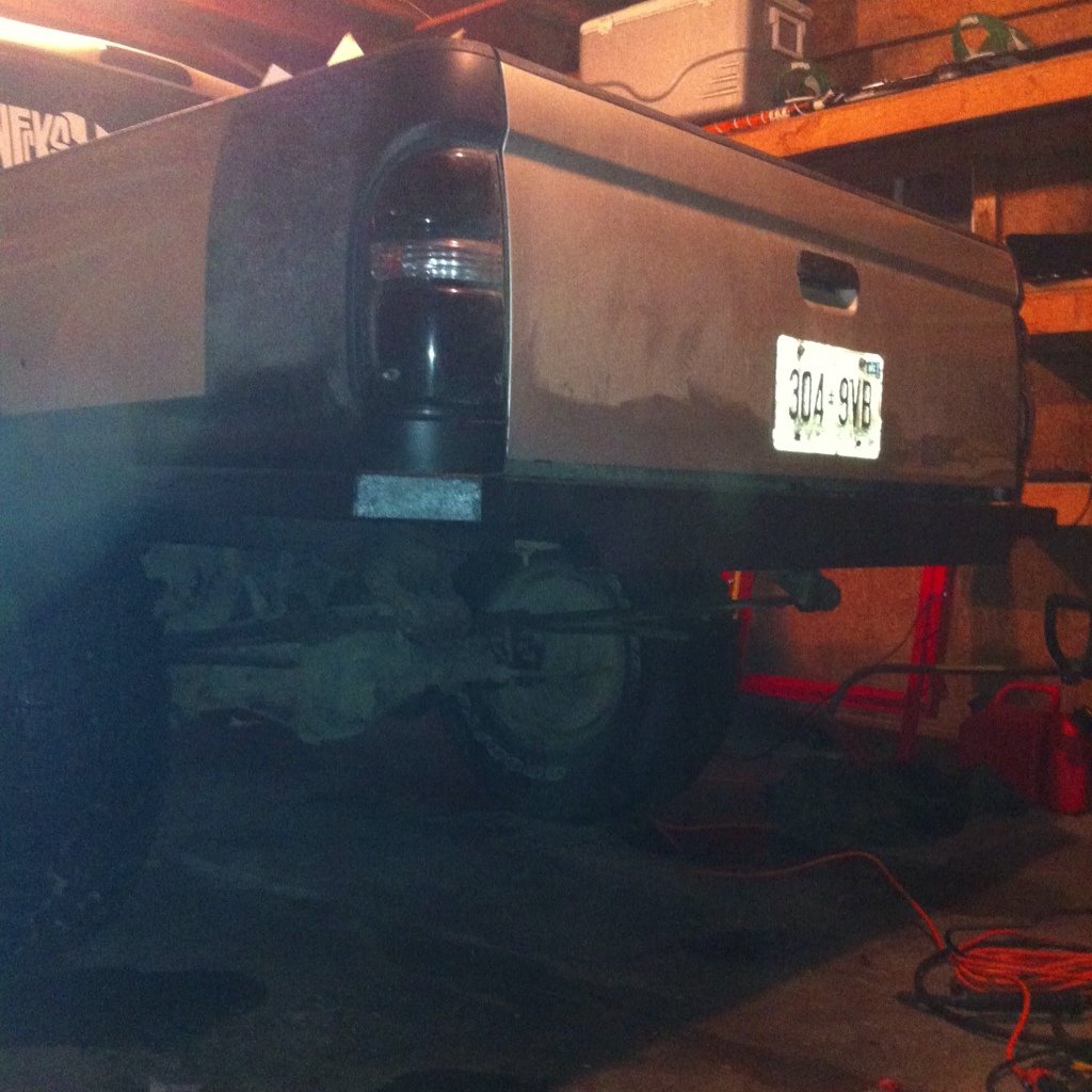

    Tails

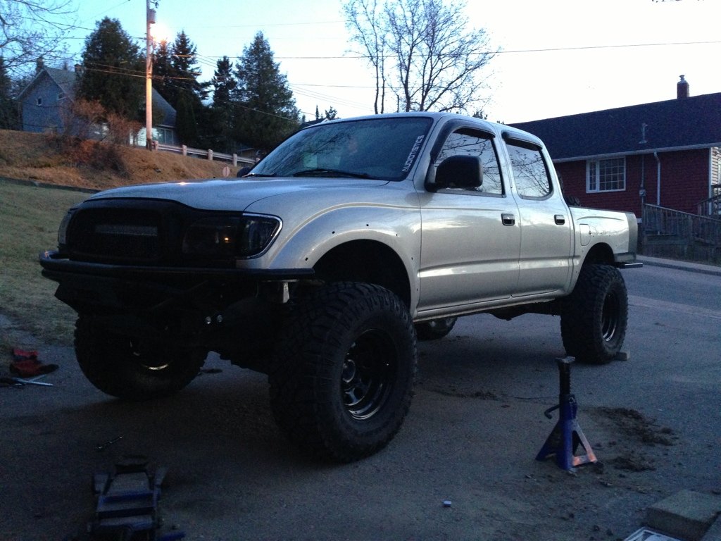

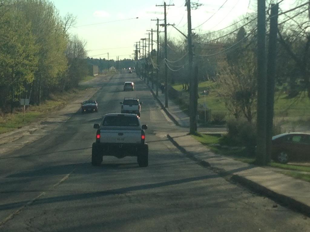

    Just after i got the lift and bumpers in
    308D1944-9840-45C2-9E01-43FD0D480488-104_be6506f82f4497d3687a0f01df9c83ae4cdb9825.jpg

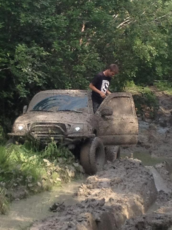

    First trip out :) did better than all the chevys out there! lol

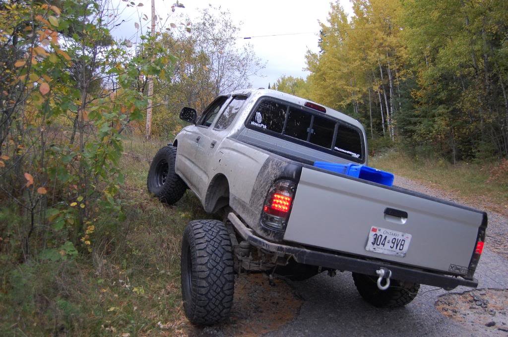

    IMG_1689_zps0ba13eb6_5ed8e074f6f79b1618413a71ca2079a0fd3251ae.jpgIMG_1699_zps547be9da_1a6382837a936ac31a414c574795dc86bd4c372c.jpg

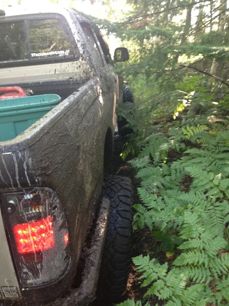

    Rear suspension and exhaust IMG_1701_zps564ee296_693ec444b1c2d9cd217058576c8ca17efed7131f.jpg

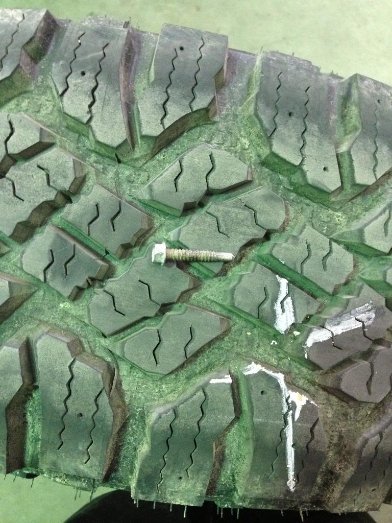

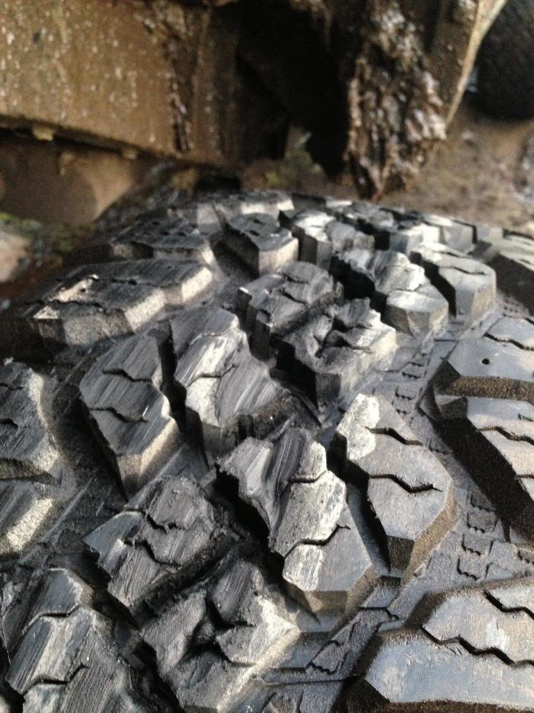

    100 miles in and first screw IMG_1758_zps39e485d5_aaf3cf81904067471e1944bf0a4f89c7a6be4332.jpg

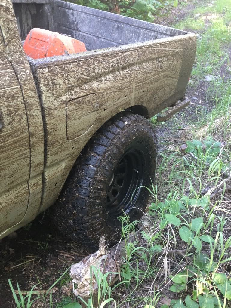

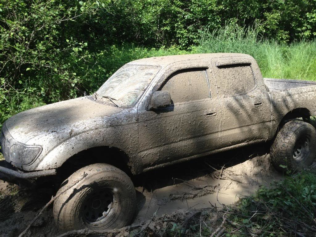

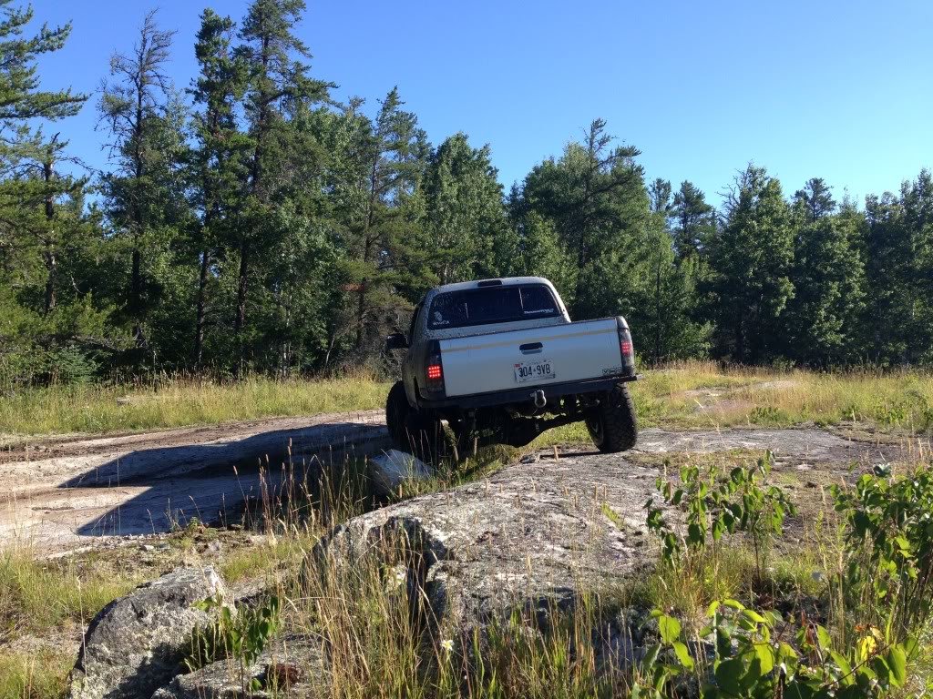

    150 miles and came out of a trail to this IMG_1928_zpsf15f1a93_24b08d73a0877a1e9c73af4b71f7c17cb71c38c9.jpg

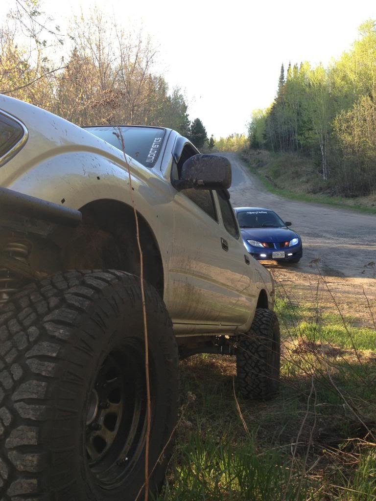

    Second trip out (one of 5 trucks in town to make this loop)
    Made it out of this myself, just stopped for a pic
    31" duratrac on the yota, normally 40" swampers lol

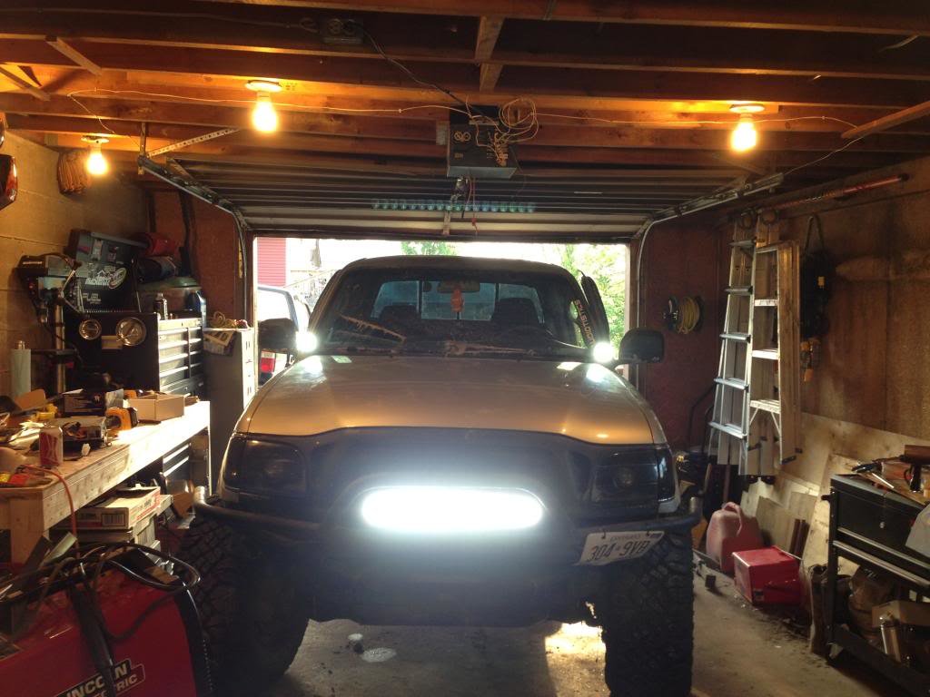

    Got my Rigids on

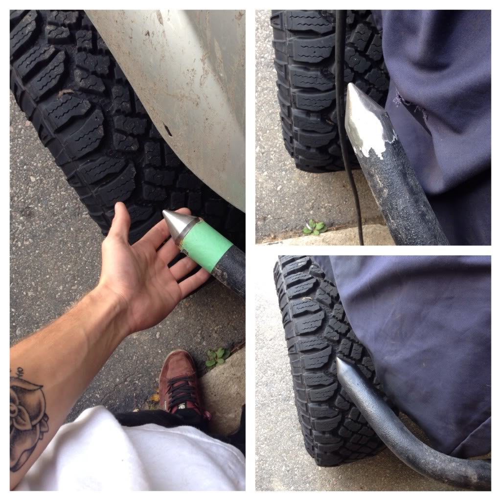

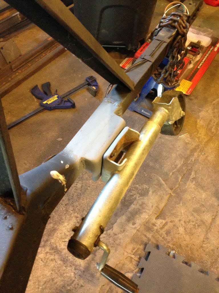

    Putting a custom jack mount on the trailer (for a customer)

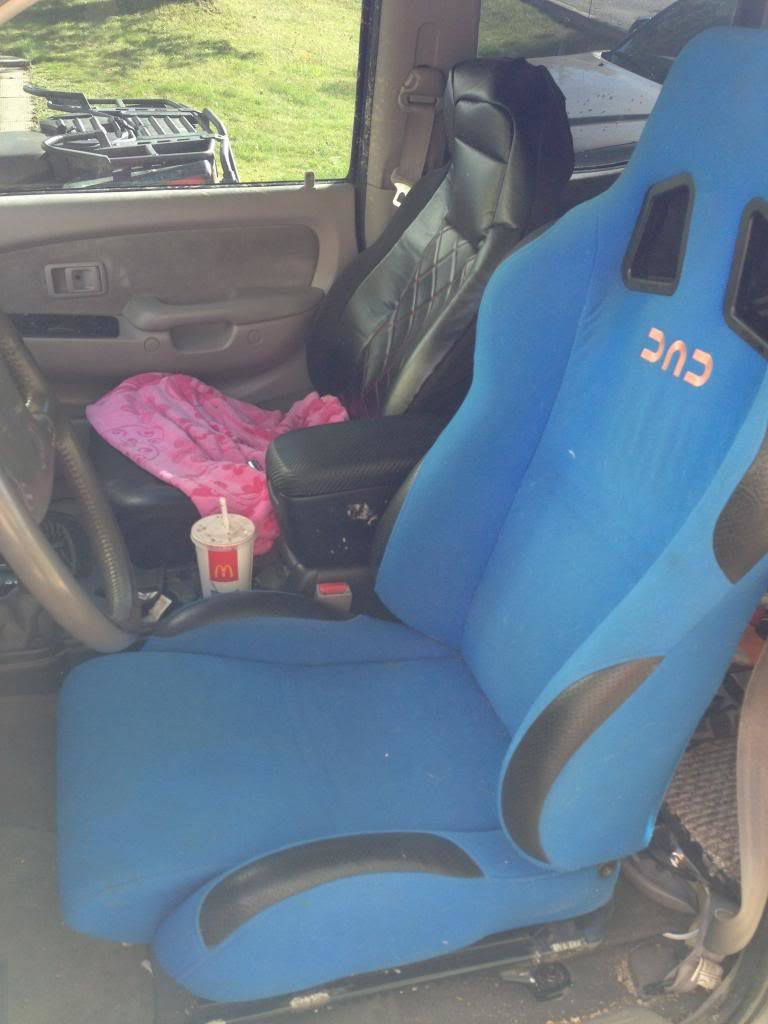

    NOW for the interior stuff... picked up some CNC racing seats
    Got one in the truck
    Then both

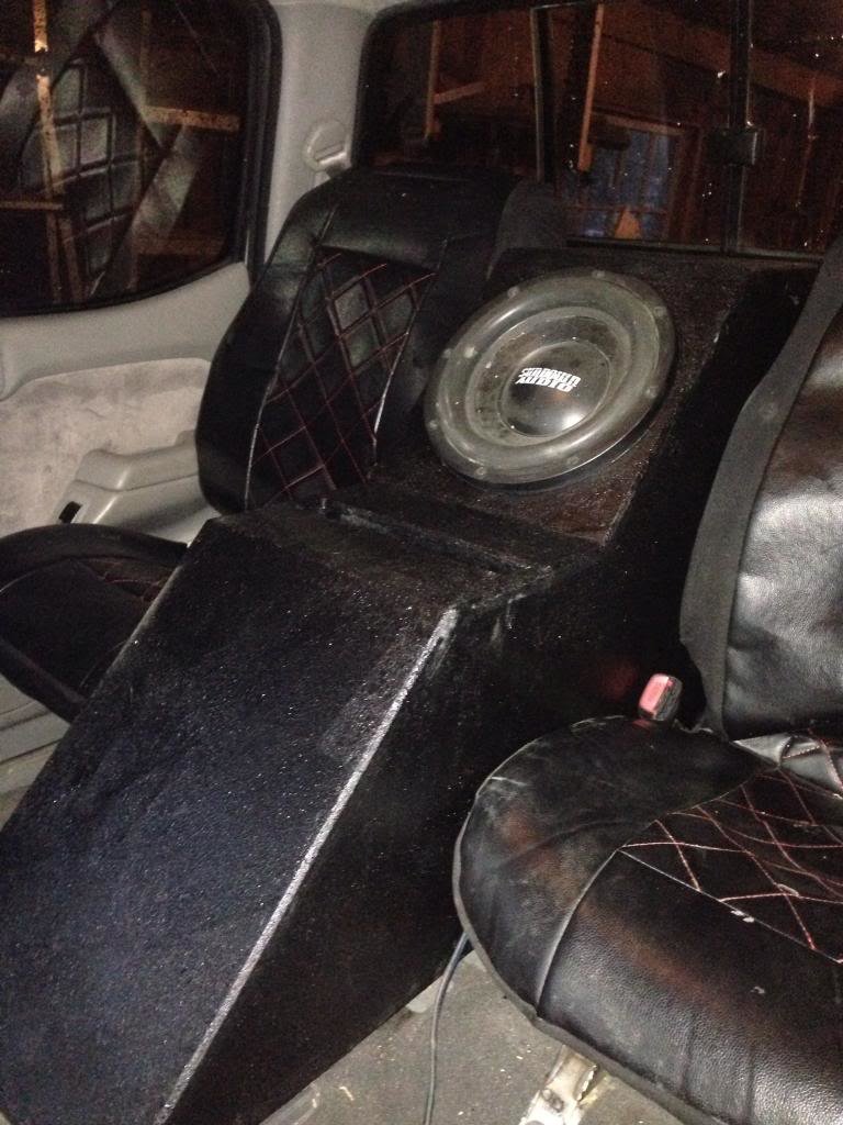

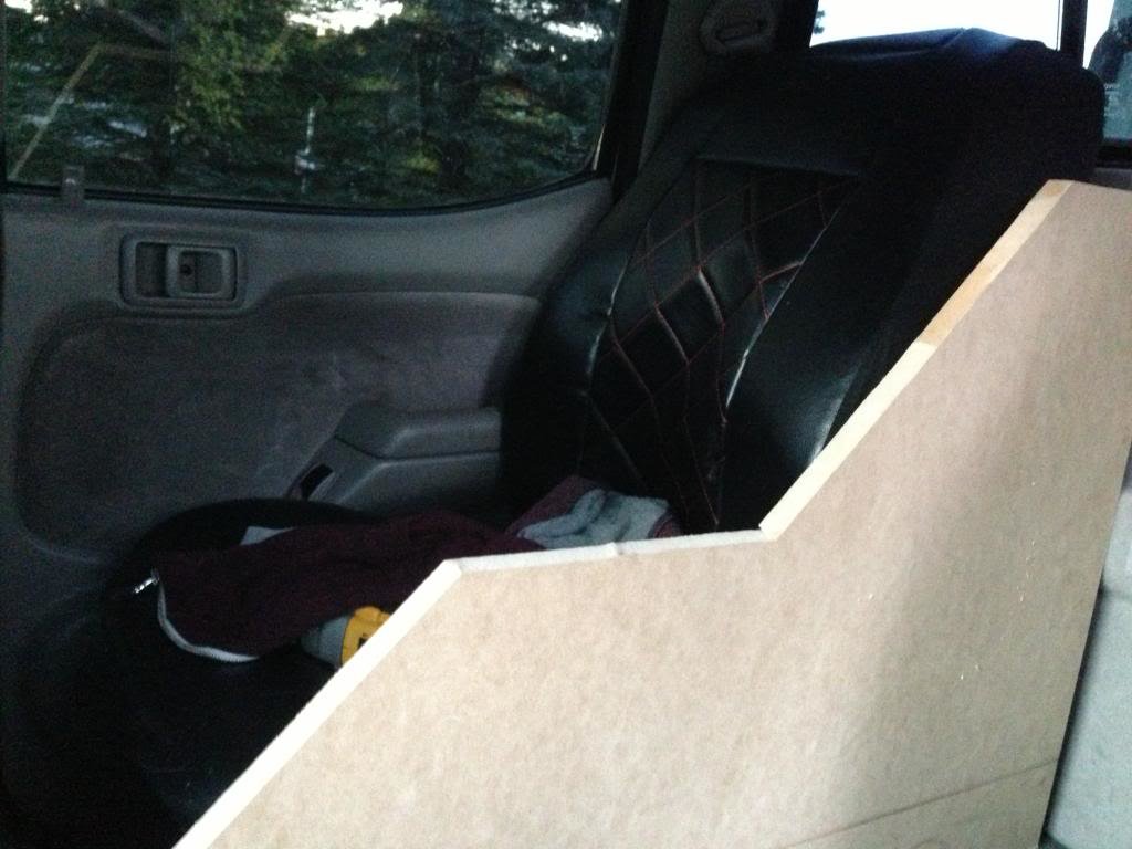

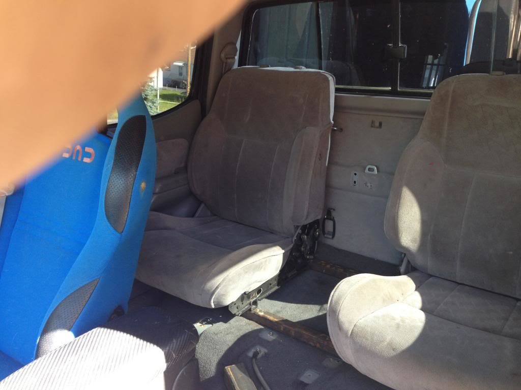

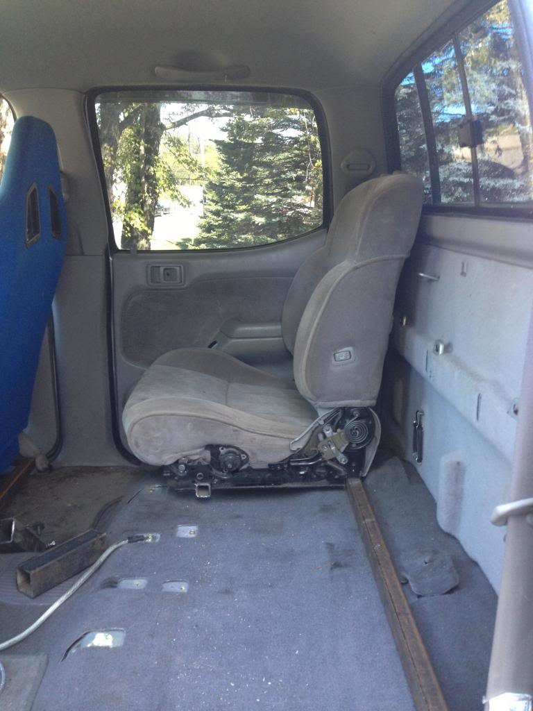

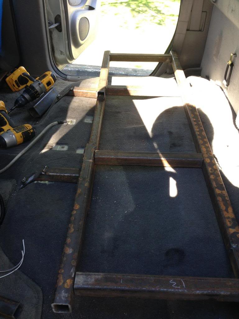

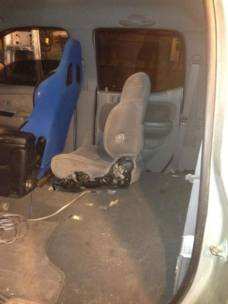

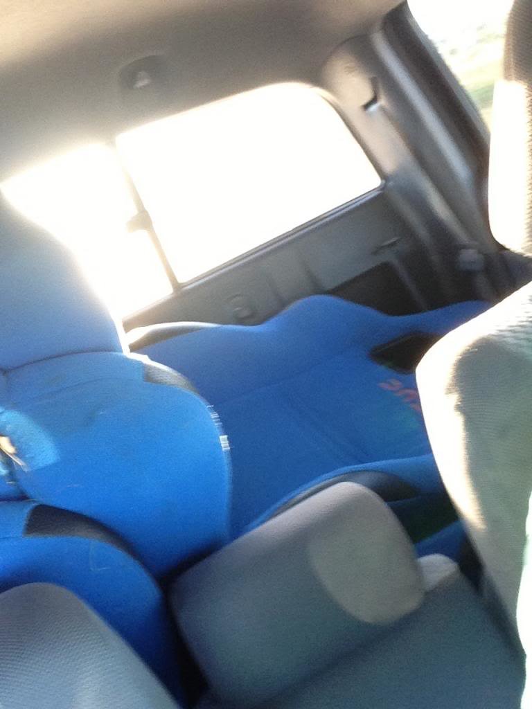

    Now for the fun part... I had no seats in the back, so i decided to make good use of my now useless old front seats, and put them in the back. SO heres pictures of the whole process. Im so happy with how it all turned out!!
    Got everything cleared out, mocking up placement
    Getting the seats notched out and rails kind of in place

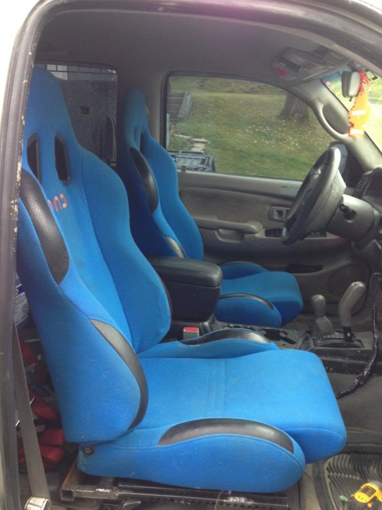

    First time with both seats in

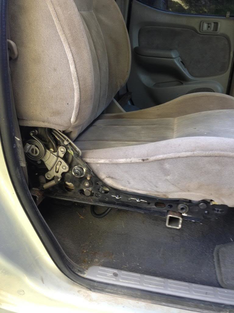

    Seat rail all tacked up, it mounts in all 6 factory locations.
    And after that i forgot to take any more pictures.. whoops. But i decided i wanted a new sub box since my old one looked stupid in between the seats, so i started mocking things up.
    Stopped and got a tattoo for my grandma who passed away in march

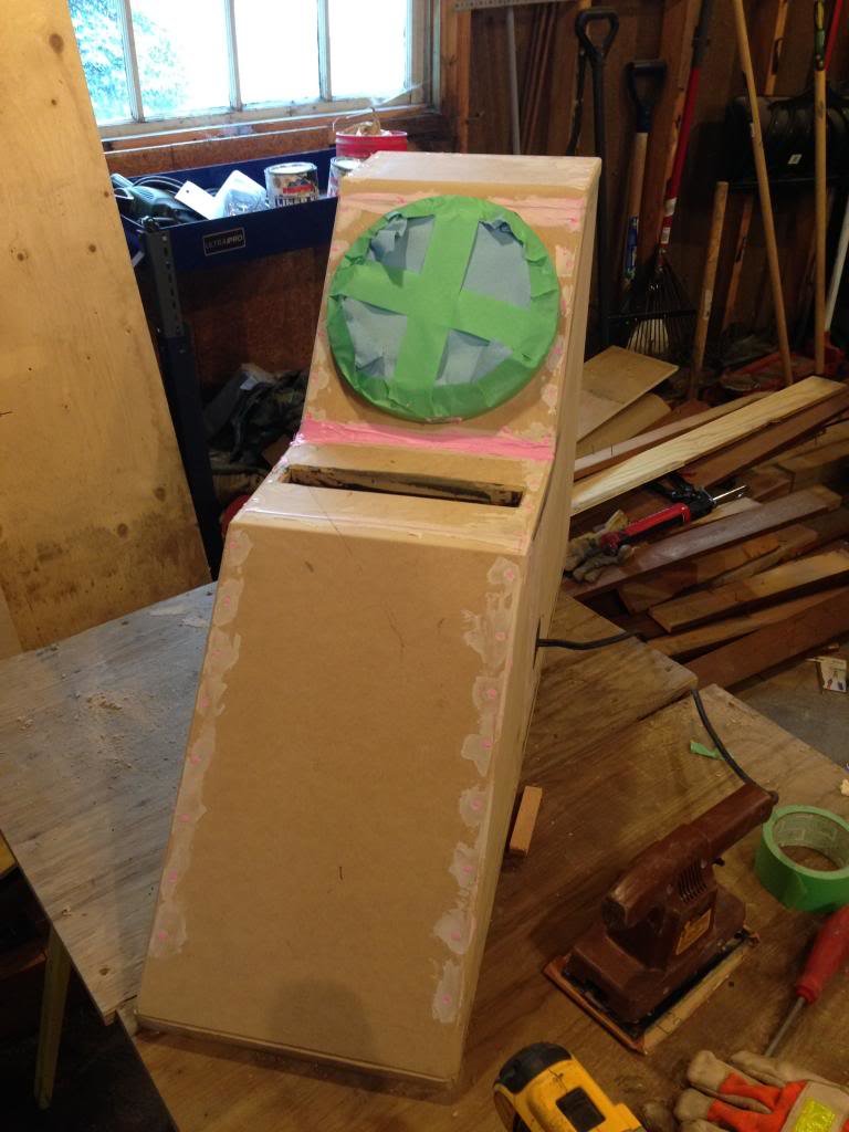

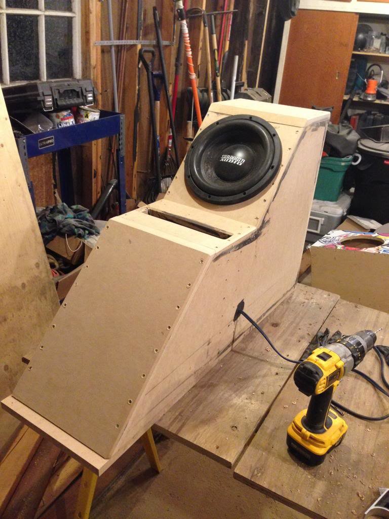

    Back to the sub box, got it framed up
    Port in
    Finished!
    Now I filled in all the screw holes, and cleaned up the corners with some filler.
    Once that dried, i sanded it all down and bedlined it
    Fits in perfect, and sounds amazing. I love the look of it, finally have a function interior again!

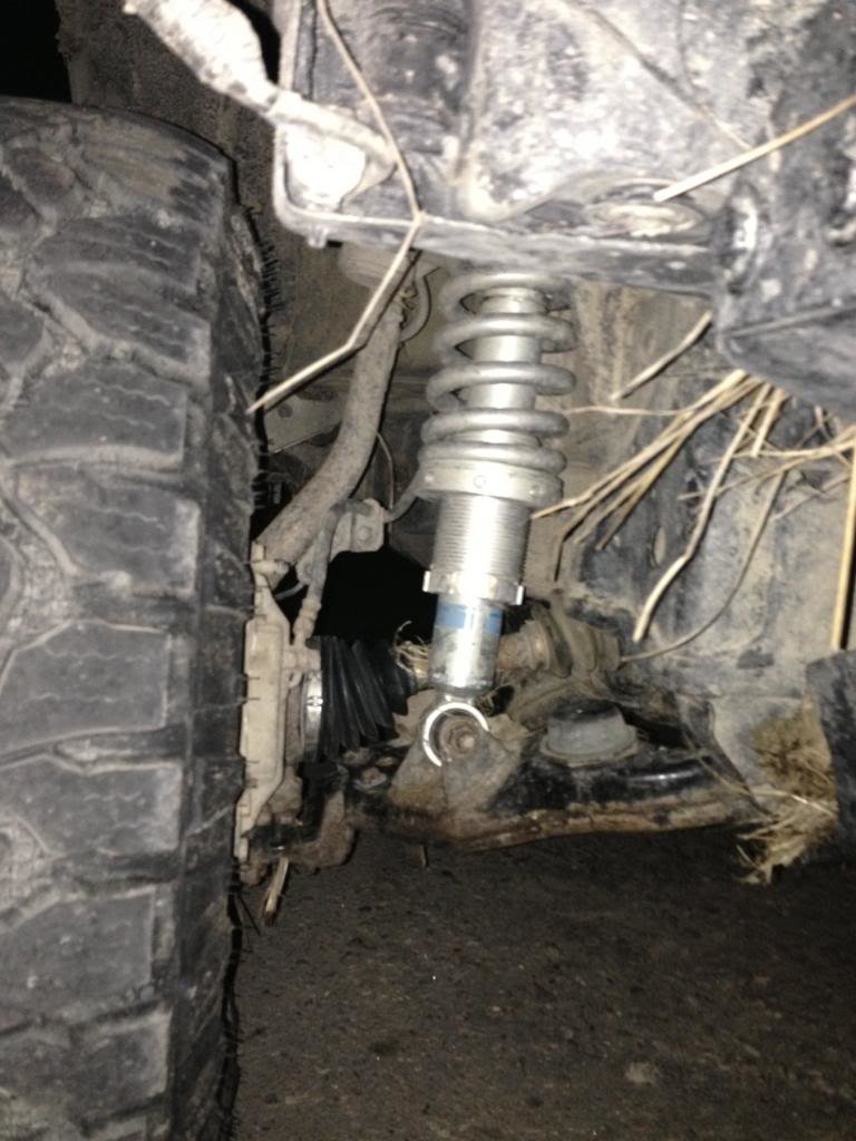

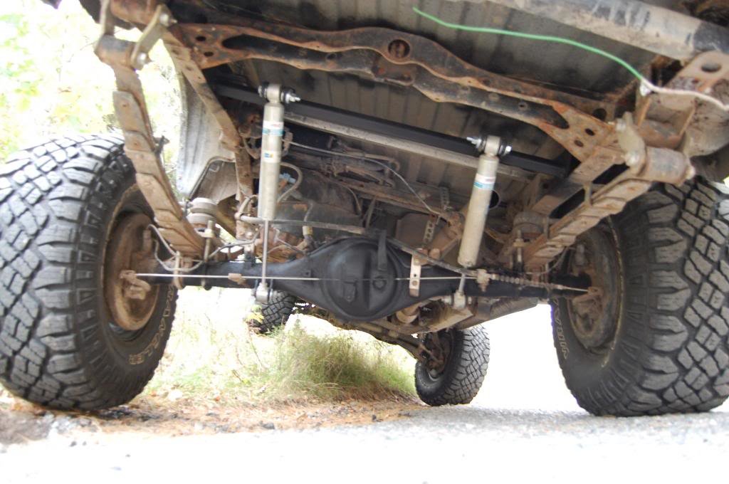

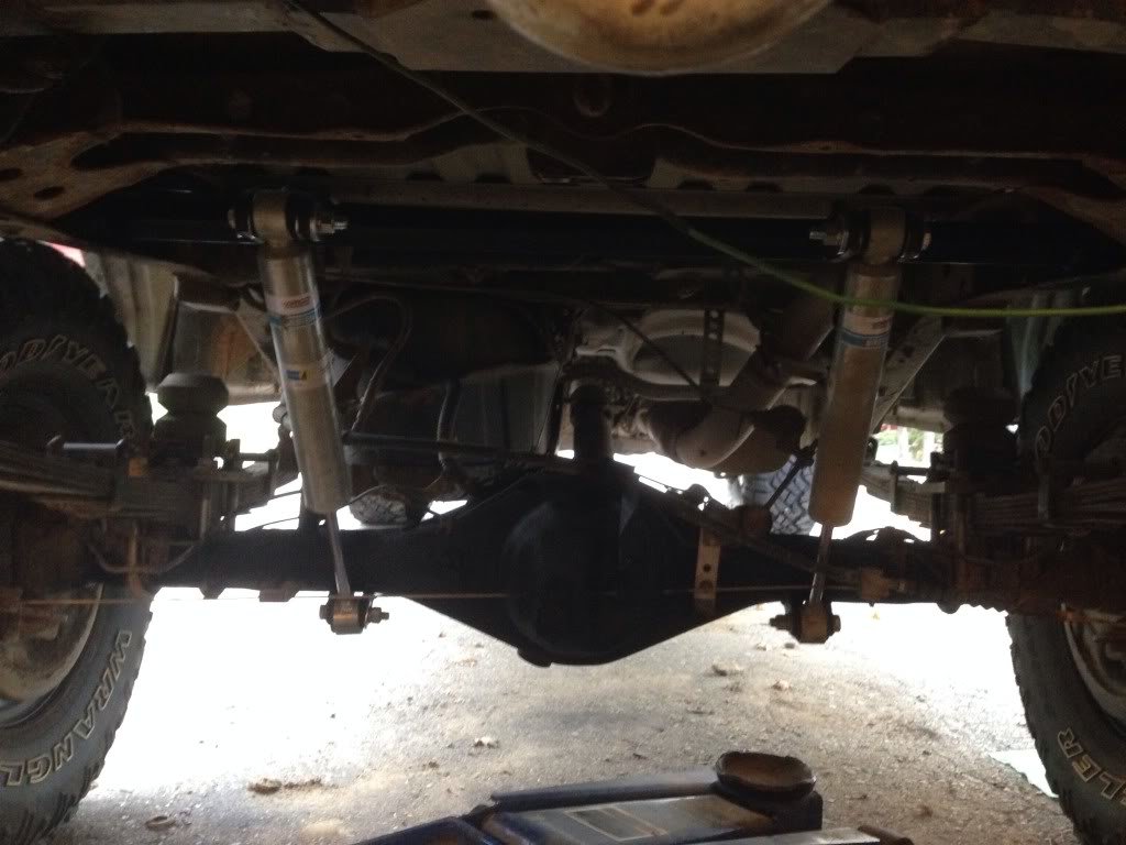

    Re-located my rear shocks today, made the ride so much smoother, and way more articulation in the rear, also added the trail spikes to my bumper, and painted my corner lights black instead of chrome!
    414DDB25-ABA8-4AC0-AC83-55CB2C064EEF-216_c33430f6eb81b5c405376dbd53667a3287950607.jpg
    1EB3AE56-D649-4A4E-BF3E-07A5E2758765-216_f105f92af25c5312cb89b8b9e9d79c9e89766a3d.jpg
