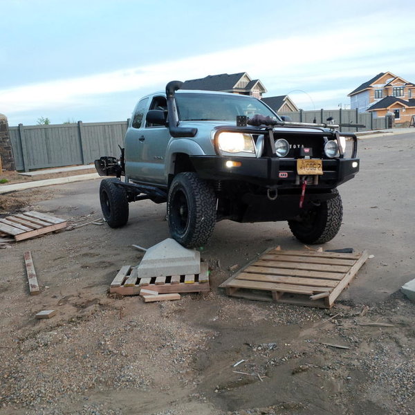

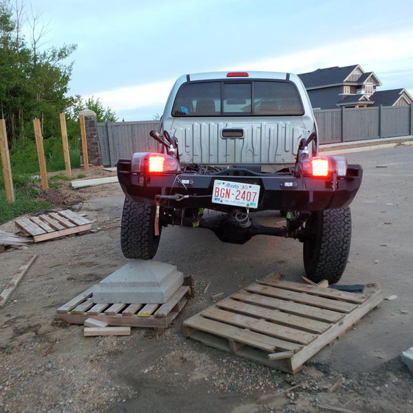

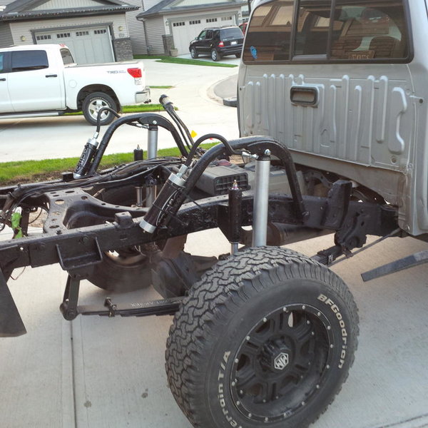

    Done and done. Minus a few little things I need to take care of such as axle straps, winch wiring and OBA relocation.
    Some not so responsible flexing in my neighborhood.

    All in all a good build. I hope to never have to do again. Haha
    The hoops fit so nicely in the fender wells I couldn't believe it. But of course because I mounted the reservoirs on the outside of the hoop I had to clear the box. This was done with a less than nice 9"x12" hole on either side of the box.

  4. Jun 18, 2014 at 10:48 PM
    #44
    BradyT88
    BradyT88 Well-Known Member
    Nov 3, 2011
    #66419
    36,722
    Lets see the holes in the bed :D
    Did you really get 2.5" bumps or 2.0's? 2.5's are huge. 2.0's are plenty of bump for our rigs.

    he wouldnt even of needed holes in the bed if he would have test fitted his resi's before he bolted them on lol

    2.0s. For the bumps.
    Yeah I had the box over a my parents place. As soon as I extended the hoops I figured I wasn't gonna be having wheel wells so the thought never occurred to me. :p

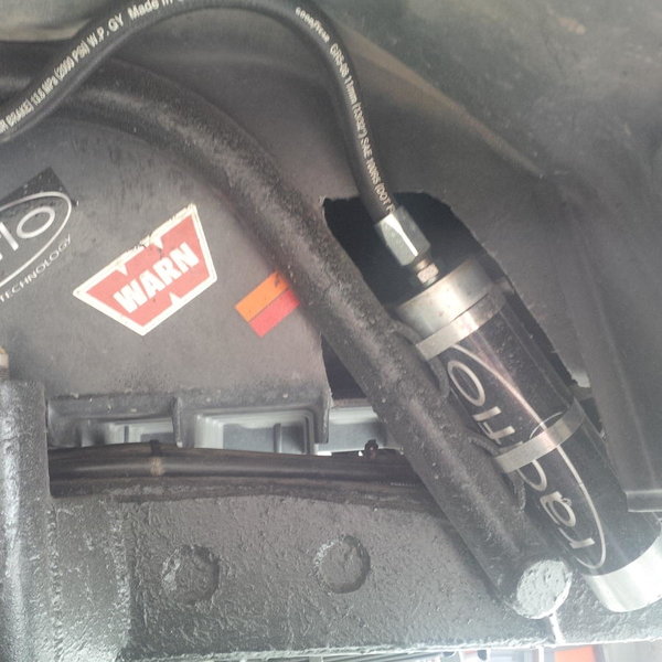

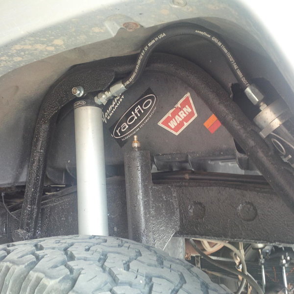

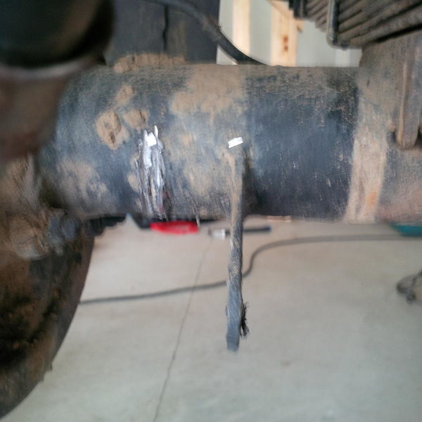

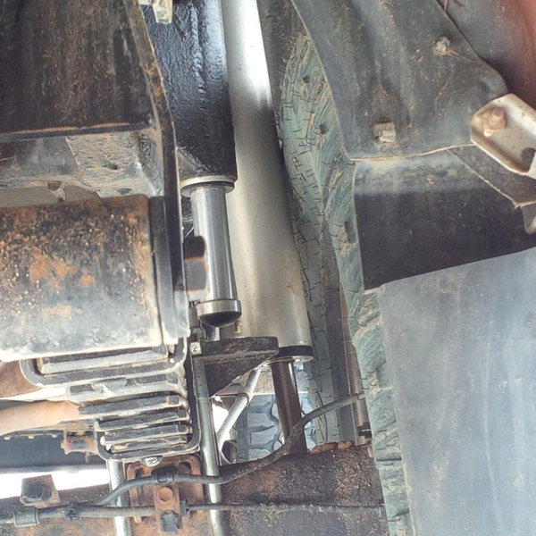

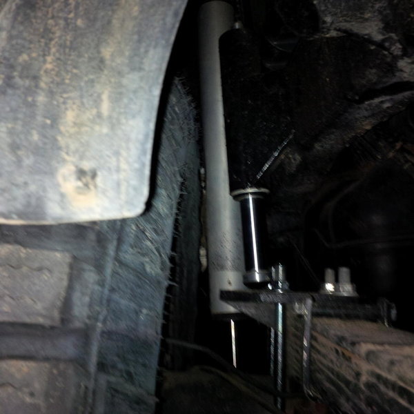

    Noticed some rubbing on the shock from the new 35s.
    Took a further look and found this.
    Had to cut and relocate the lower shock mounts in a little further. This gave me a little extra space but I may look invest in some new wheels that'll give me a little more space.

    Gave me a little more space. She will get really tight at full bump though.

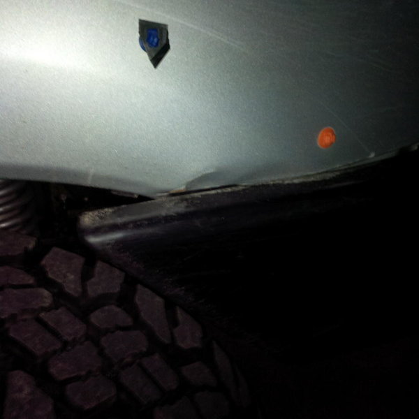

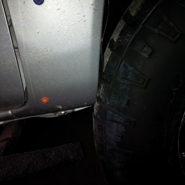

    Well.... more trimming lol
    Found this while test flexing.
    Guess the bumper is hitting the fender while flexing. A little adjustment should fix that.

    God damn tire hitting the shocks.
    More cutting and welding.

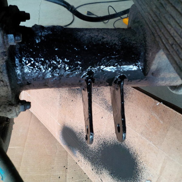

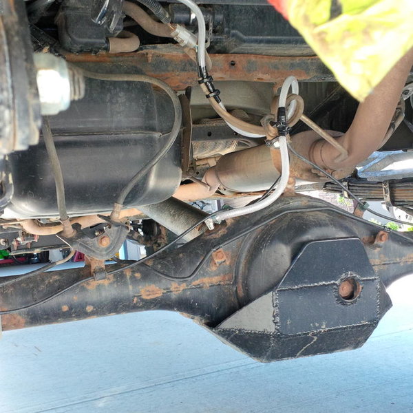

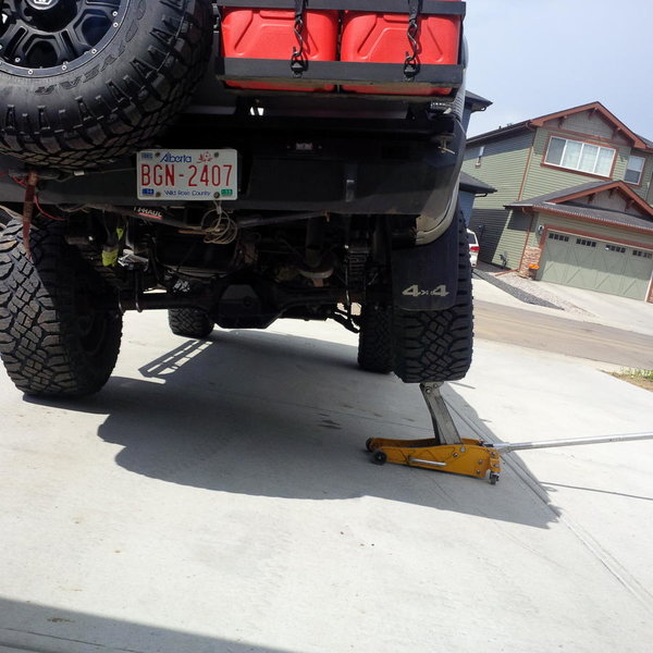

    Rear diff breather relocate.
    Slashaar likes this.

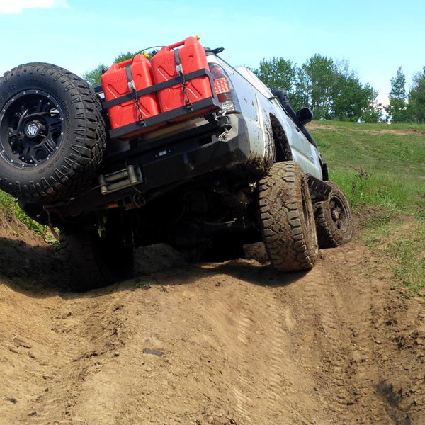

    Flexy flex.
    35s still hit the shocks.

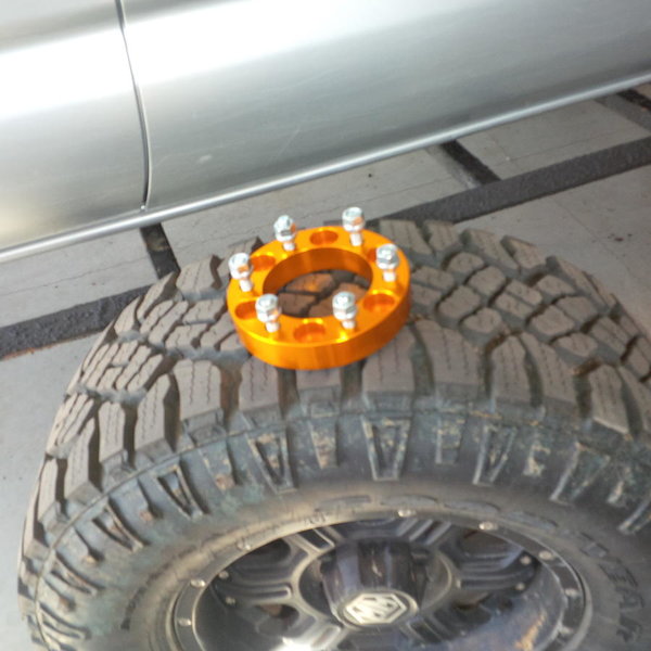

    Against my better judgment I have gone with some spacers. This should help with the rubbing.

    I don't think there is anybody out there running their oversized shocks outboard of the frame with 12.50 tires that isn't running spacers. If they are then the don't wheel...
