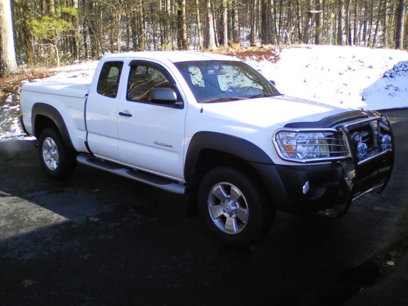

    nice attitude dude, i think a lot of people are trying to help you, a pic of your truck can tell us a world of difference on whether or not your truck came with fogs or not, is your bumper black (assuming your truck is not black)?
    u talked about the whole set up being wired on the inside to the battery, if you disconnect the wire to the battery (not the entire car battery positive terminal) does your "aftermarket" lights on the push bar still light up, if they don't that's probably for them, and not your "factory" fogs, which may or may not be factory, and could or could not have been ever wired

    This is a Legit thread man Im not some Idiot posting to get my thread count up.:rolleyes: I havent looked Behind the blank switch covers yet to see if theres any plugs there.The front foglights are factory its plain to see that and the factory Wiring goes right to the lights.I havent followed the wiring from the foglights into the truck yet.I will take some pix of the interior switchpanel,foglights and you can see for yourself.Will post them later.

    So I guess this shows Im no "Troll":rolleyes: The pics i posted shows the aftermarket wiring going to the foglights on the Bushbar.These wires go directly to the aftermarket switch on the fake switchpanel.The one pic shows the factory wiring going strait to the backside of the factory foglights.

    Okay, based on the pics, your truck did not come with fogs from the factory (someone correct me if wrong). They would have been added afterwards, someone may have been in the process of adding them when they sold the truck. You may have OEM lights/wiring, but they did not come from the factory there. Again correct me if wrong, they do not come on the base model, only PreRunner and up (TRD OffRoad/SPORT, etc.)

    The factory switch would be in the blank spots above the mirror adjuster in this pic (far left). On the black part of the dash, check those blanks to see what may be behind them.

    Yup, your truck did not come with fogs from the factory. If it is a V6 it may be pre wired for it (There may be a fog light switch harness behind the top left blank), if it is a 4cyl you will have to wire it up from scratch.

    i agree, they don't seem to be factory fogs, or I guess they could technically be oem fogs, but they were added on after because it is the base model (NOT SR5), not because it's not a prerunner or 4x4 (he's got 6 lugs)

    Holy wiring shit show Batman! What else is wired up in there? I see 2 in-line fuses and a white and red wire both going to the positive side of the battery. It looks like he may have been trying to wire up the fog lights himself.

    Thanks for all the replies guys Looks like I may just have to buy a Factory Switch and put the Foglight relay back in the fuesbox and go from there.If this truck didnt come with the Fogs from the factory then someone sure made them look like they came that way.
    Took the top 3 blank switchpanels out (above the mirror adjuster switch) and the Far left blank had a 4 wire plug on it, the middle plug there was no wiring behind it and the Right plug has a 5 wire plug behind it.

    the far left plug is your fog light wiring. all you should have to buy is a switch,

    that switch is around $50. who ever put them in probably didn't want to pay that much for the switch and just put the lights in for looks
