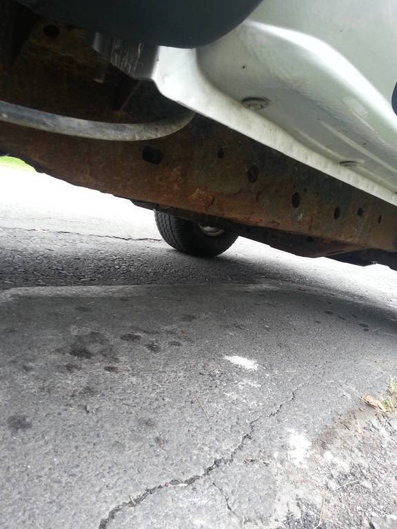

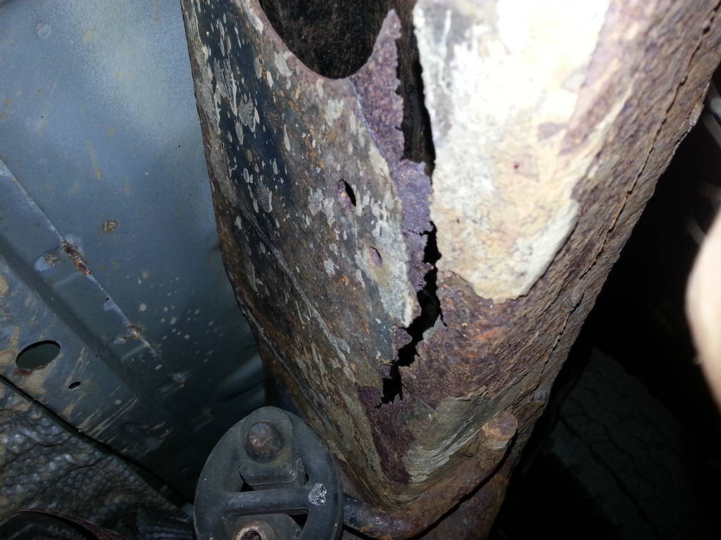

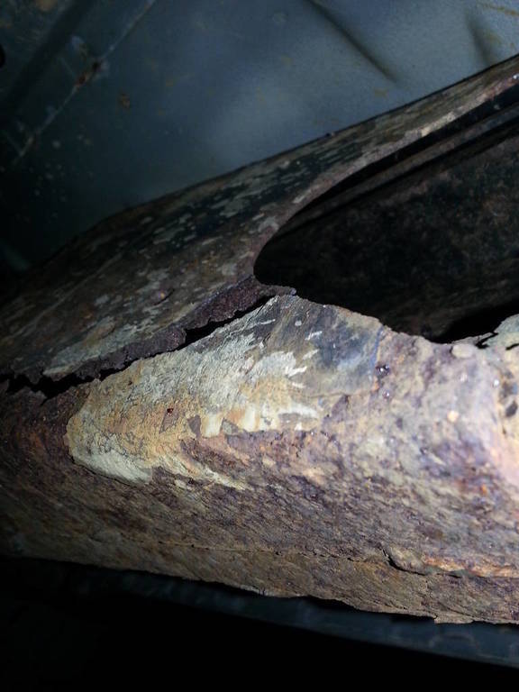

    Took my super clean well running 06 tacoma in to the dealer today to have clock spring replaced per recall... As I was there I figured I would have them do a Pa state inspection after a hour or so of waiting a woman from service approached me and said I have bad news for you... She said your frame is rotted severely and there is a huge split running parallel through the frame... The truck is unsafe and can't be inspected!!! I was shocked I knew it had surface rust looked nasty but not a rotted huge crack in it.. I asked what can I do she said its beyond repair and to call Toyota ... I did was told nothing they can or will do... I joined this forum because I saw the service campaign listed SC-EOD Where guys and gals were getting frames repaired or replaced if they lived and vehicle operated in said states where salt and severely cold weather ... Pa was on that list!! After reading about the campaign on here I called back only to have Toyota tell me my vin # dont apply ... I said I live and vehicle was operated in Pa its entire life... Pa is a listed state!! Said truck vin dont fit there criteria! ! They are sorry nothing they can and will do at this time... Im lost for words my truck is in nice shape well taken care of ... I dealt with a rusty looking frame but now my truck has to sit unsafe for the road! This is my only vehicle I have no money for a new vehicle I'm so upset ...
    Im new to this forum so if someone can tell me how to post pictures I will so others can see just how bad it is and see how Toyota treats its customers. . 7 to 8 year service life on a vehicle is not acceptable Toyota! !! Sorry for rant!!!

    Working on figuring out how to add photos. . Thanks for all the replies

    I uploaded pictures under 06 bad frame under Tacoma photos can't figure out how to get them here

    Dang, that MoFo is ugly. I hope you get it worked out so they replace it .

    Are u guys able to click on camera logo under my user name and see other pictures ??? Im not sure how to post them all ..

    Wild idea here. it's up to you but have a frame shop cut parts of the frame that has frame rot off and weld it with either a new C-channel section or box the frame back in. Like I said it's a wild idea and last resort. Worst case is it won't work. Plenty of classic muscle car shops do it for frame rot cars when they restore the car frames. Something to think about.

    Yeah I thought about that... But Im afraid if I make any alterations or work on frame I will never get satisfaction from Toyota if it ever does come up as a recall... At this point yes that does make sense but I'm in a tough spot here... Also like any other cancer weather it be on steel or in the body it spreads fast...
