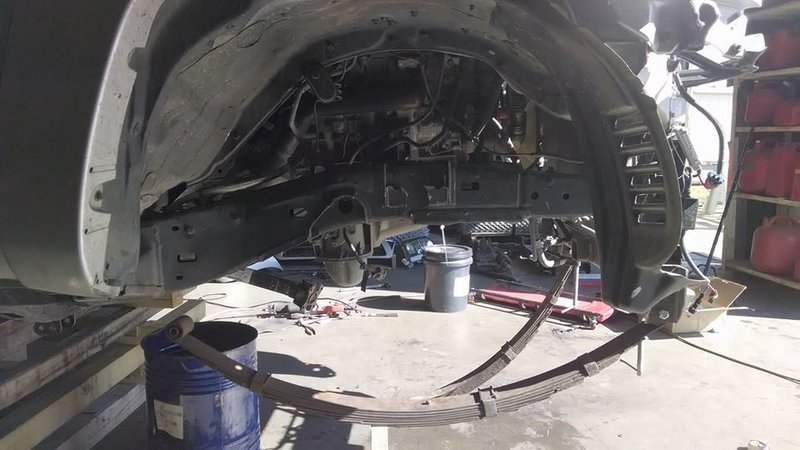

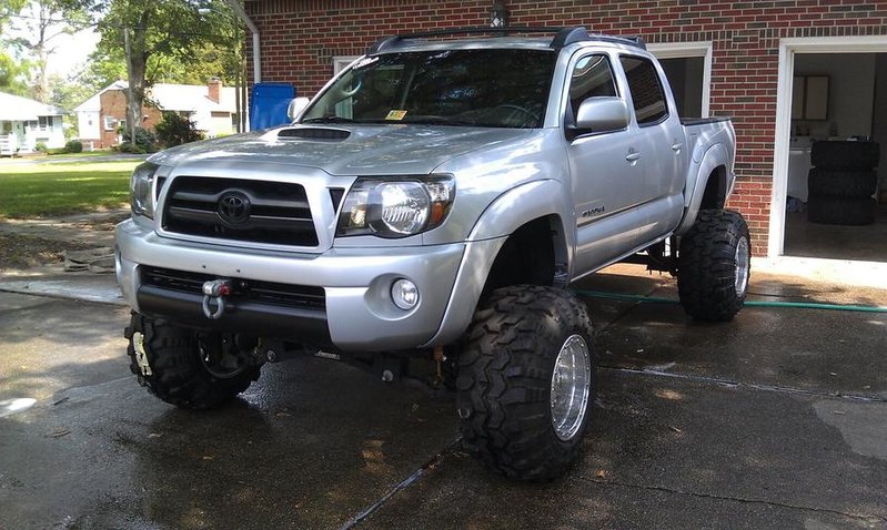

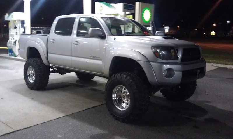

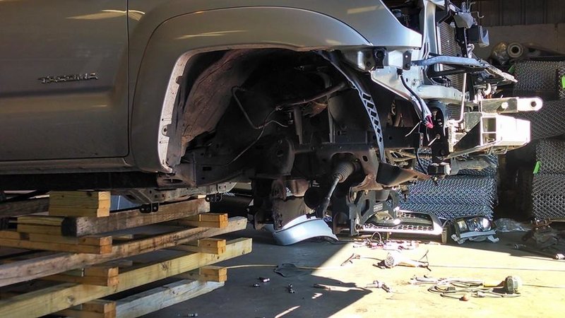

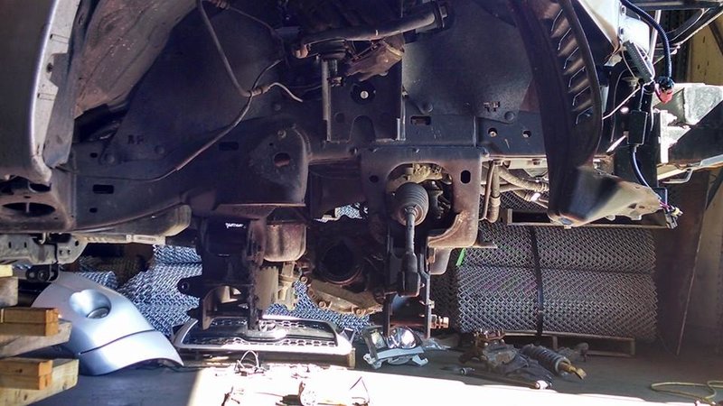

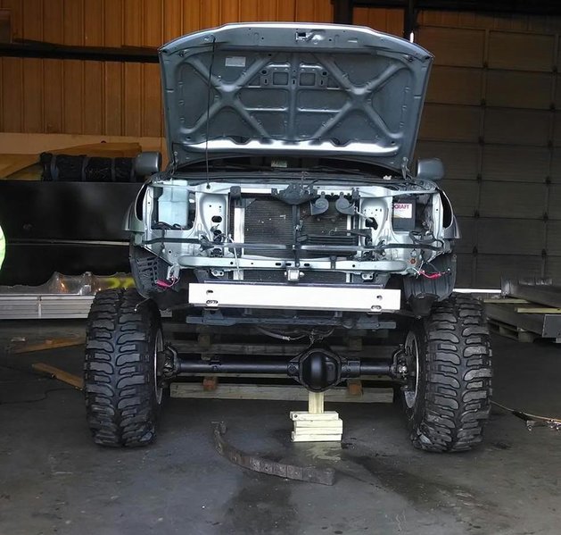

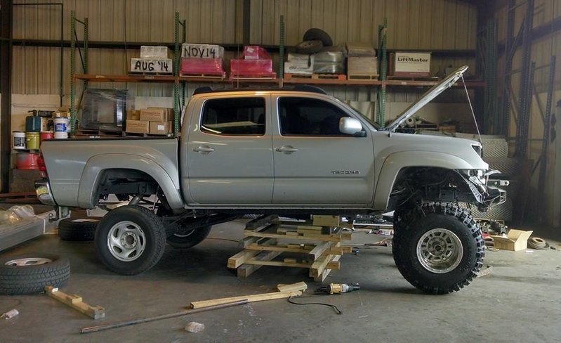

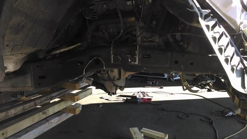

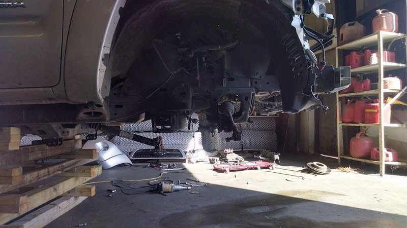

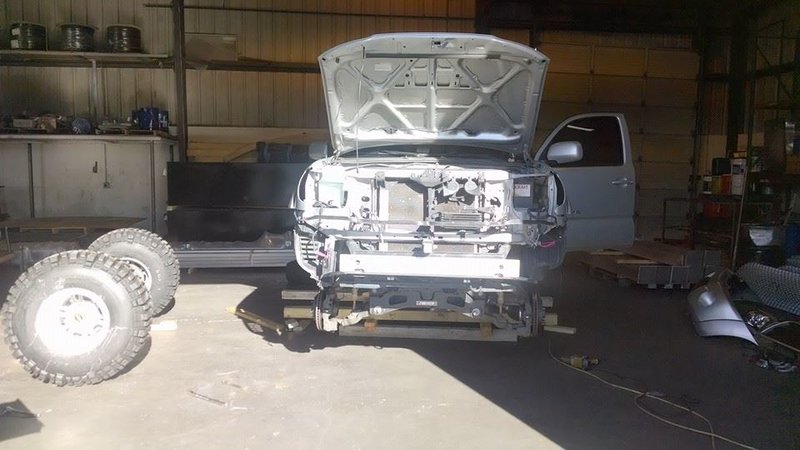

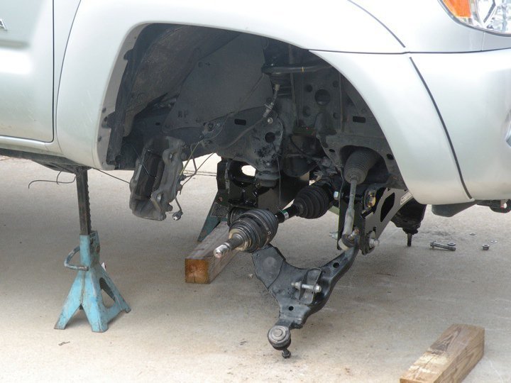

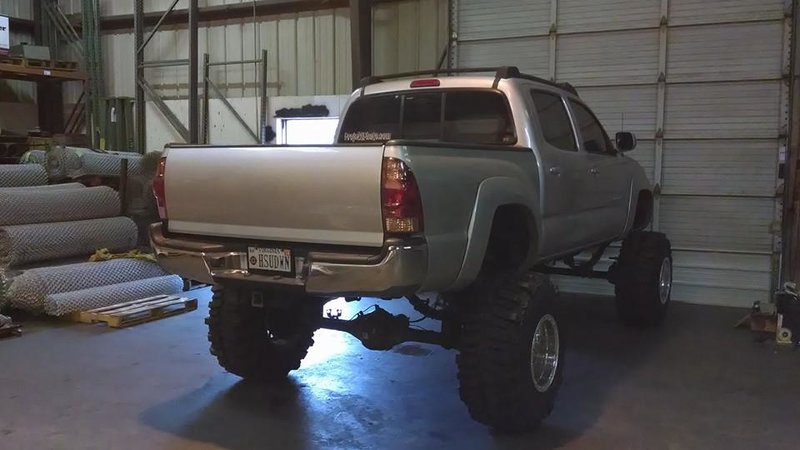

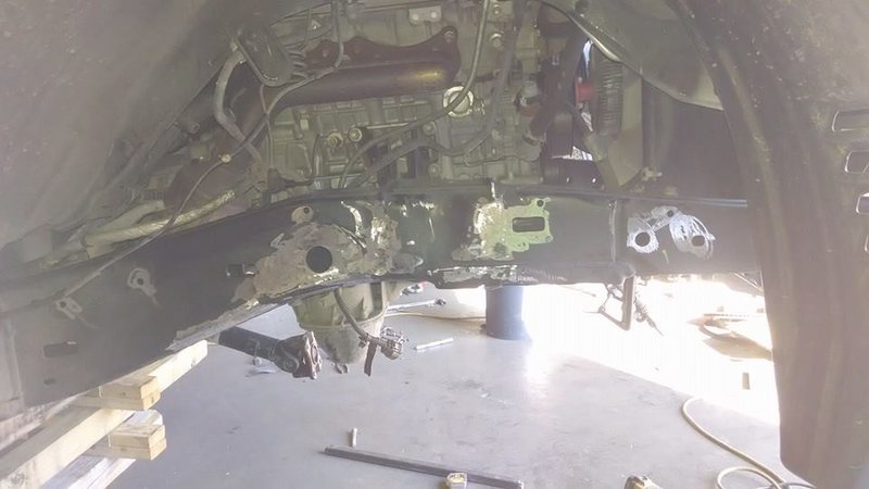

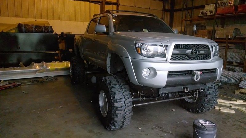

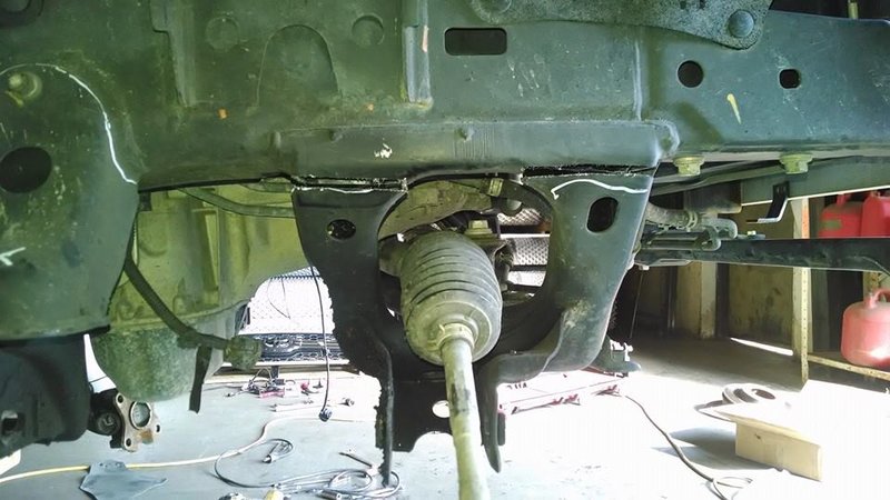

    Near completion pics, 4 days of actually working on it after grueling year of research, parts collection, and growing the balls to cut my truck up knowing that theres no going back

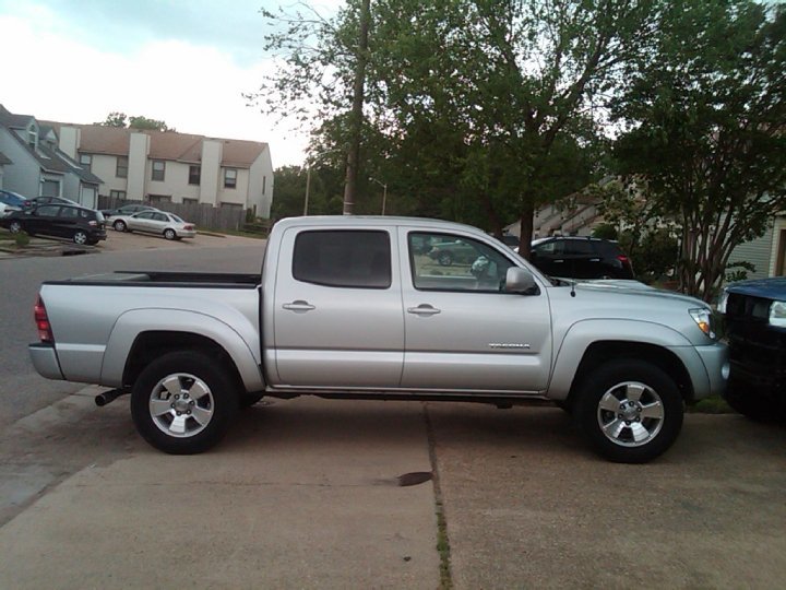

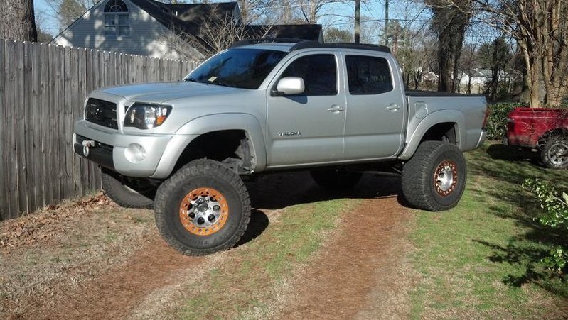

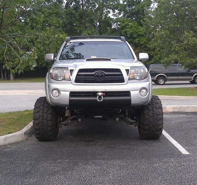

    Didn't really take many build pics but I can post at a later date, but I included some attachments and there are some pics of the changes my truck went through over the past 2.5 years
    Parts used:
    78 Ford F350 D44HD axle housing with 76 Chevy K-10 Outters to match lug pattern, hammered in solid axle yota studs, 4:88s ,Detroit locker and Warn Premium Hubs
    4" Wagoneer Lift springs up front
    High steer arm on passenger side for crossover steering

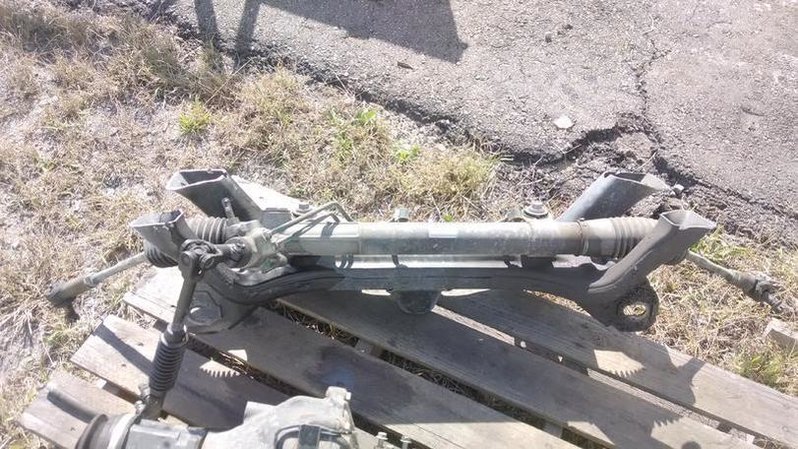

    Rebuilt Toyota IFS steering Box
    Borgeson Steering shaft and steering joints
    3rd member with a Detroit and 4:88s
    10" alcan springs w/3 inch block
    Custom spring and shackle hangers built by me
    3/16 plate for frame reinforcement
    16.5x14 Welds w/37 13.50 Boggers
    Pirtek made my brakelines and a local shaft shop is building my driveshafts
    So here are the results, and yes it will see mud

    Nice :thumbsup:. I know its a newb question but what exwctly is (High steer arm on passenger side for crossover steering)? I've seen that a lot on the magazines ofr other builds but never understood it.

    Crossover steering relocates the steering arm to the other end of the axle, instead of the side it was placed on in a factory set up, or where the steering box resides. It works better when you have or expect more travel from your suspension. If you keep the steering arm on the factory side, then you'll often experience bind as you're turning and the axle is cycling. That's due to the fact that there is really on so much curvature you can put into a steering arm and have it function correctly. In a stock configuration, with stiffer more limited axle travel, it's usually not a problem. It starts to effect steering, depending on the vehicle manufacturer, the higher the lift and more the travel. On a stiff GM solid axle truck, people usually notice a reduction in steering to one side at about 4" and above.
    As for hi-steer, it usually means they have also relocated the tie rod up above the axle, instead of in front of the axle. Since I don't see that on this truck, I suspect OP is referring to the arm he used.

    Looks good. Any particular reason you went with leaf springs vs. linking it?
    Also '79 F350 was a D60. F150 and F250 were D44's.
