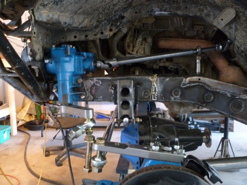

    Nice truck man awsome build. Can you post more pics of the steering shaft?

    Here's how I ran mine when I did my SAS...I believe the OP did his similar. He used the same joints as me for sure.

    The hanger is 100% built from scratch by yours truly
    I'd like to, I'm just not sure my center of gravity is trail friendly
    NwiTACO is correct, I Used the same joints as my inspiration, the only difference is that my steering box is not quite as far forward on the frame. He was extremely helpful with all of my questions
