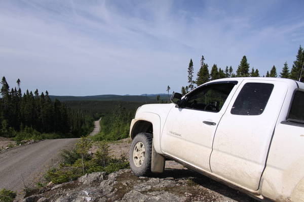

    The gravel roads I travel on range from 45-50mph posted speed limit (F-1) to "must be navigable by a two wheel drive pickup in the Summer dry season" (F-4).
    I don't actively seek out mud holes, and if I get stuck, it certainly isn't on purpose. If there's no snow on the ground, I don't engage 4x4 more than a handful of times in a year.
    I will admit to having a bit of a heavy foot, but not heavy enough that I can pull 20+ mpg running load range "E" tires...
    Typical road:
    In the wetter season:
    At the dead end of an F-4 road:
    At the end of an F-4 road, that was just freshly built last week:
    All those roads have 22 wheelers trucking logs off them, so they're a bit rough, but no one would call them extreme...
