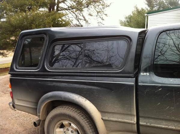

    I'm not sure this is the best place to post this, but nowhere really seemed to fit, so here goes.
    I want to add some sort of a roof rack to my topper. I camp a lot and want to rig up some sort of solar shower up there, letting gravity pull the water down. I have some ideas but could use some input on how to rig this up.
    I could use a fairly standard roof rack and basket with, say, a 5 gallon water can up there (painted black). A nozzle would be easy enough to add. An idea I like a little better is to mount a (several feet long) piece of 6" or so black PVC pipe on the topper, running the length of the roof. Again, some sort of nozzle and hose rigged up. I think this would look a little better, and hold enough water. I think in either case, I'd have to find some sort of rails to mount on the roof, which is where I hit a wall and have two problems.
    First off, I'm not going to be keeping this topper forever. It fits just ok (check the pic) and doesn't quite match. So, if a better one comes along I'm ditching. (If you're wondering, I bought it because is was cheeeeeeeaaaappp). Therefor, I don't want to spend much money on the rack/mounting. Is there a simple way to make this work? Maybe a rack from a junkyard SUV? I don't want to drop the bucks for a Yakima or a Thule set up.
    The second problem I have is, the roof of the topper slopes (a big advantage when sleeping in the back - a disadvantage for mounting rails on the roof). Anyone know a way to get around that without having the rack way up in the air? Maybe a really short set of rails just on the flatter (middle) part? Maybe mount the PVC pipe running the width of the topper instead, right behind the cab?
    Anyway, I'm going to try and attach a pic. I'd love to hear some feedback or other ideas for how I can make this work. It would certainly make camping a little less smelly, haha.

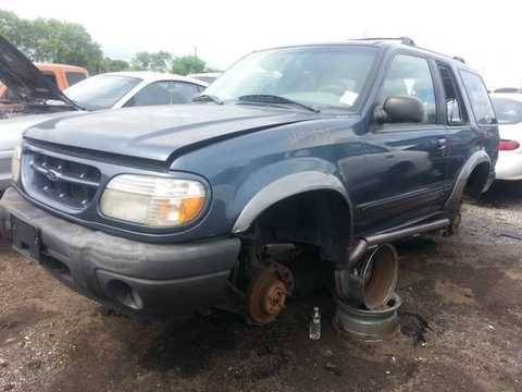

    So, this isn't the actual Explorer I robbed parts from, but virtually identical:

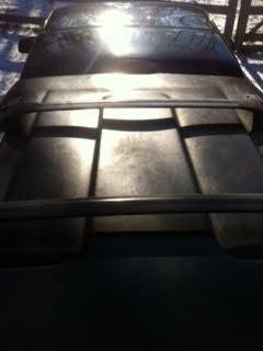

    After hacksawing down the roof rails, some careful measuring and some more careful drilling, I bolted it down to my topper:

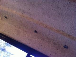

    I sealed everywhere I could think to seal with silicone, then put big rubber washers and fender washers on the inside (and I think, er, hope, it's enough support... ). Here's a shot from the tailgate:
    And from the inside:

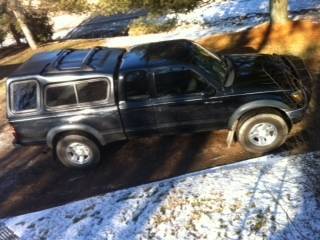

    Couple more pics. I was hoping the Subaru rack would work out because it would have spanned almost the whole topper, but I don't think the shorter rack will be any less useful. Best of all, I like how with the step on the roof of the topper, it makes a pretty low-profile rack:
    Here's a shot of the truck over all:
    Well, tell me what you think folks.
