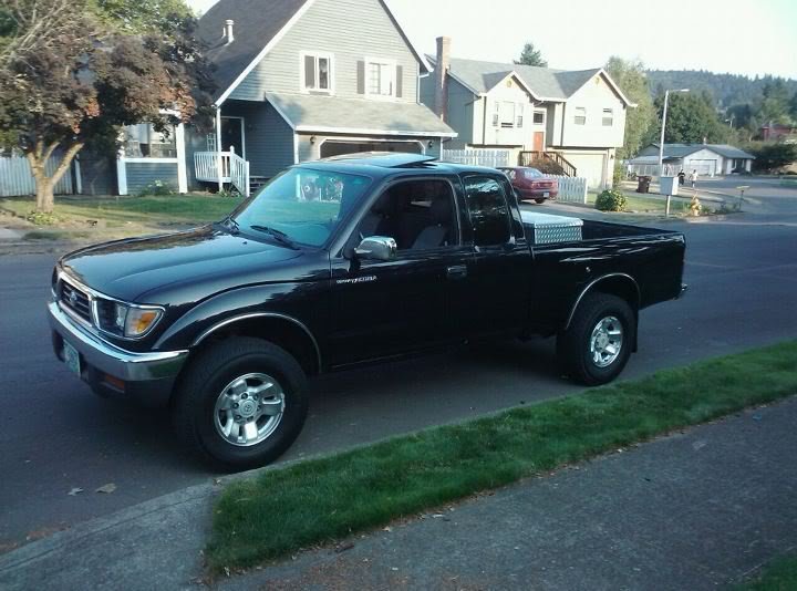

    1996 SR5 Tacoma. 33x10.5 Kevlar 3in lift
    I know this isnt the right place for a build but thought id share it anyways

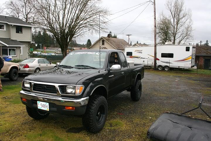

    This is how she sits now!
    And how it was when i got it..
    This Is my 1996 Yota Taco! This was my first truck i got as a Senior in High School. I bought it from a friend who went to the marines. I was always into trucks but didnt kno much about em or motors. I was looking at Rangers but Found the YOTA was for sale one day. Never thought id own it because of the milage. (256K as of now). Ive put alot of miles on and she runs like a champ:D But called up my buddy right as he got back from Basic Training. My dad signed the check and its now ours. My parents always told me i was buying my own but really they did that so id get a job..
    5 speed 3.4L SR5.
    My buddys to the bottom right.

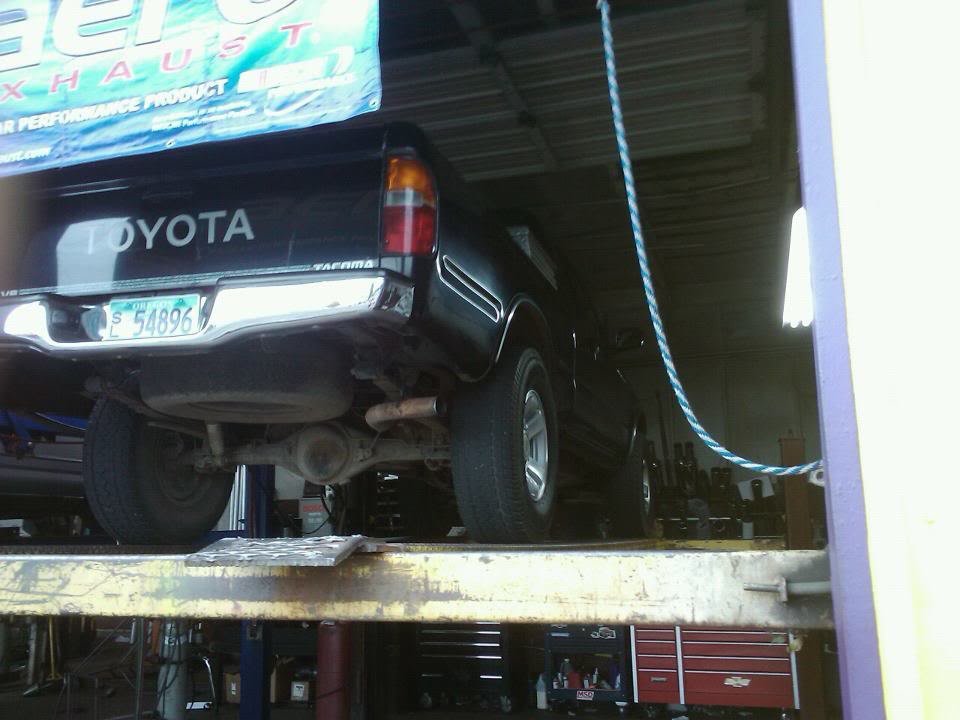

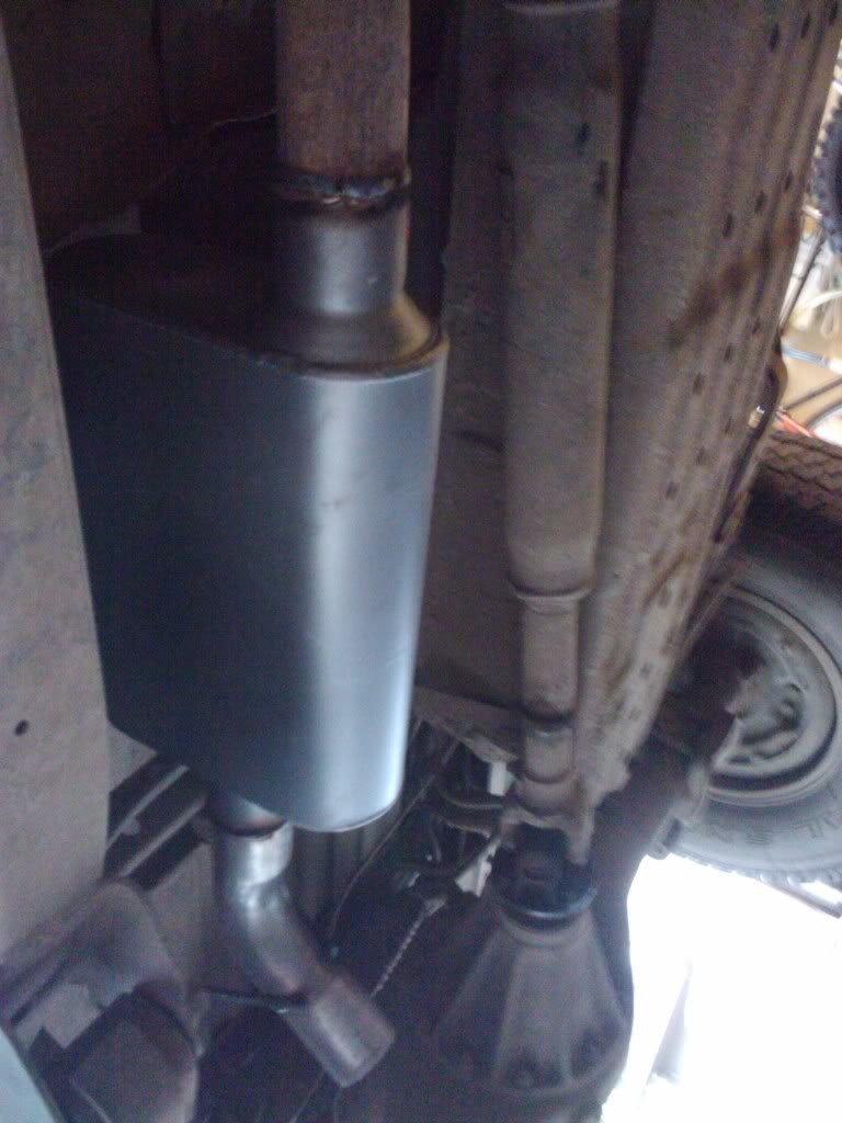

    I started out doing small things. First of all i had to get rid of the trash can underneath it and get a flowmaster:D
    Threw in the turn down pipe to get rid of the nasty pipe out the back

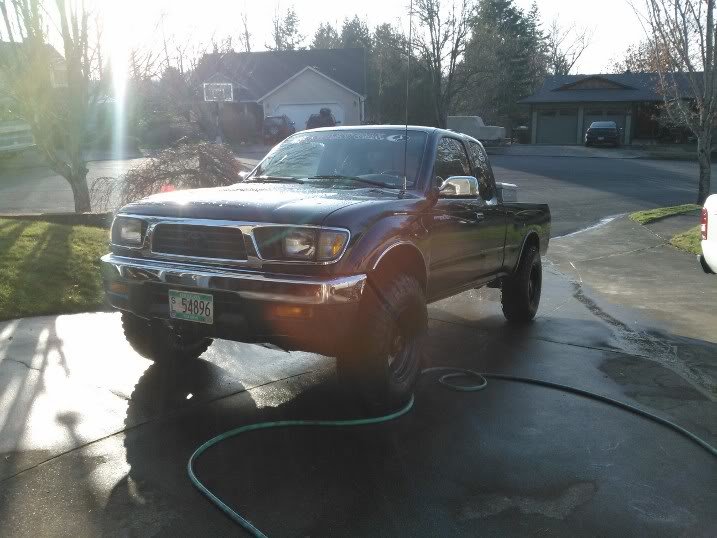

    Next was the wheels. I looked into painting the rims but never was a fan of painting. So for how cheap they are i bought some Steelies and 31in BFG's

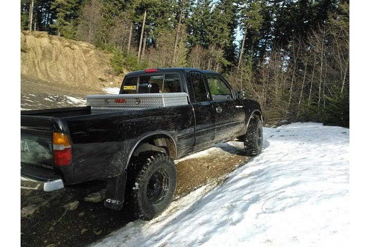

    I dont do any mudding but am always up playing in the snow. And they handle like a champ!!

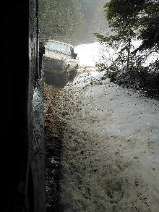

    Thats me and my buddy up snow wheeling. Hes got a 82 1st gen. Solid Axle kids ;)

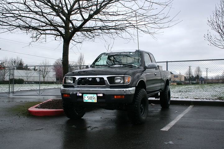

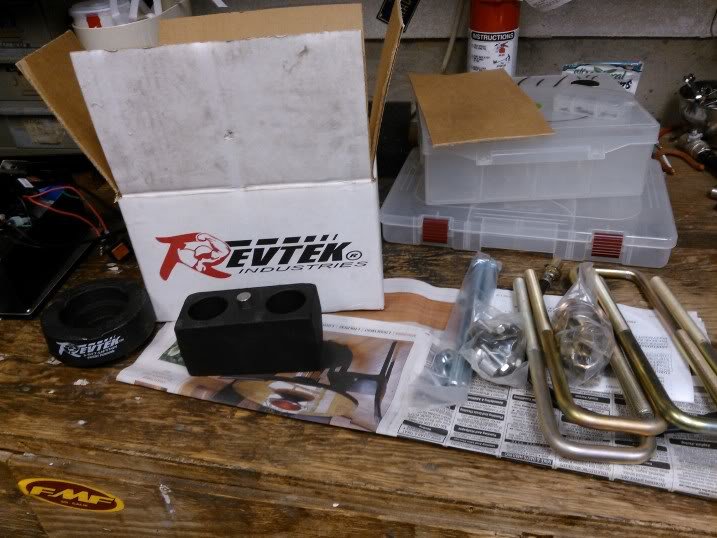

    Went with the Revtek 3in block lift. Thought about the AAL and springs but decided not to after i got such a great deal on this. Never took any pictures but me and my dad put it on in half a day. Hardst part was the IFS and springs....
    Rides waaaayyyyy better and gave it that look i was going for. Instead of the AAL i just went with the blocks and Ranchos in the rear. Rides clean and have had no problems with them yet!
    Coming home from A buddys house someone pulled out infront of me Totaling my baby:mad:
    I dont have pictures of it now and may have some. It was either get rid of her and get a Highboy or keep it. I decided to keep it and am really happy i did. The bumper is new along with the grill and lights. Took 2 Months but it was nice to have Meadow Mouse back
    More pictures to come but for now! Here she is

    Good looking truck man. But I am curious to as how blocks and spacers make it ride better when that is literally impossible :confused:
    If you ever plan on wheeling seriously get rid of the spacers and blocks...spacers on IFS can cause serious damage if wheeled on too hard (and it takes less abuse that you would think)

    I don't wheel at all.... So that's out of the picture. It stiffened up the suspension making it less easy to bottom out. Riding better for me

    gotcha. Your springs must be pretty worn then. fwiw...eventually the spacers will make the coils wear even more and your bottoming problem will come back.
    Its always best to do a lift the right way the first time. :)
