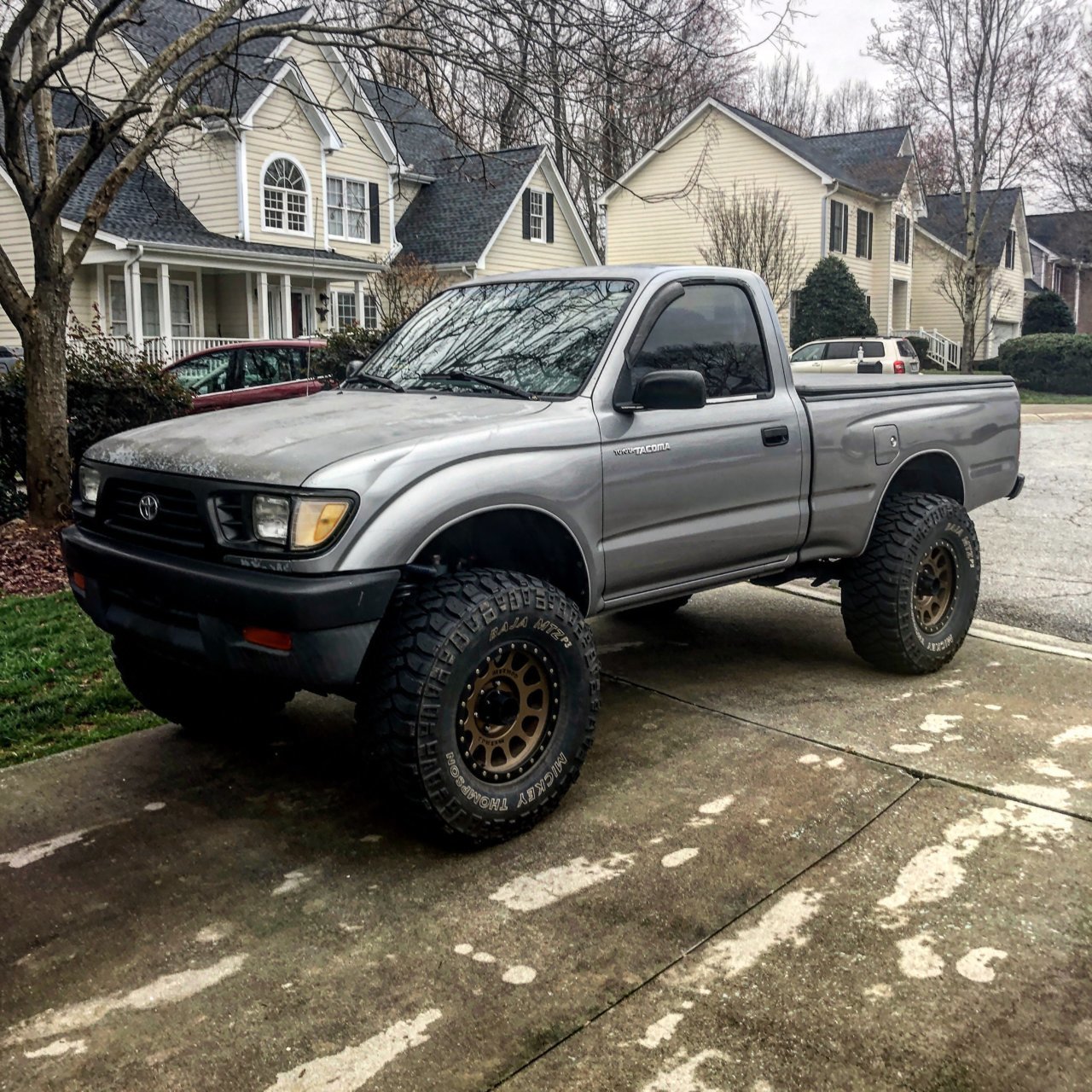

    A couple of weeks ago I picked up a 1996 regular cab with 177k on the clock. Beautiful truck in my opinion though it does have some not so great paint spots I think it adds character. Healthy 3rz and 5 speed. The former owner built it up and parked it.
    last owner added:
    -total chaos UCAs
    - toytec boss coilers
    -method racing wheels(not sure what model)
    -mickey thompson 34s
    -rear add-a-leafs and boss shocks
    I come from owning a 2nd gen so this should be a fun build.

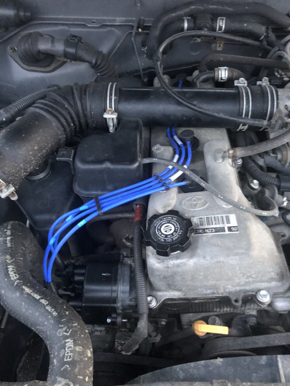

    First thing I ordered new plugs, wires and distributor cap/rotor.

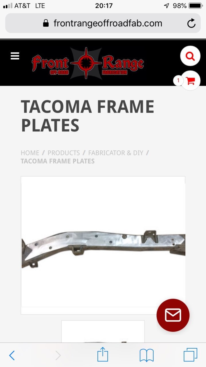

    The rear frame has some surface rust spots so I'll be doing some removal and hitting it with some steel-it. Also purchased some of these frame plates for the rear.
